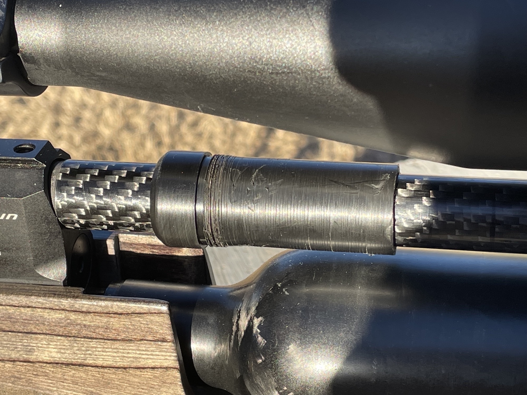

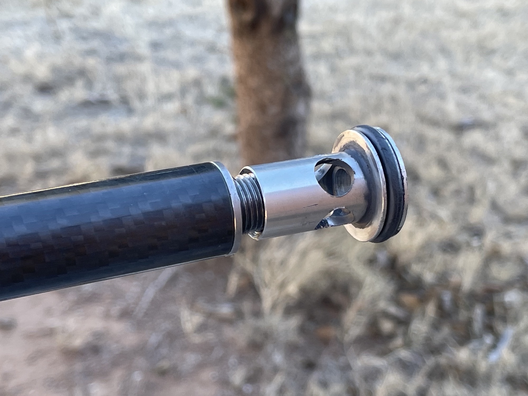

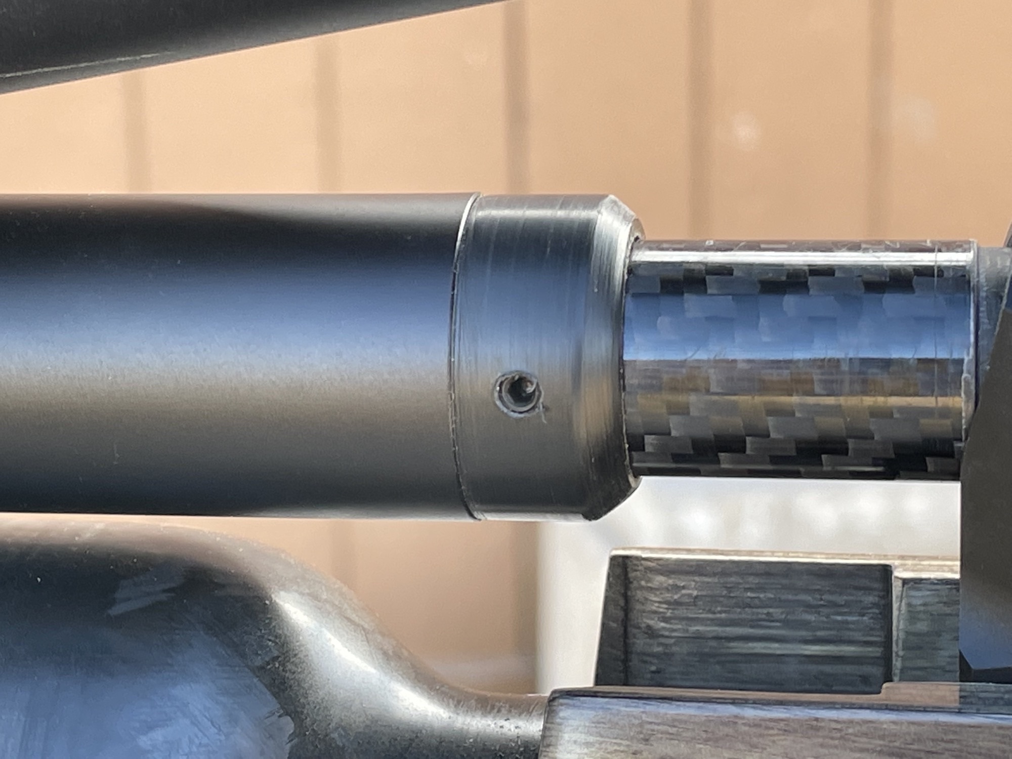

I finally put a carbon barrel tensioner on my FX Crown . Using some aluminium tube 14X16mm as a sleeve to adapt the 16X20mm carbon tube over the 14mm OD barrel. It sure increases stiffness and accuracy , that's the good point. But now the gun is not backyard friendly anymore ,...it's pretty loud even in .22 cal.
So would it be possible to put the shroud back around the carbon tube , in a way or another ? I'm back to my drawing board to find a solution , some machining will be needed , but I wonder if somebody else has already undertaken this project ? Unless noise is not a problem for you
