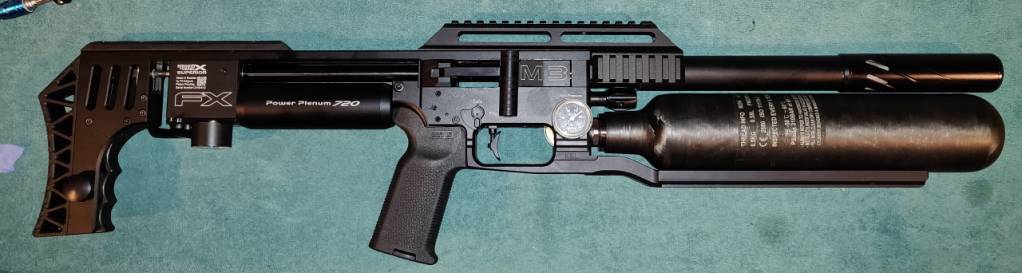

My FX Impact (Kinda) Compact 0.25...
My Impact was manufactured less than 3 months ago. I might dual 480 it, that should allow me to go with a bigger moderator?

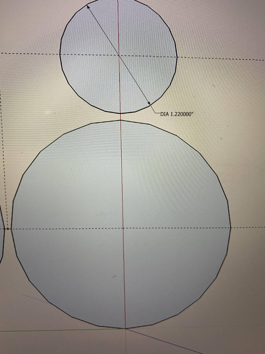

My curiosity got the best of me... so here are my findings:
With the 500mm barrel, and anything longer than the 300cc bottle, you will need a moderator 1.25” or less, anything larger will hit the bottle.
the top circle represents the DonnyFL Tanto at 1.22” diameter. the bottom circle is the 2.4” diameter bottle. With this configuration, there is 0.07” space between the bottle and silencer. The schematic is to scale.

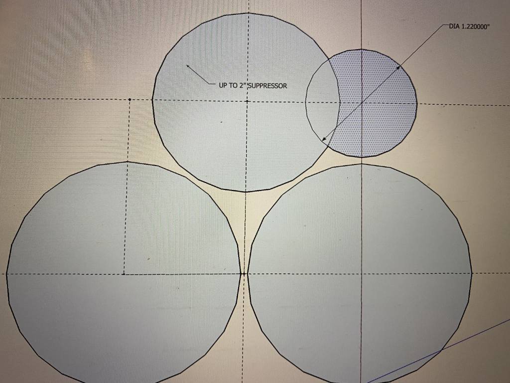

Scenario 2
Using a dual bottle adapter, and two 2.4” diameter bottles, would allow up to a 2” diameter suppressor, with plenty of clearance.
the pictures are CAD, and shows exact fitting.
with a dual bottle adapter, and a 2” DonnyFL Emperor you good to go!
Really sharp like that carbon wrap look. Can u tell any weight difference with the 300cc bottle vs 480? I have a Impact mk2 500 barrel & would love to make it lighter. its getting heavy for this 69 yr old to carry squirrel hunting.
Thank you . . . the wrapped parts (along with some others) are being cerakoted as we speak so I'll have a slightly different look in a week or two.
As for the bottles, the 300cc bottle with valve weighs 15.75oz and the 480cc comes in a t 1lb 5.25oz so you'll save about 5.5oz using the smaller bottle. I did appreciate the slightly lighter weight but it wasn't worth it having to fill the smaller bottle more often.

Will a fx donnyfl fit the 500mm barrel with a 580cc bottle?
No. The DonnFL FX mod is too wide. The only DonnyFL mods that will fit are the Koi and the Tanto.
Correct, you need a mod no larger than about 1.22" in diameter to clear the 480/580cc barrels on the compact. The donnyfl FX mod is 1.36" diameter.
