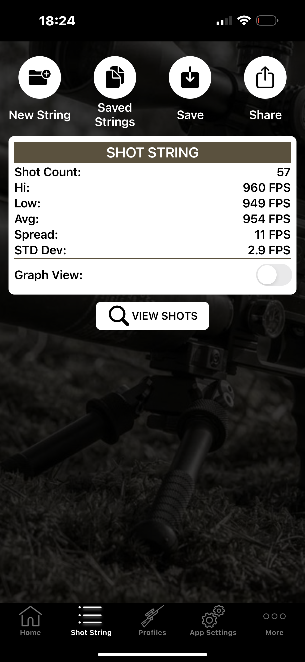

First put your valve adjustment screw at 4.5 lines. I would start at 1st regulator @ 160 second regulator and 2nd @ 140. Put your micro wheel on 2.5 and macro wheel on 16. Then use your chronograph to see the speeds at macro 16 and micro 2.5. youll see what the max speed is there. Then adjust to macro 12 and see if there is a significant impact to speed both positive or negative. I'll give you an example how I tuned my fx m3 .22 for h&N slugs.
I turned my valve adjustment to 4.5 1st regulator 145 second regulator 125. Macro 16 micro 2.5. I found my max speed to be around 1,012 consistently including wasting air. So I knew that I needed to reduce my speed to around 950 for lasers. I slowly adjusted the macro wheel down until i got a significant drop in range to around 930. I then used my micro to adjust up to around 3 or 3.25 and now I'm set at 950. I have a 60 shot string with a 3 fps standard deviation.
