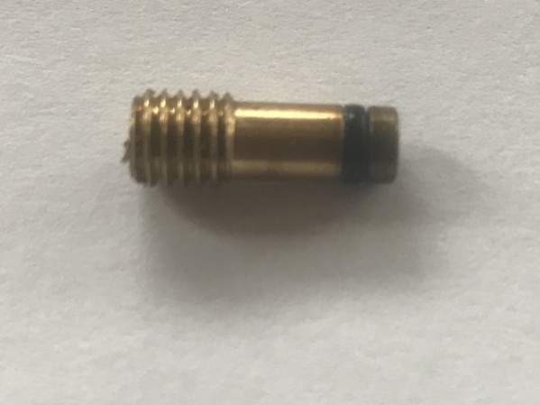

2.2x1 NBR70 oring. It fits around the brass bolt in there. It’s basically a plug.
Ah very nice! Thank you for the information!
I'm wondering where the puff of air is coming from then? Happens only when the gun is fired.
"AirSupply"My guess on a new gun like yours would be one of the oring on the barrel. They are easy to nick as you insert the barrel. When you fire the air can be pushed forward. I’d replace them and lube them up. Insert slowly twisting a little side to side.
I guess later I'll do the tissue test to try and find out where I feel the puffs of air coming from.
Thanks for the advice!

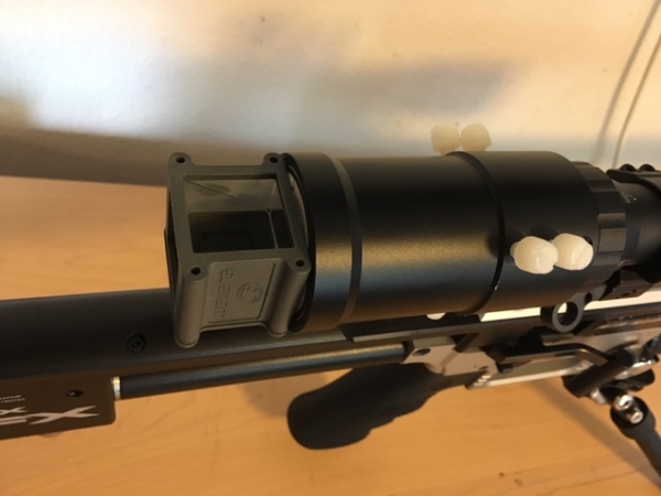

I'm working on a Prism type scope cam mount. (I couldn't see myself paying $200+ for the side shot) Phone videos don't seem to have very good clarity to make it worth the cost.

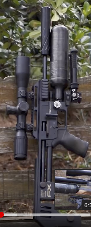

Here's a picture of the length of the 500mm barrel that Matt has:
1523737641_18317749525ad26429ef5e75.72470601_Screen Shot 2018-04-14 at 10.25.41 AM.png
My barrel goes almost to the end of the bottle.

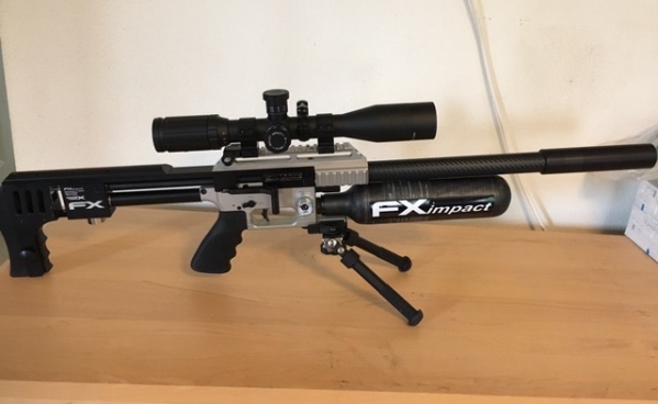

Few thing I've done or added to the gun.
Scope is SWFA 12x42 SS.
FX Decal on the bottle
Green Blob bipod. (3 washer/o-ring mod)
Anti cant scope level.
A picatinny rail QD sling mount.

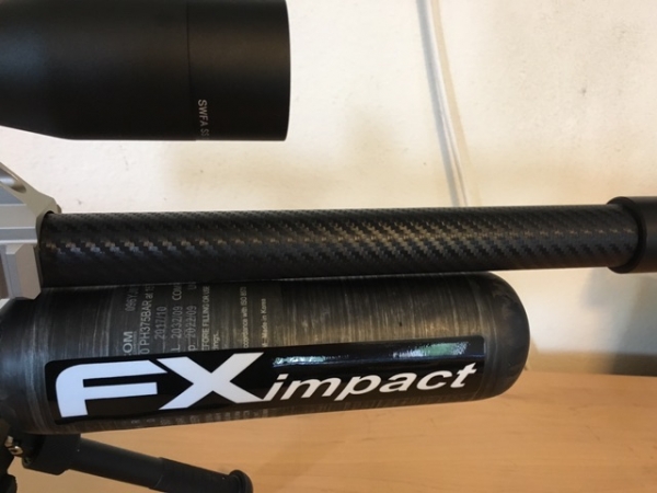

Carbon fiber wrap on the shroud:

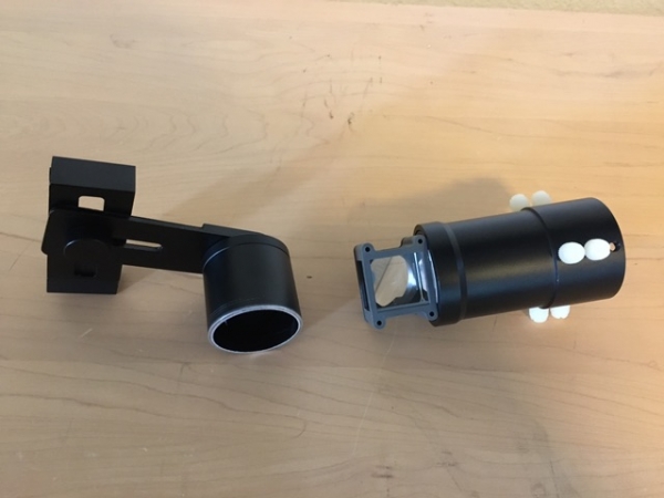

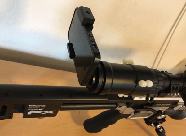

Now I'm building a Sports camera prism mount.
Got the universal camera mount from Ebay Cut the insert tube about 3/4" and made pvc shims to mount the prism. The scope mount can do both mount my phone or mount the Sports camera. With the sports camera it will work like a poor mans "Side Shot" where I can still shoot it like a regular scope.
I'm still waiting on my 4k sports camera to come in from Amazon.
But so far I've spent about $70 for this set up. Not bad considering that it can do both phone and Go Pro type of camera.
Well I let you guys know how it turns out!

"Barkley9"That is an awesome looking Impact! Did Utah Air Guns engrave their name on it, or is that a removable sticker or something??
It a sticker they put on it. (Nornally I'm the type to remove any dealers marking BS.) But I think it actually looks good! And I really don't mind supporting Utah Airguns, Great group of guys and gals there!
I'm thinking about removing the carbon fiber wrap. Makes it look different but it just doesn't seem to go with the rest of the gun. Or? May be I should wrap the tube in the stock also??

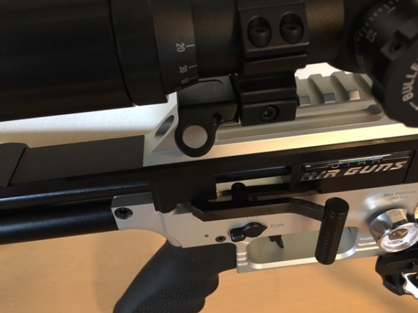

I've got a question?
There's a tiny hole above the left side of the grip that air puffs out when fired. Does anyone know what that hole is? (Just below the power wheel)
Also I noticed that this .22 looks like it has a 600mm barrel? If I'm not mistaken doesn't the .22 come with the 500mm barrel?
O.K. sorry I guess I actually had 2 questions. LOL!!
Could be airflow displaced by the movement of the hammer. I am currently Impact-less, so I can't verify it anymore :)

I'd be interested in your final setup with that camera mount. I'd much rather use my GoPro 5 in a Side-Shot configuration that my phone.
I'll make sure I update this post!
Just got notified from Amazon that my camera will be here on Wednesday!
So far everything for the mount cost about $80 and some time. I saw the video about the go pro mount that the guy prints it on a 3D printer.
But hopefully I will be able to overcome his issue.
If it works out? I'm willing to help out others build their own.
But lets see how well I do on this first. ;)
