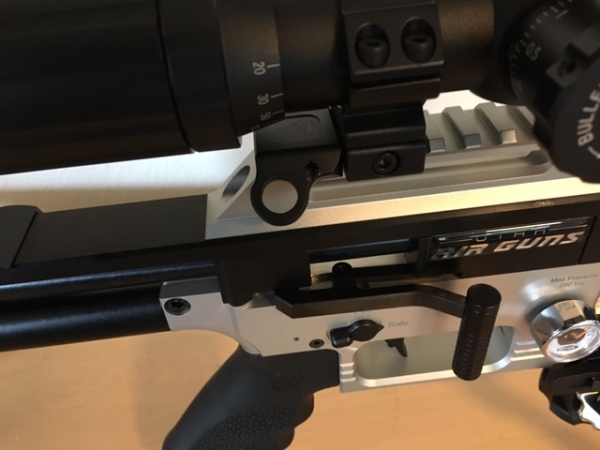

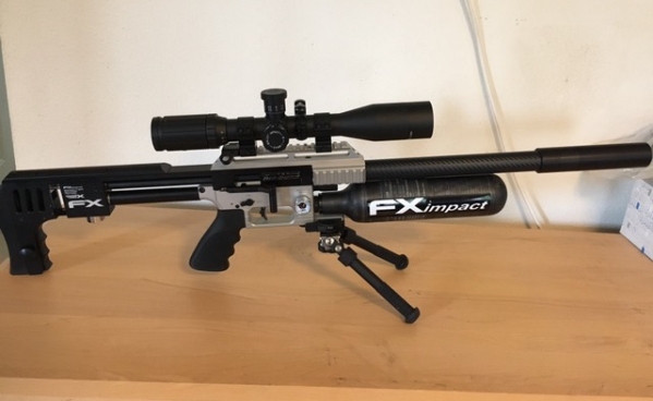

"toku58"Few thing I've done or added to the gun.
Scope is SWFA 12x42 SS.

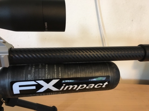

FX Decal on the bottle
Green Blob bipod. (3 washer/o-ring mod)
Anti cant scope level.
A picatinny rail QD sling mount.
Carbon fiber wrap on the shroud:

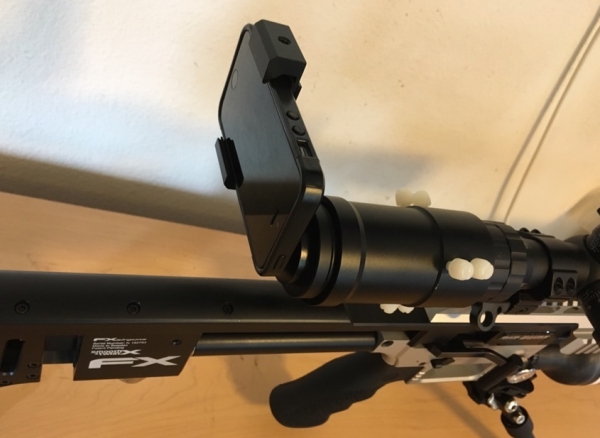

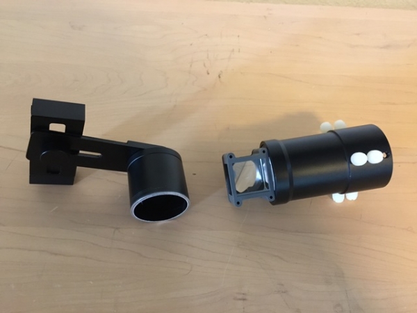

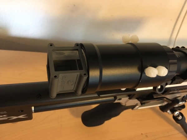

Now I'm building a Sports camera prism mount.
Got the universal camera mount from Ebay Cut the insert tube about 3/4" and made pvc shims to mount the prism. The scope mount can do both mount my phone or mount the Sports camera. With the sports camera it will work like a poor mans "Side Shot" where I can still shoot it like a regular scope.
I'm still waiting on my 4k sports camera to come in from Amazon.
But so far I've spent about $70 for this set up. Not bad considering that it can do both phone and Go Pro type of camera.

What is the brand/name of the square prism you have and where did you buy it from? I'm interested in getting one myself for a project as well but can't seem to find them. Thanks!
Not sure what the brand is. But I ordered it off Aliexpress Ebay has them as well.It's sold for Paintball and airsoft.
The problem I came across is similar to what "Hajimoto" was having. Most sports cameras do not have the ability to zoom. so the image is very small when recording with a Gopro type of camera.
I'm ordering the Gopro Sessions 5, and I found a zoom lens attachment for it. I'll see how that works. But for now it seems like the smart phone is the best option.
