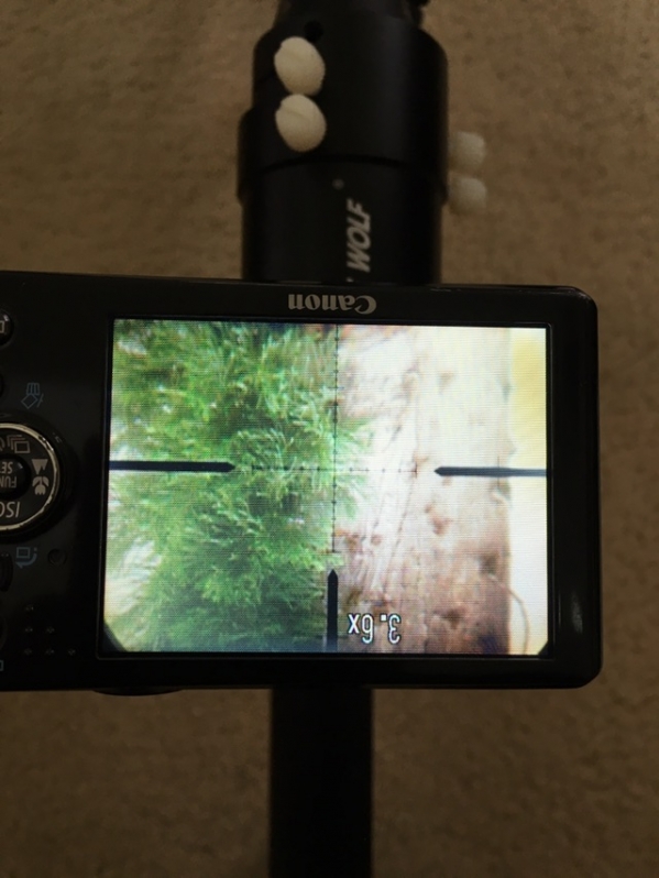

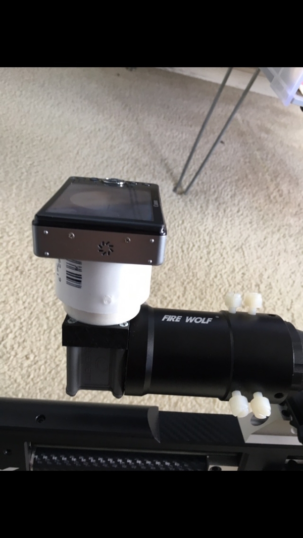

Well prelim trials seems to work really well! Maybe I need to invest in a better camera?
All in total I think it was around $90 parts and labor. (Not including the cost of the camera.)
But you guys should try it!

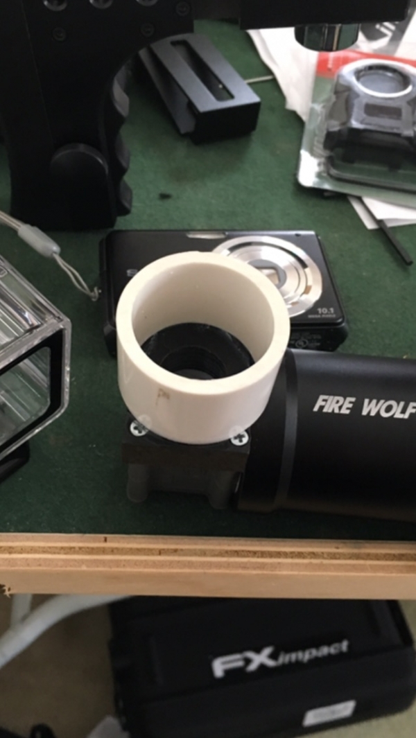

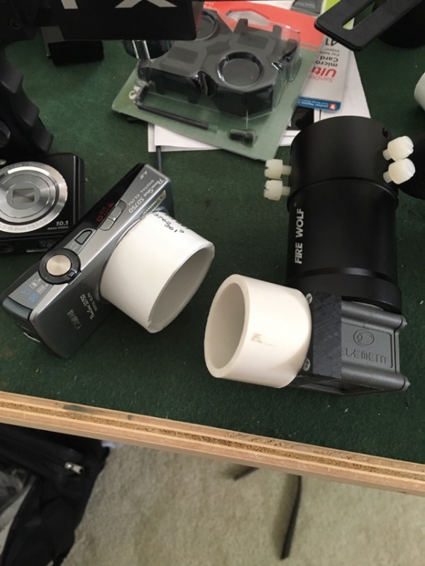

The reason I didn't just use one piece of PVC and glue the camera direct was because I wanted to be able to still use the camera as a camera. And the slip fit of the coupling allows me to fine tune the adjustment!
SUPER STOKED!!!!
Parts:
Prism
Phone scope mount
1/2" Delrin plate
1 1/4" PVC about an inch long
1 1/4" PVC coupling cut to about 1" long
some super glue
And a Digital camera

"kmd1984"Dude, that looks great! Awesome job! I believe at the end you zoomed in using the camera, nor the scope, right?
The scope is a fixed 12x SWFA SS. The zoom was done with the camera
I'll make a post just for the build of this so others can give it a shot!
