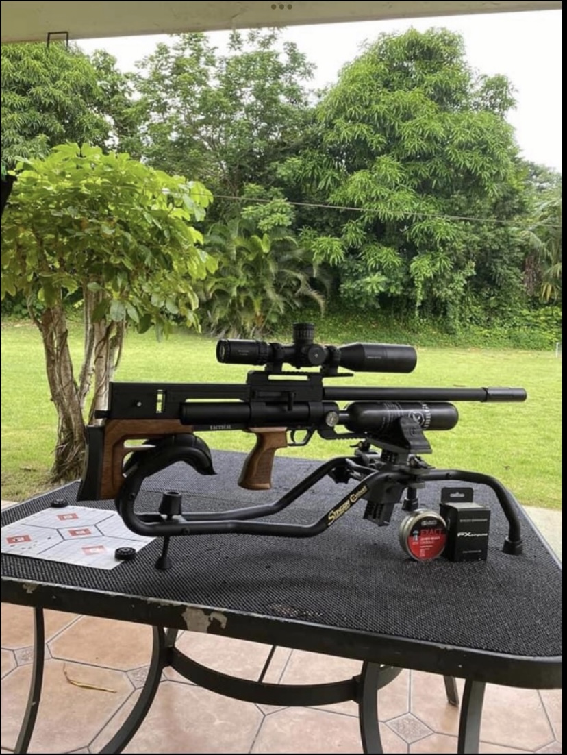

I am going to sell my Kalibrgun cricket II tactical .60 thats has been working flawlessly to buy the new FX King with his beautiful GRS stock. But after reading this, now I am not sure if this would be a wise decision taking in consideration that I don’t live in the states and if I need any kind of services durring his warranty period It will be very expensive to me to shipped back to the states to do the repairs.
Do you consider this FX King backyard friendly? I am not sure to buy it in .22 or .25 cal, I already have plenty of pellets in both sizes because I have three more airguns. Any reason why you choose the .25 over the .22 cal? Thanks
I have a Donny Fl Sumo moderator on my King and shoot it in a fairly urban setting in relatively close proximy to my neighbors. It is sufficiently quiet.
