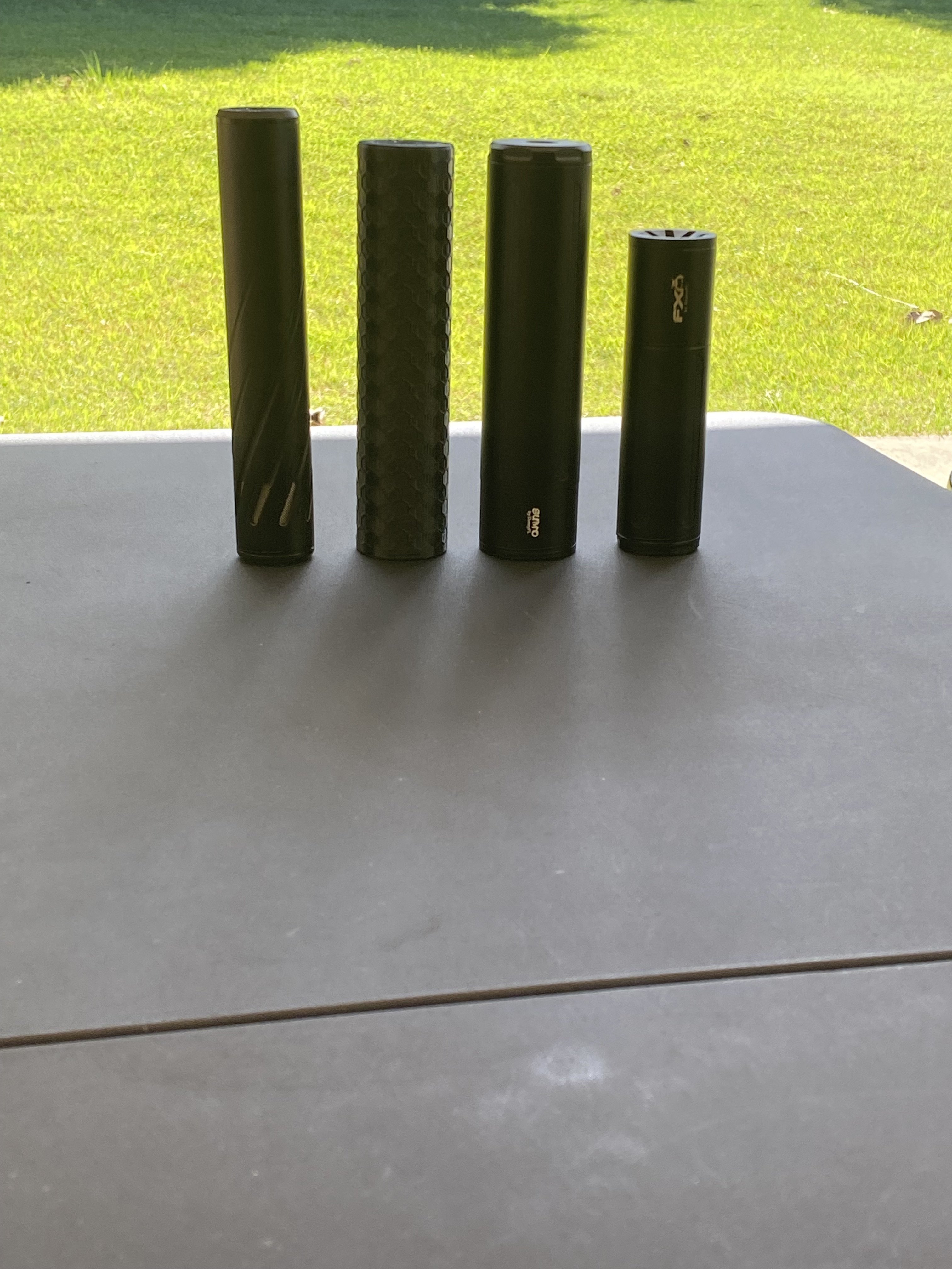

Thanks for the info, If these new FX King are backyard friendly I will not hesitate to buy one, in fact before selling the cricket I removed the Sumo and installed one of my Huggett moderators and became even more quieter which is why I decided to sell it along with the rifle to put another on the next one I buy. Currently these are the ones I am using on my others three Avengers. From left to right is the Huggett snipe standard, the Buck-Rail 3D printed, the sumo and FX DonnyFL moderators.
