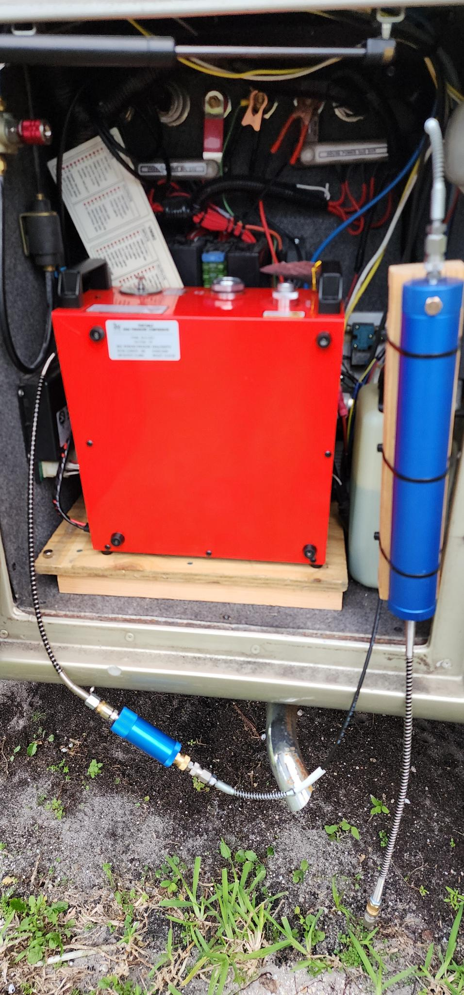

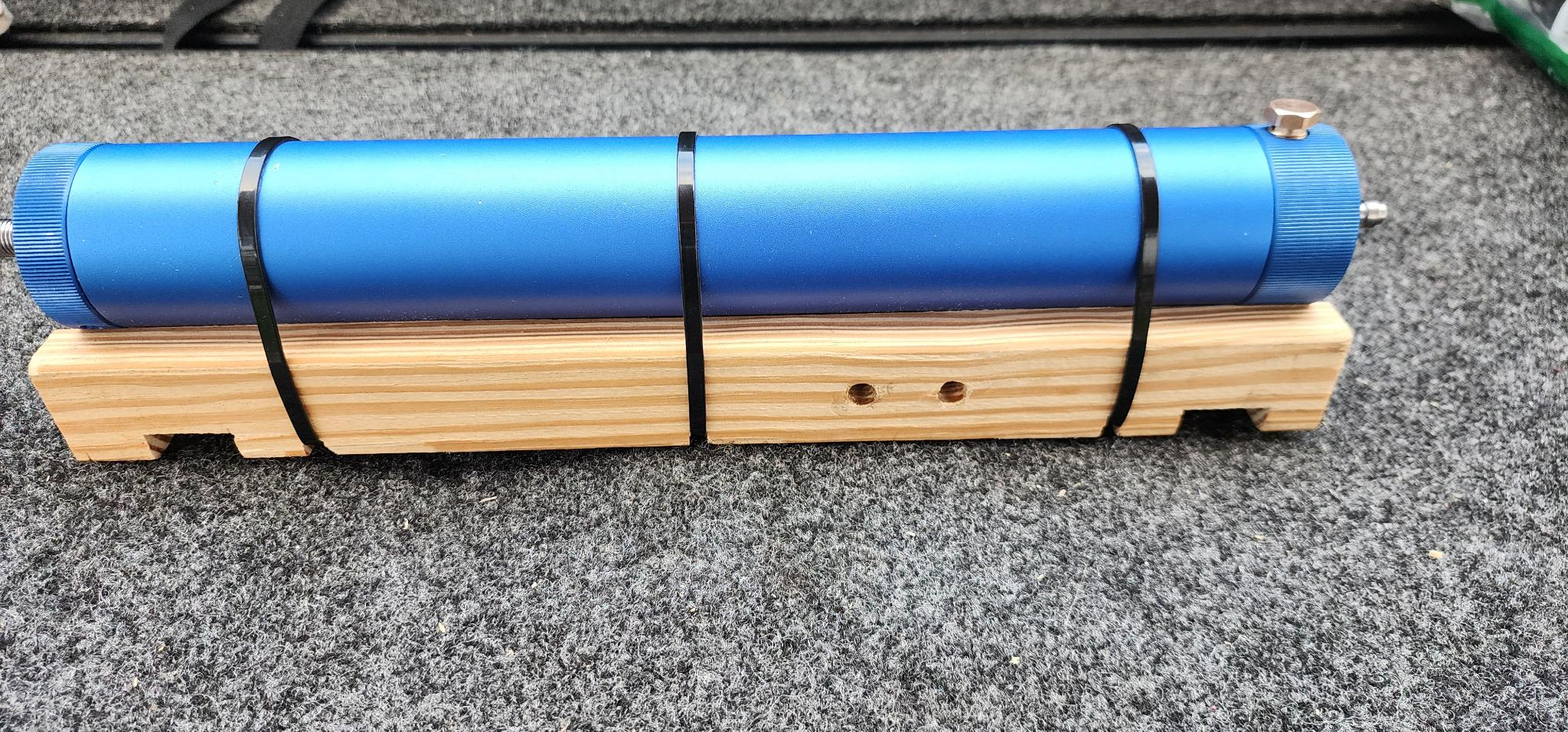

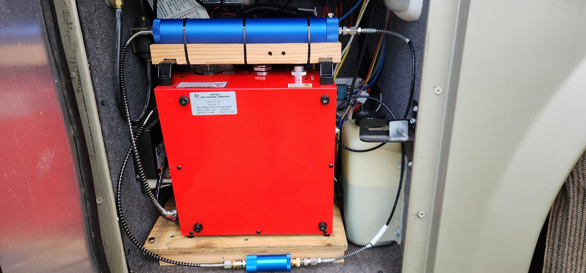

Finally got the CS4-I set up in its final resting place today. Put the filter on a block of wood cut to fit the handles when resting, and it hangs on the door post when in use.
Why the second smaller filter post compression? Isn’t that one just cotton? Wouldn’t the larger filter take care of any moisture much better than the smaller one?
Because I had purchased it based on threads here, before I had educated myself as to its actual usefulness, which is practically zilch. But since I already have it, I just put it in line as a water trap, with nothing in it. I should probably put some desiccant beads in it to give more surface area for the water to coalesce out when pumping.
