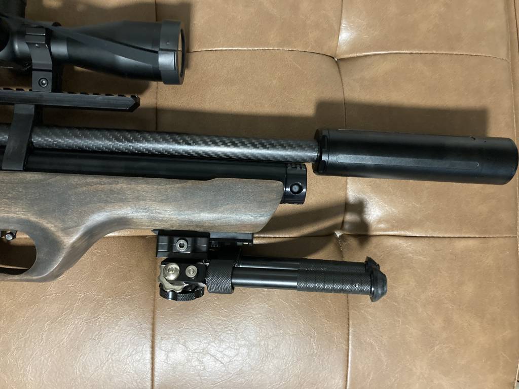

My Hatsan Flashpup project gun
I wanted a rifle to mess around with as a hobby and to shoot, in addition to my 2240's and 1322. I like to tinker.
The price was right, so I went with a Flashpup 22 from Utah Airguns. I committed to the Hatsan after always wanting a bull-pup and watching about every video on youtube about them first. Brotherinair channel deserves a substantial amount of credit for my purchase.

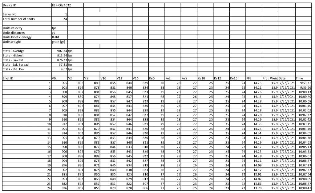

Mine groups the Hades, AA 16gr, and JSB 18gr best. The tune I use work well for all these pellets, with the hades being the best.

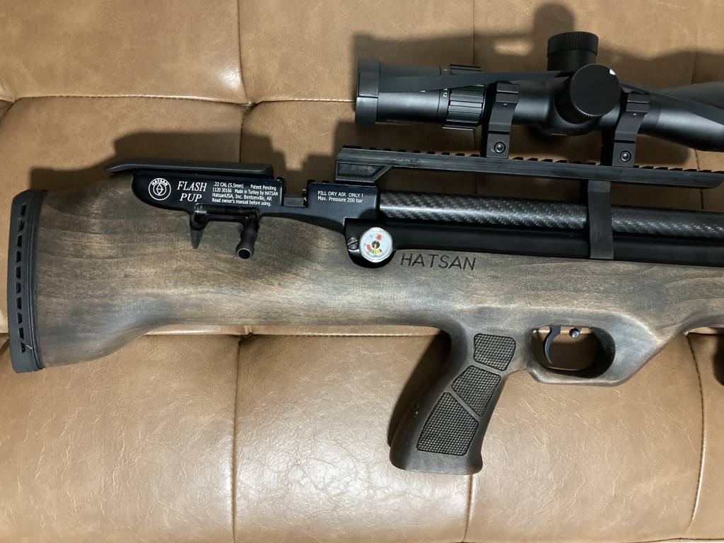

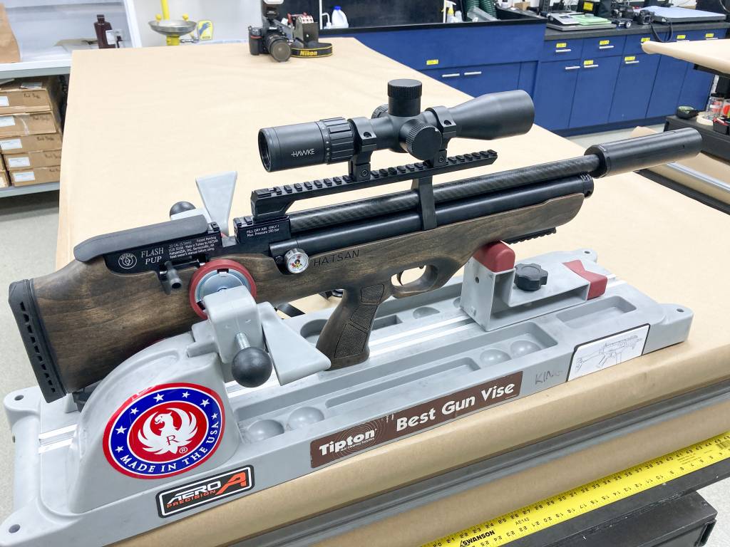

My work so far
-Huma reg install at 150bar
-Carbon fiber shroud
-DonnyFL Sumo
-Hawke Sport Optics Airmax 30 SF Compact 3-12x40 AMX IR Riflescope
-BLK Rings
-Cleaned and lubricated action
-All factory seals replaced and greased
-Removed stain, sanded, stained ebony, matte clear coat
-Lots of shooting and tuning reg and hammer spring. Trying to get 24 shots before going off reg and staying in the pellets happy zone
Upcoming
+ Polish hammer and inside of action (mine has a section that would shred cheese with ease)
+ Try and figure out a way to have larger bolt handle
+ Low tune and pellet

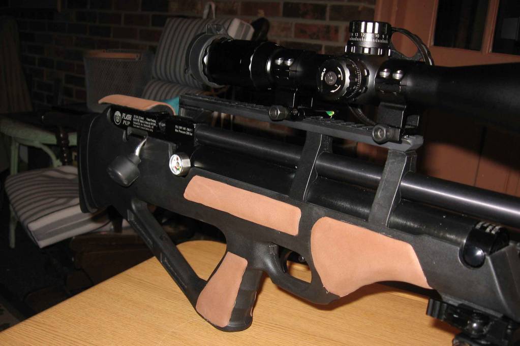

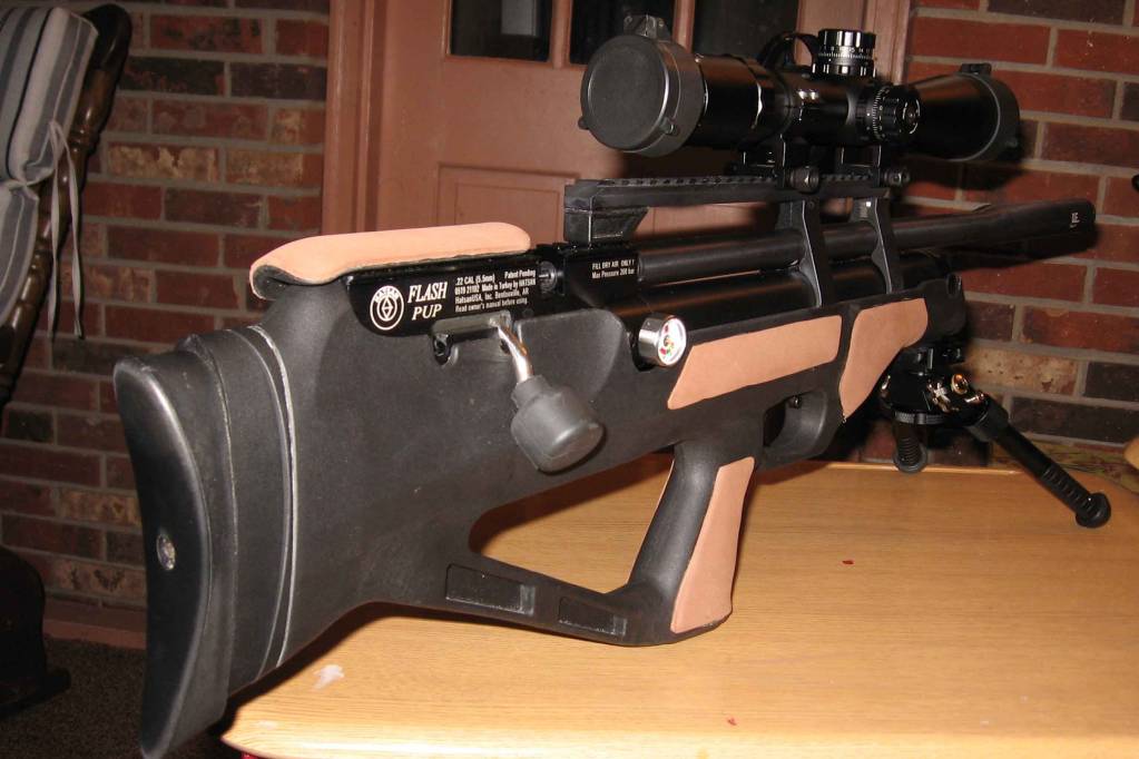

Here is what I did to add a larger bolt handle on my SFP. Using RTV glued the "shipping protector" that came with my gun. Looks a little gaudy but it is oh so comfortable and is holding up great.
Also added a front scope rail mount and a rear 3/32nd spacer just under the rear of the scope rail. Gives me a 25yd zero without using hardly any of the scopes elevation turret.

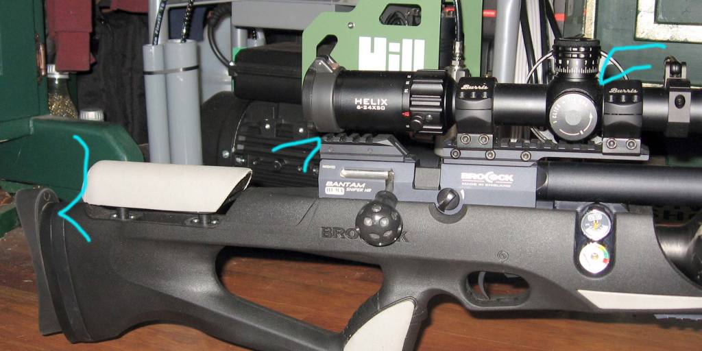

Did that bigger bolt handle thing on my Bantam also. Its a boldt on handle.

Hi
What diameter of your carbon shroud ? Your FlashPup is the normal or QE ?
Thanks
Hi
Thanks
This is what I ordered. I wet sanded it to remove the gloss, as a matte option wasn’t available at the time.
Abester ID 14mm x OD 20mm x 500mm Carbon Fiber Tube 3K Glossy Surface Roll Pipe (1 Piece) https://a.co/d/00BlWZT
