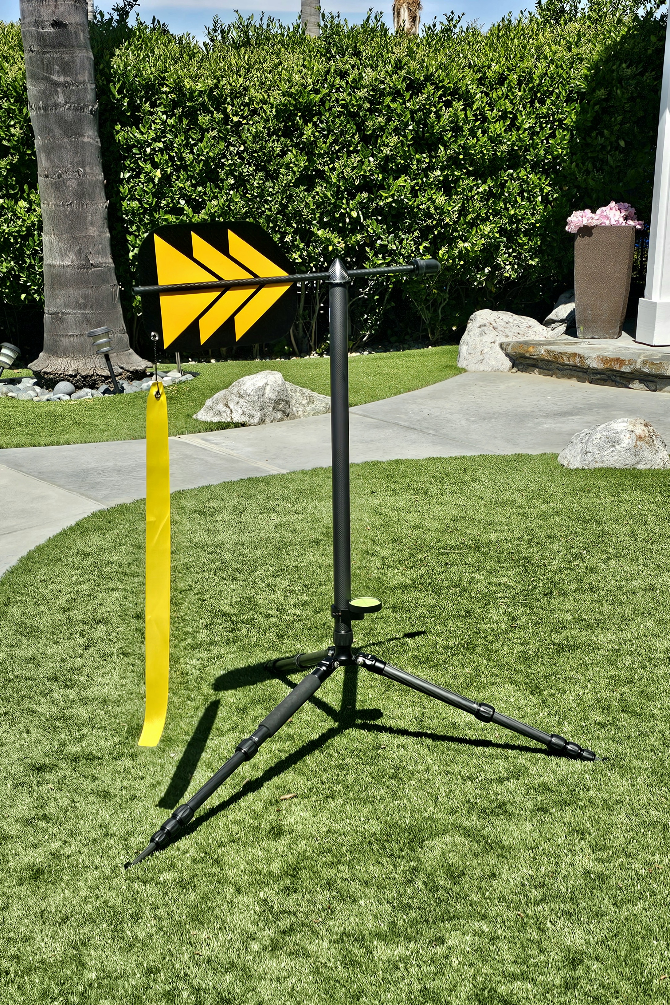

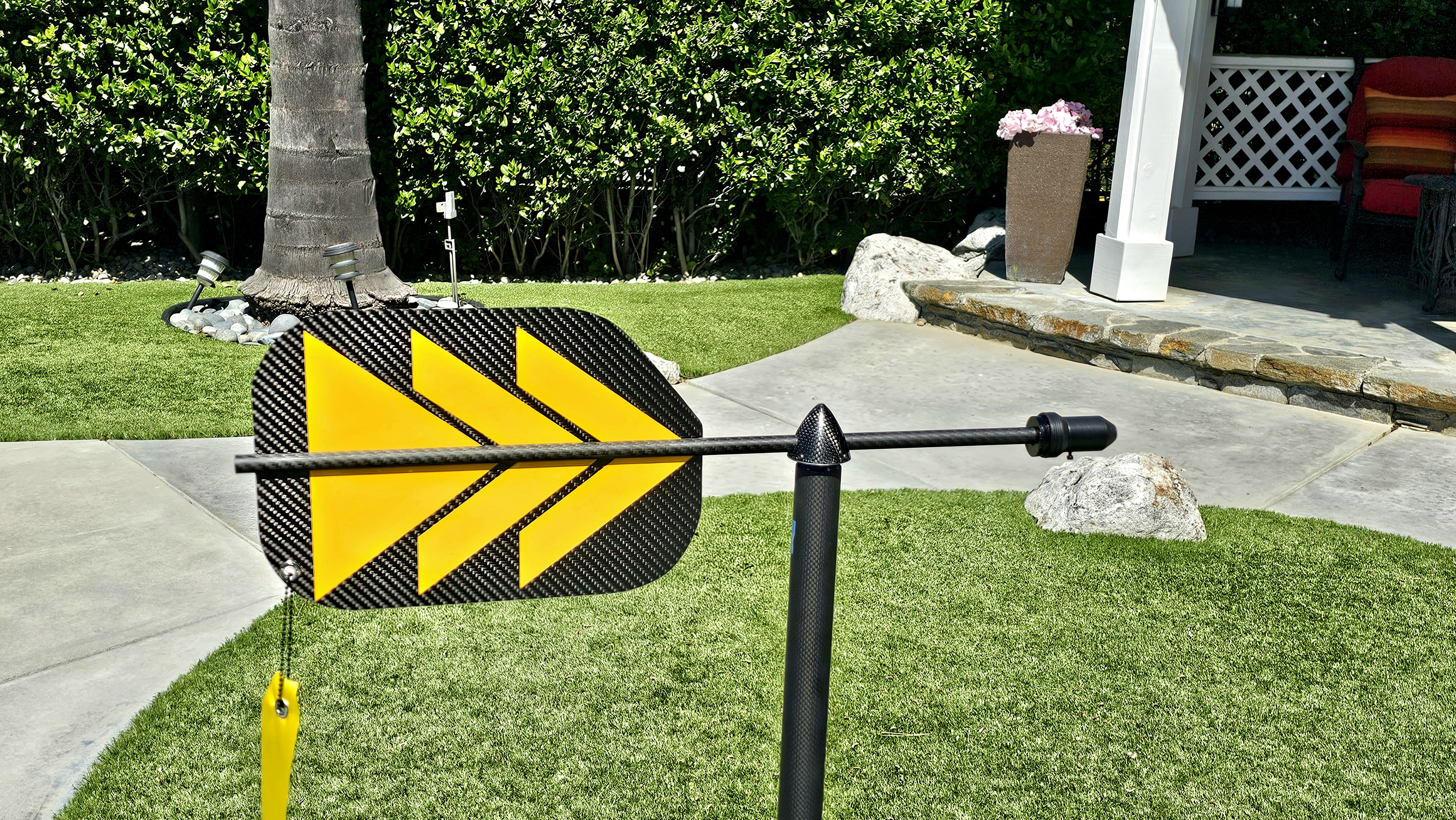

My home made wind flag

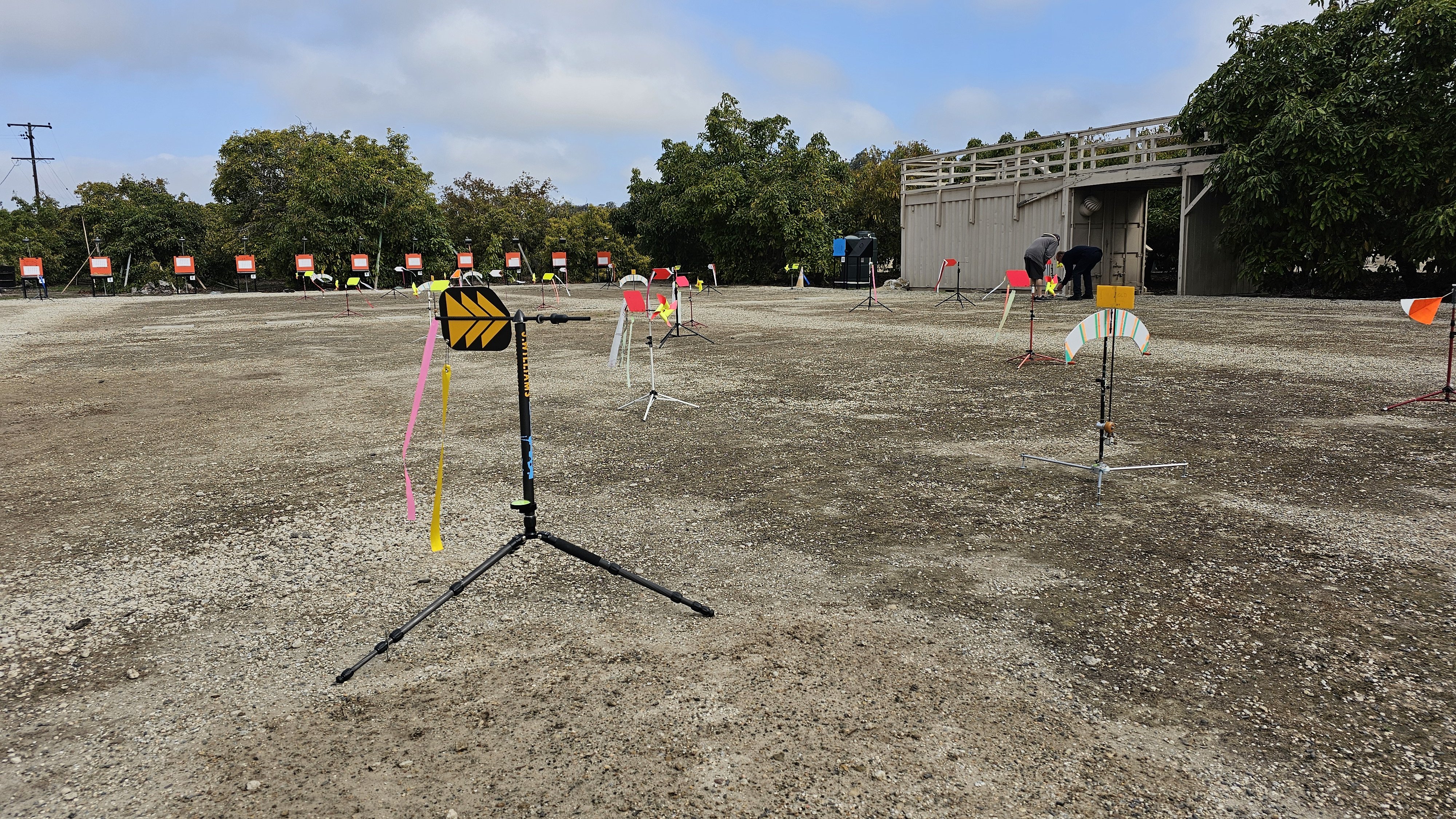

First one of four wind flags is finished. Now to test it Sunday at the N50 match at Open Grove.

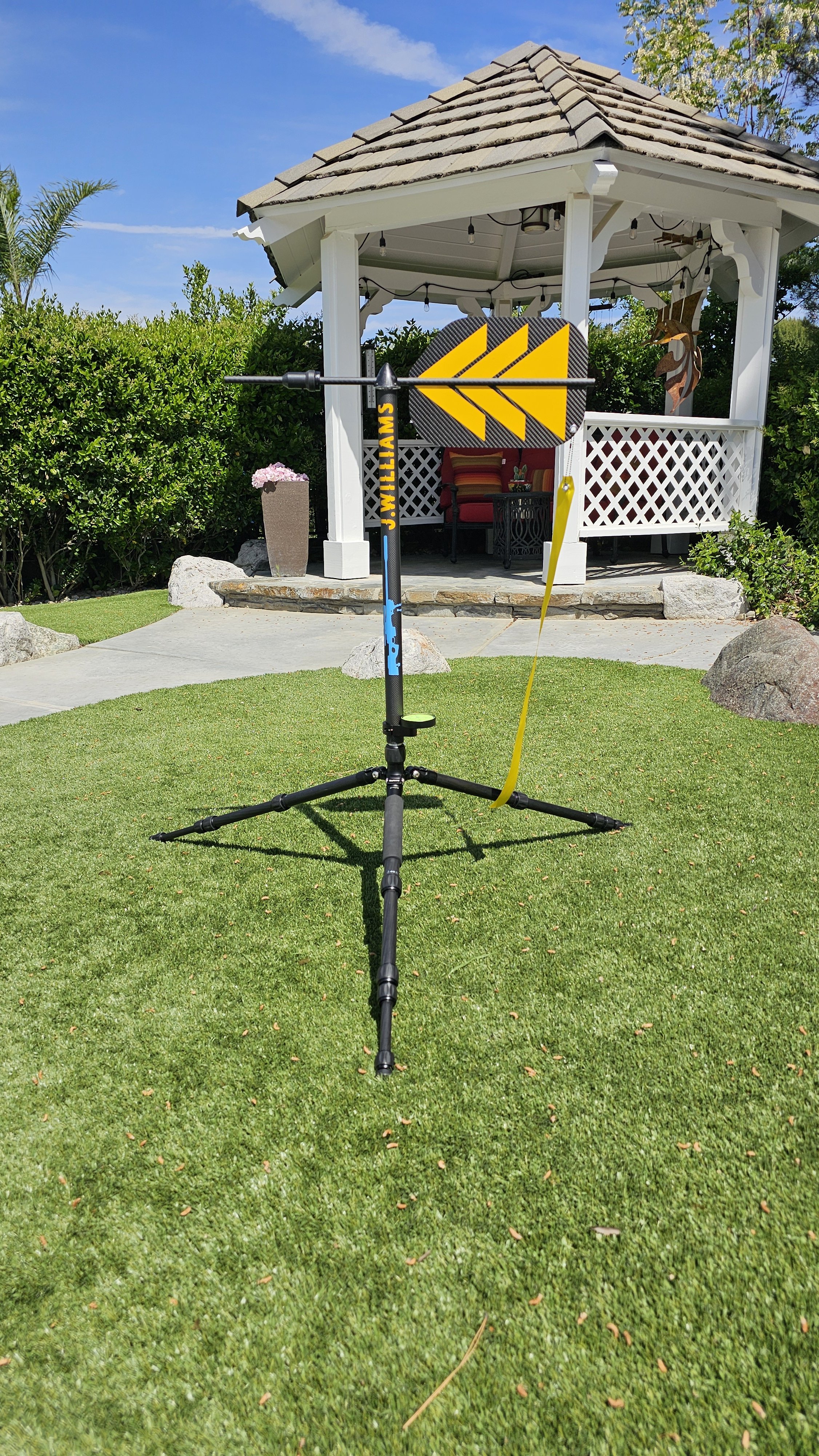

Maybe I'm wrong but are the yellow arrows on the tail supposed to point out the wind direction? If so, are they backwards?
I suppose I would have to see it in action.
But, it looks great.
Wicks style flags have the arrow pointing in the direction that the wind is coming from. It also points towards the approximate direction of the hold off.
Wicks flags are doubled vaned, its very easy to read direction, single vane flags are a lot harder to read and personally if using arrows I want them pointing the direction the wind is heading not coming. You will see two tone round balls in the front, different color props or spinners to help indicate direction of flags. JMHO
Shooting out to 500yds I have tried double vane flags figuring they are more visible. For me that is not the case, they sit on a shelf in the garage. Wht is more visible to me is a sailcloth tale in the raspberry color. The flag the gentleman made above looks very nice and well made. Tripod style legs are ok on level ground with little wind, they don't work at some ranges with uneven or hilly terrain.The yellow tail is visible against green grass but tends to go away at distance and in bright sun or against snow in the winter. Flags can get complicated trying to have them very visible in all conditions especially past 100 yards. But often heard at bench matches regardless of the distance, He who reads the flags correctly wins. Actually seeing the tail quickly and easily tells me all I am looking for.
