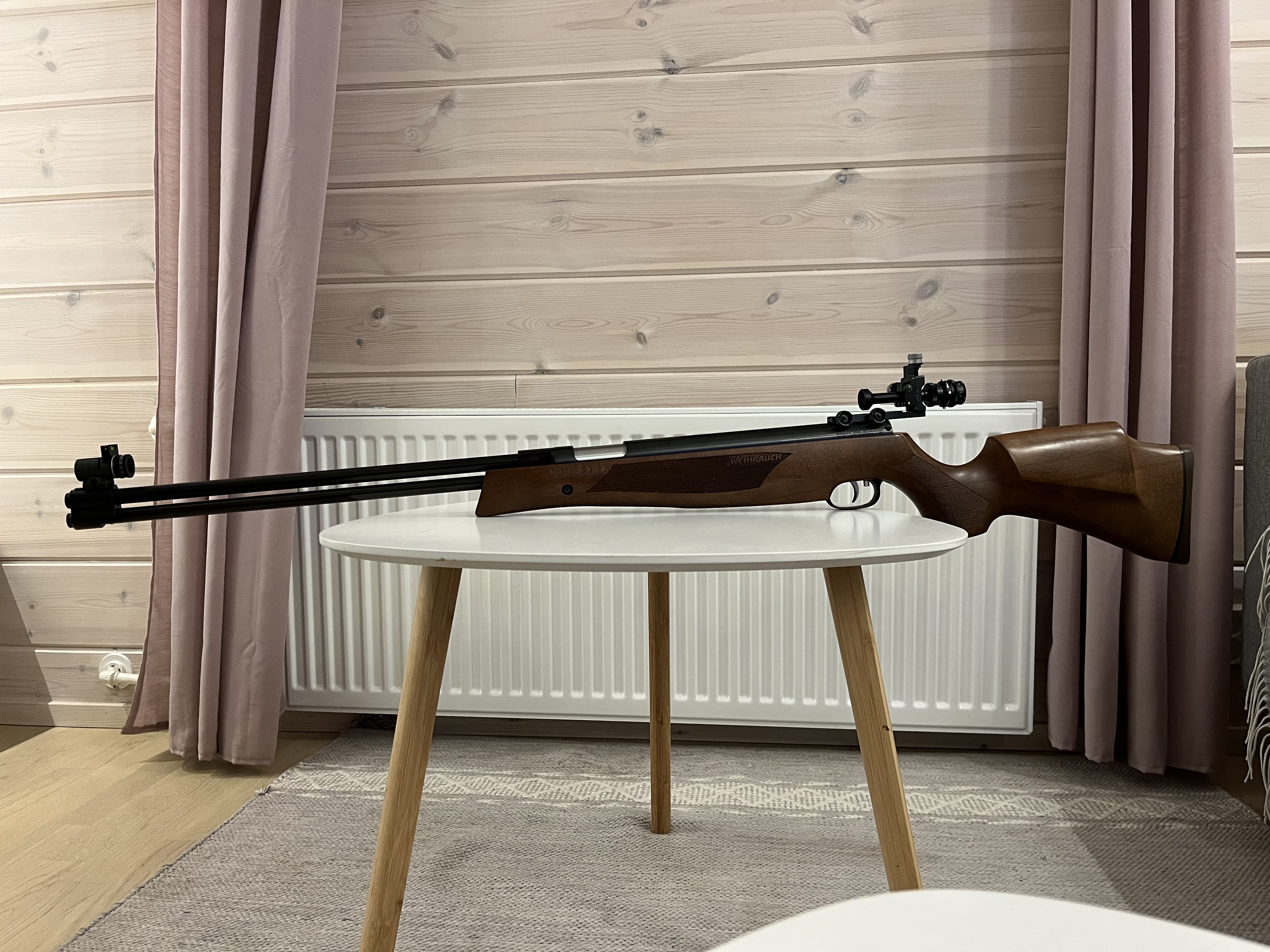

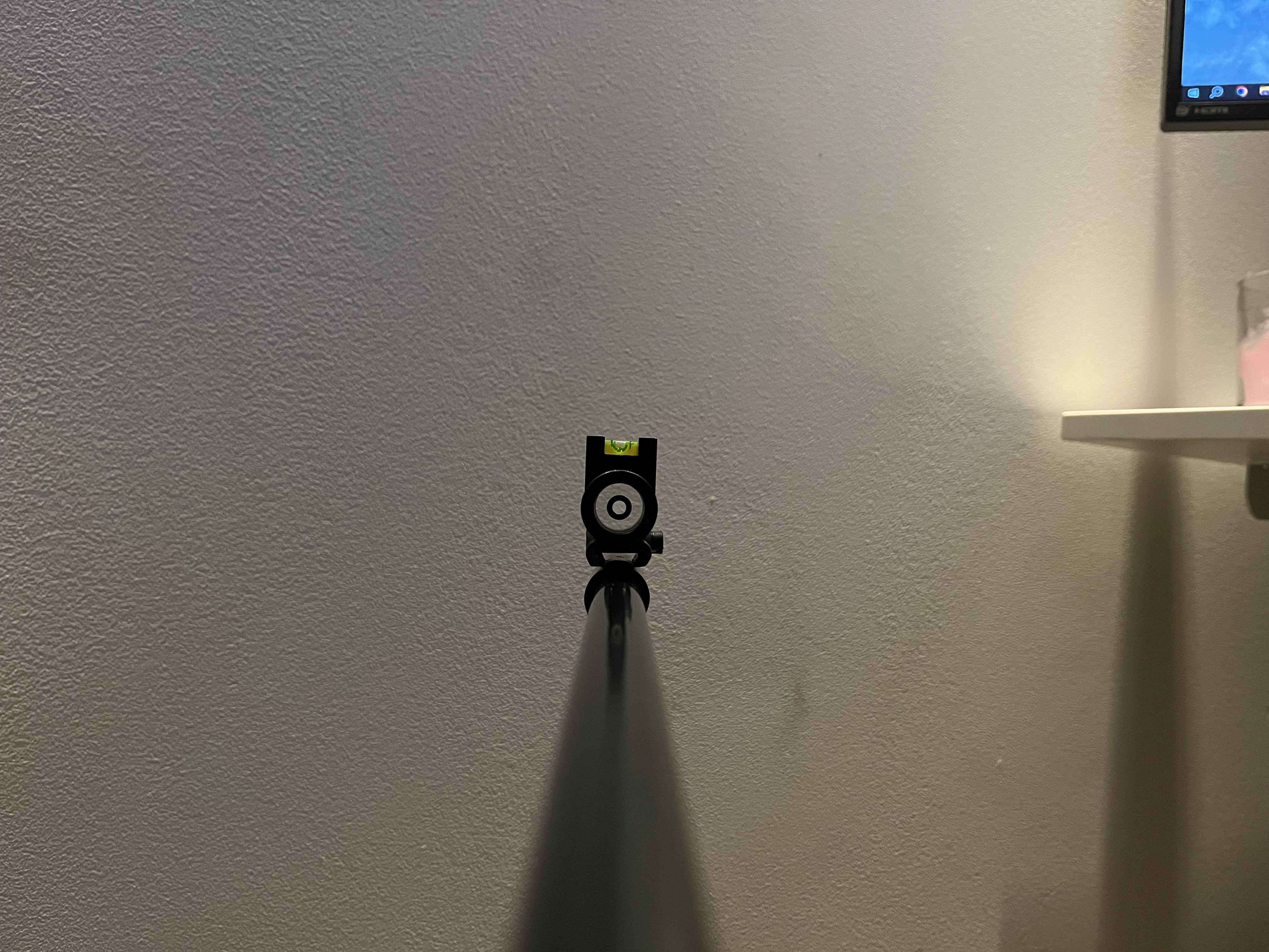

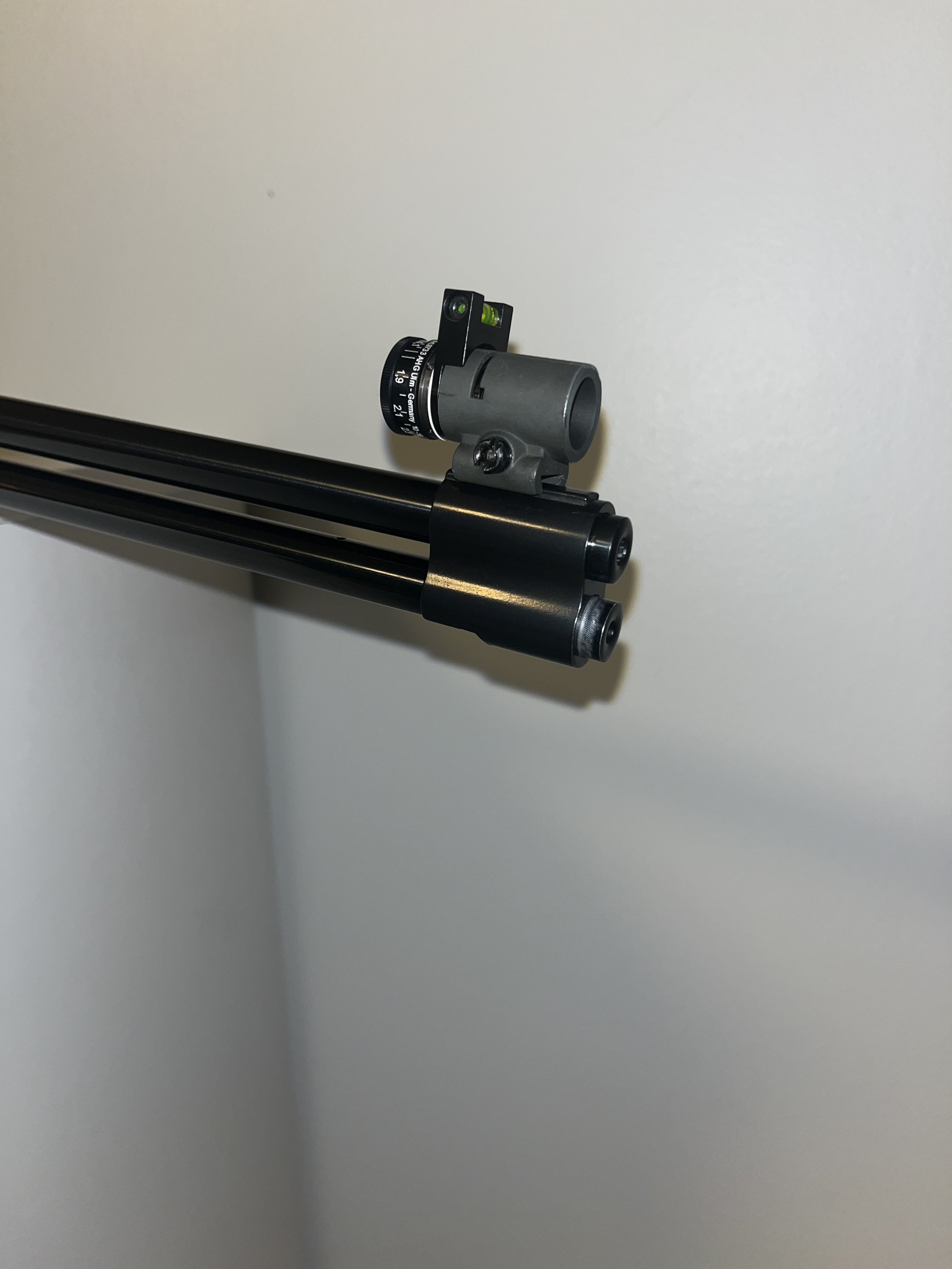

HW/Weihrauch My HW77 is Complete
Welp…
I don’t know what’s left to do to this rifle. It’s tuned. Shooting its favorite pellet. It even has Olympic match sights now.
Just put on the Anschutz Super Iris in the front sight with a Gehmann bubble level.
This should make those 2” plates at 50m easy peasy.

nice older Anschutz diopter looks to be a fancy Gehmann iris with sunshade and of course the front globe sight and the sight are worth the cost of the rifle almost but the sights do not lose money they are not a ham sandwich which would be eaten and gone

Welp…
This should make those 2” plates at 50m easy peasy. View attachment 537352View attachment 537351View attachment 537350
