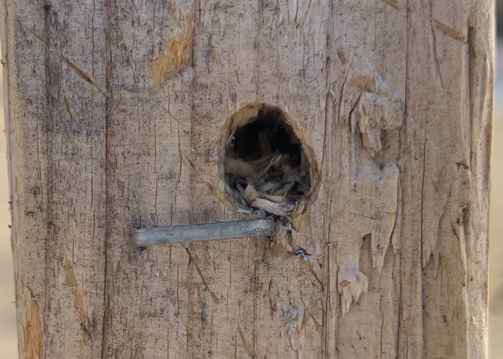

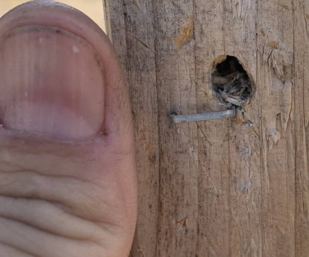

My gun is plenty powerful and I’ve been shooting more and more pellets lately after getting tired of testing slugs constantly for almost 2 years. I was able to turn my reg. down to 120BAR, my HS preload is about 1/2 way, the valve adjuster is 3.25 lines, power wheel on max. and I’m getting 930fps with the 33.95gr. MKII’s. That’s perfect for every day use. Even with the valve rod problems with this gun and a plethora of problems with my first Impact, I don’t think there is a gun out there that can compare for my shooting needs and wants.
I shot this group after retuning my gun for pellets(MKII’s) after my valve rod broke. Probably the best 5 shot group I will ever shoot, so I love to share. 5 shots at 75yds. I liked your story, I needed to read something and then write something myself to keep my mind off of all the madness going on right now. Have a great day!

It's great to hear that both of you are doing well with your troubleshooting and mods. Nice group it is for sure stoti.
