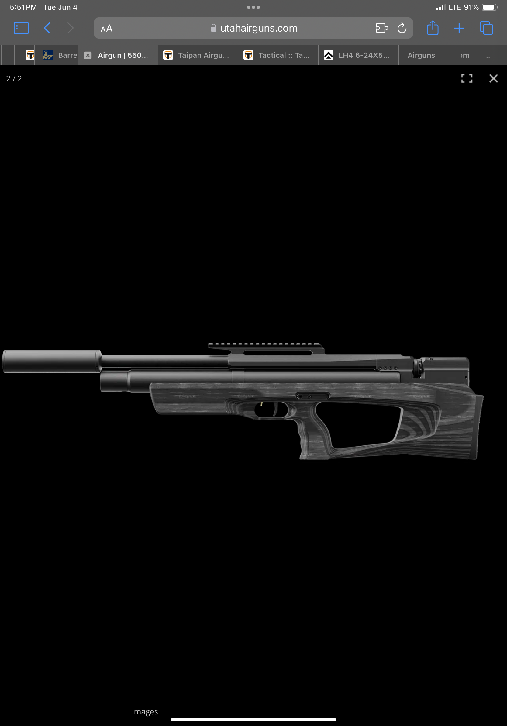

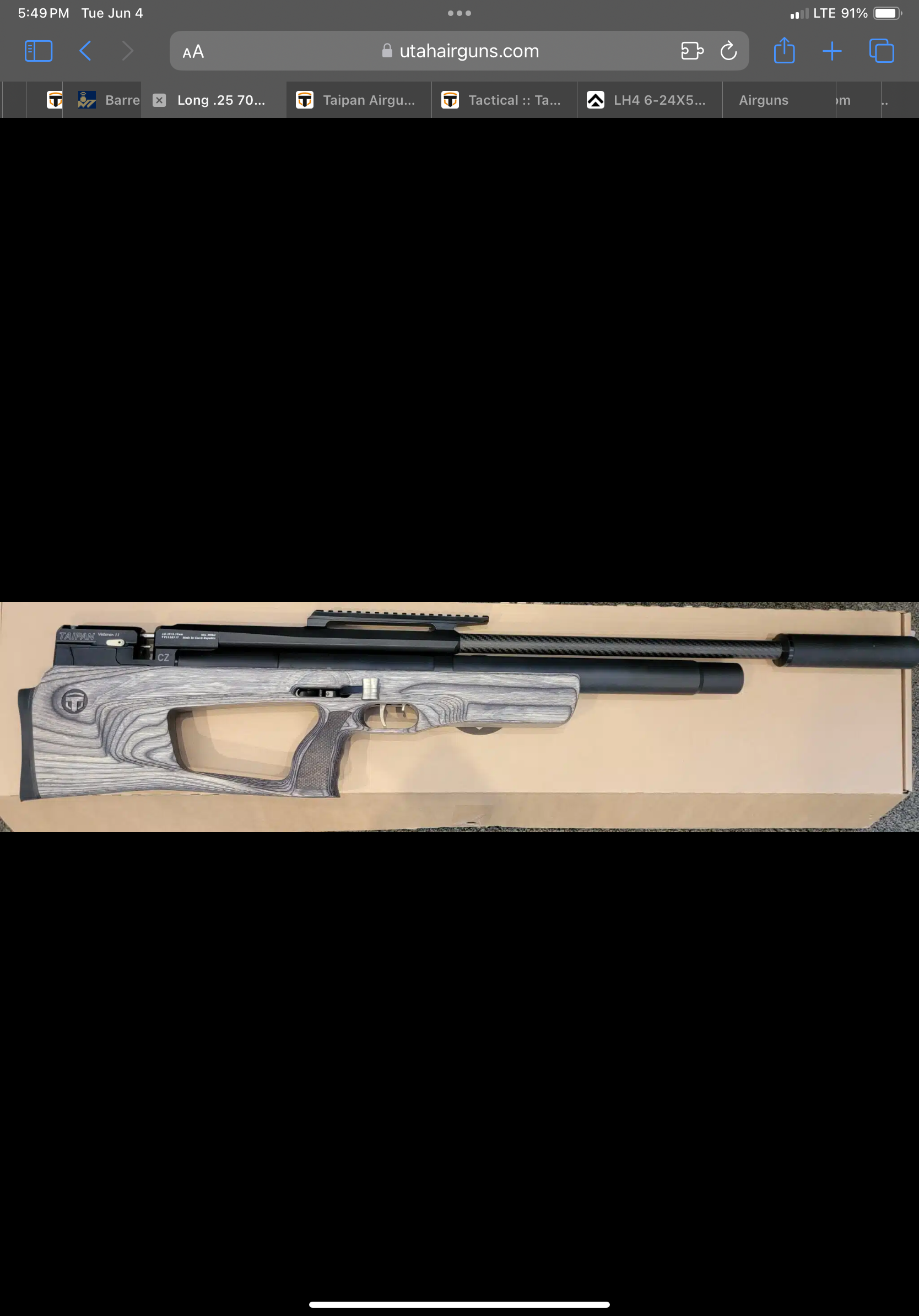

I believe the power plenum for the Taipan Veteran 2 is intended for the 700mm barre version. Here you can see the classic stock Vet 2 (non-tactical) in both 550mm and 700 forms - note the added plenum with the 700mm.
I wonder if you could use the plenum with the 550mm barrel if you used the extended length moderator from the tactical model… I’m guessing the extended moderator would likely be too fat and would touch the air tube - but if not, it would look ok as the 550mm + tactical moderator would be longer than the airtube with plenum added.
