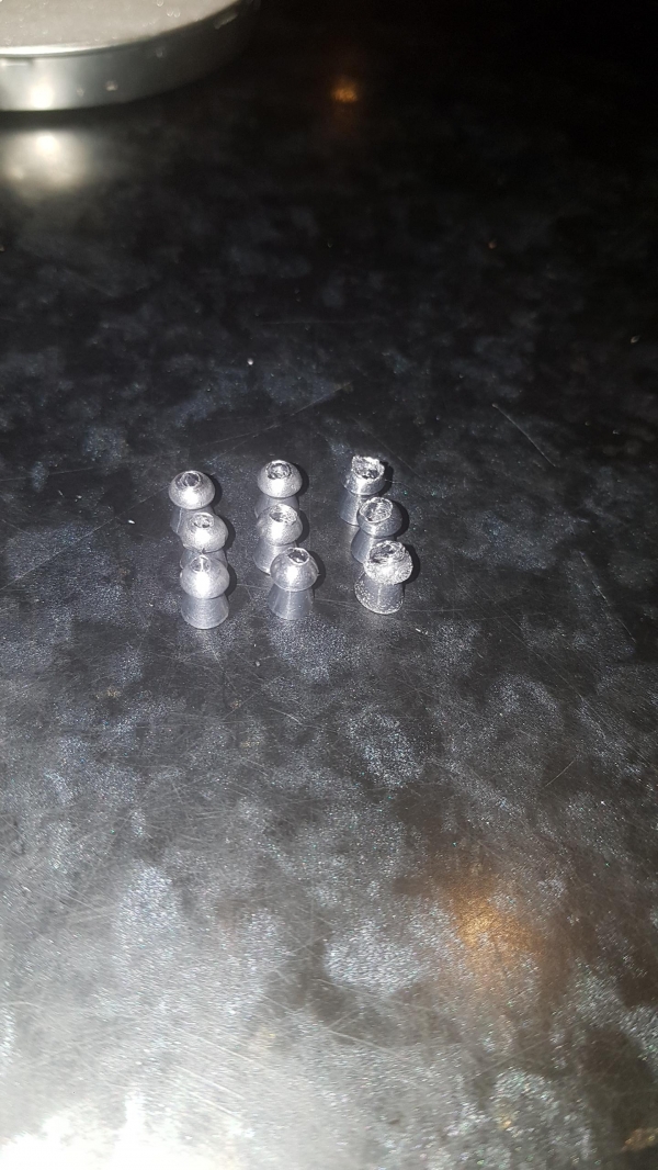

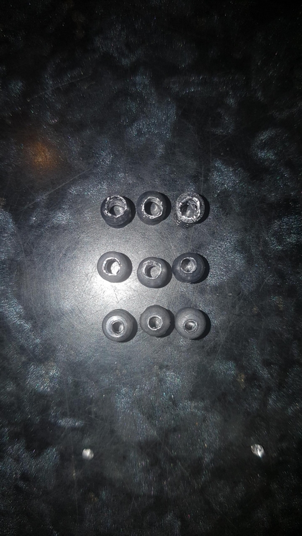

I started with 18.13gr JSB pellets and drilled the holes in three sizes, using three pellets for each. Awfully hard job but if a mold was to be made it would be a lot more accurate. (It would also stop a lot of lead shavings from landing on my kitchen bench. (My wife is a saint) I drilled the holes and then weighed each pellet to see what the resulting weight was before shooting them over the chrony and recording speed and energy out of my MK1 Wildcat 22. Here are the results.
Standard 18.13 : 912fps-33.5fpe
2mm hole 15 grains : 808 fps-21.8fpe
2.5mm hole 13.1 grains : 750fps-16.4fpe
3mm hole 11.4 grains : 645fps-10.5fpe
I was extremely happy with the results but not sure if the current market warrants any pellet manufacturers mass producing them. Also they were very inaccurate but I put that down to the off centre holes that I drilled. (I did my best) Thought I might see if anyone else was interested in a low powered "Hollowgut" pellet design.
