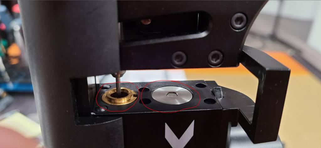

Tent shot and a big hisss, the gun lost the entire air within two minutes, air leaking out from both holes, the 2mm oring but also from transfer port.
First came to mind, I let the VS adjuster all the way out and the increased HS knocked the valve rod way too far and the 2mm oring suffered.
But that would leak the valve rod only, looks like I busted the peek puppet as well? {btw, my machinist reworked that puppet to a smaller OD back in Jan}

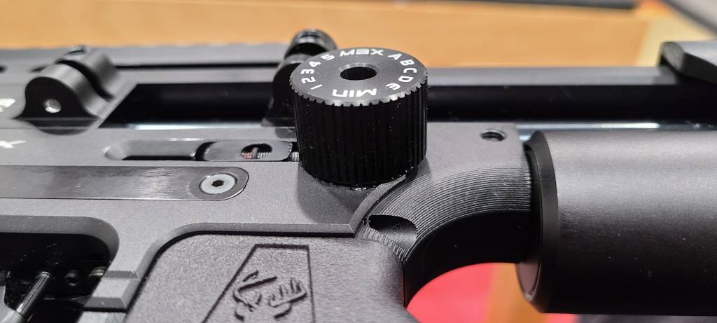

All these changes won't allow fully closing the Valve? even for a hair?
Never compared/measured the spine between the two PW's, could that be the new power incline is more aggressive vs stock MK2?
As we can see from the pic, yes the PW is on Max but the slider still has some free room to adjust, maybe about 1mm...
I just tightened the VS knob back to forth line and power up the MK2 again, interestingly it holds the air.
I did couple dry fire shots into a pillow (in my basement men's cave) still holds the air. I will leave it overnight and try to tune tomorrow again.
Looks like with a VS all the way out there was no counter-pressure on valve puppet to close against the Reg 125. For now this my cheap theory....
...There end of the rod should sit flush. In your picture it doesn't seem to be flush. So it doesnt completely seal....
That is correct for the stock guns only, but once you change the valve puppet that distance/dimension can be just anything, and honestly who cares any longer. The same applies to C1 and B8/10.
I have reworked the peek puppet 2x already...that OD drives how far the valve rod sits in relation to ie back face in the rear block .....part of a power-mod.
