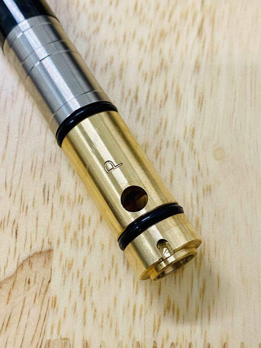

Just so you know, on my Crown MK2, the .30 cal single transfer port gives higher velocities than the dual port barrel (I have both) at any given reg pressure up to 150 Bar. This is the case with pellets anyway.

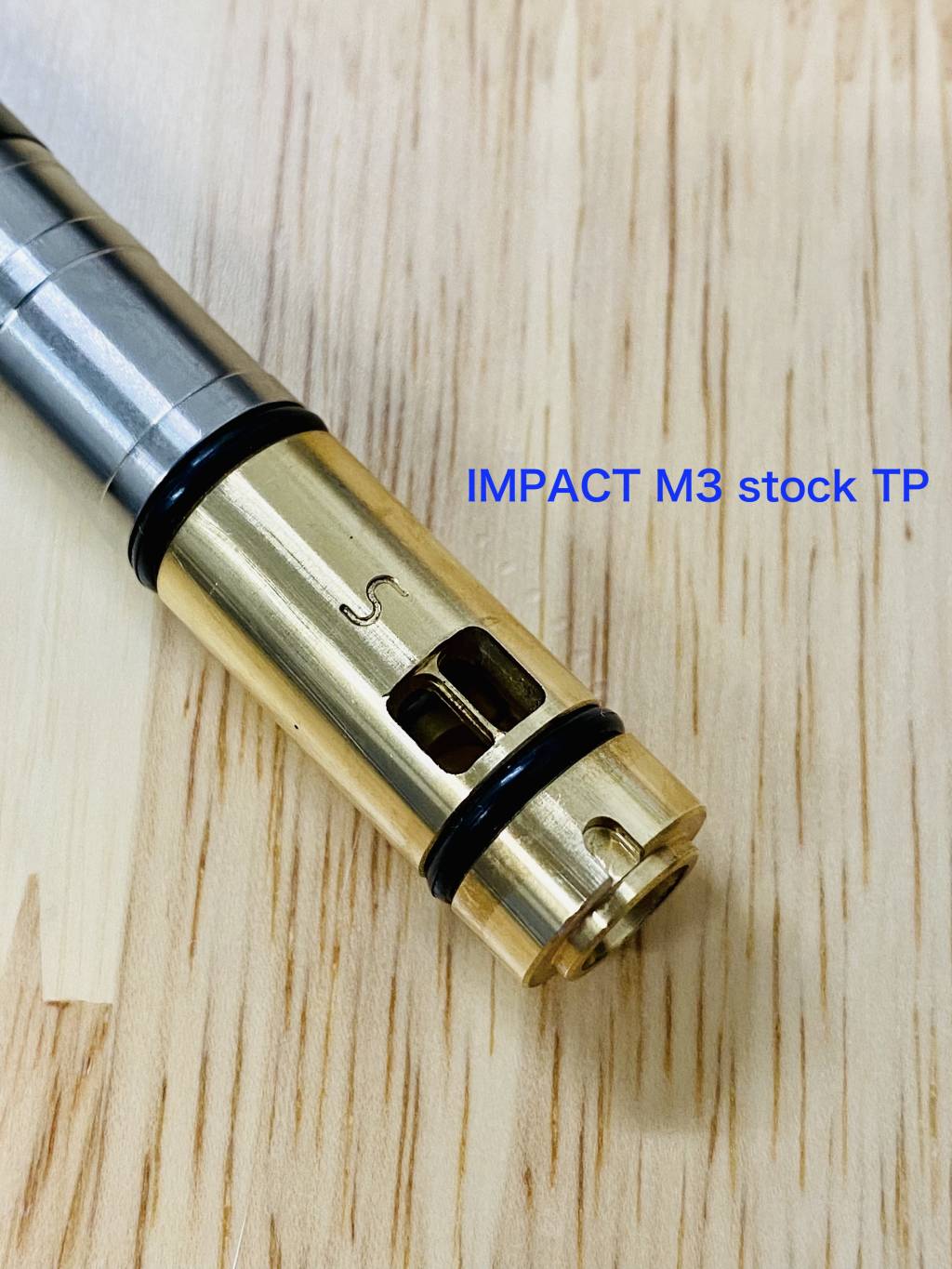

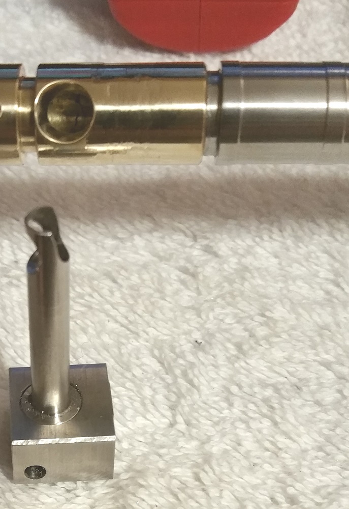

I'm sure it can push standard weight slugs to 950 but you'll need to flare and elongate the single port (which I prefer) to get heavy slugs up to that speed. I have a modified gen2 shooting 66gn slugs at 948 on 150 bar from a 700mm barrel. 132 ft/lbs
Always keep the transfer port narrower than the bore diameter to keep projectiles from tipping into the port while being chambered. Flare the entrance to a little over 7mm to be sure it covers the entire port that feeds it and elongate the port slightly towards the chamber. Some people use the pin style probe and like it but I prefer to modify the original tube style probe for better flow and feeding. Here's a pic of my port and probe. My valve is also modified a little.
