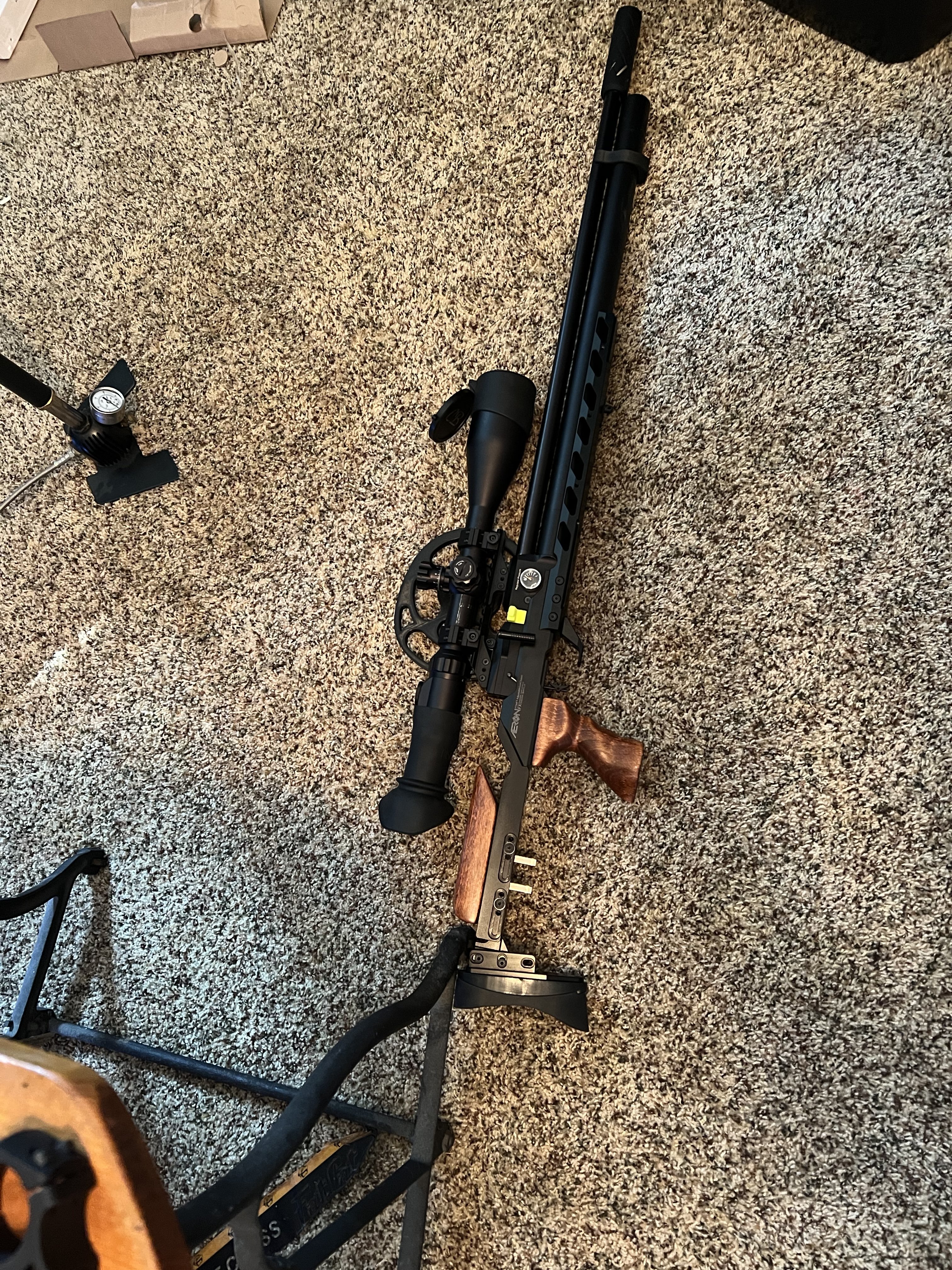

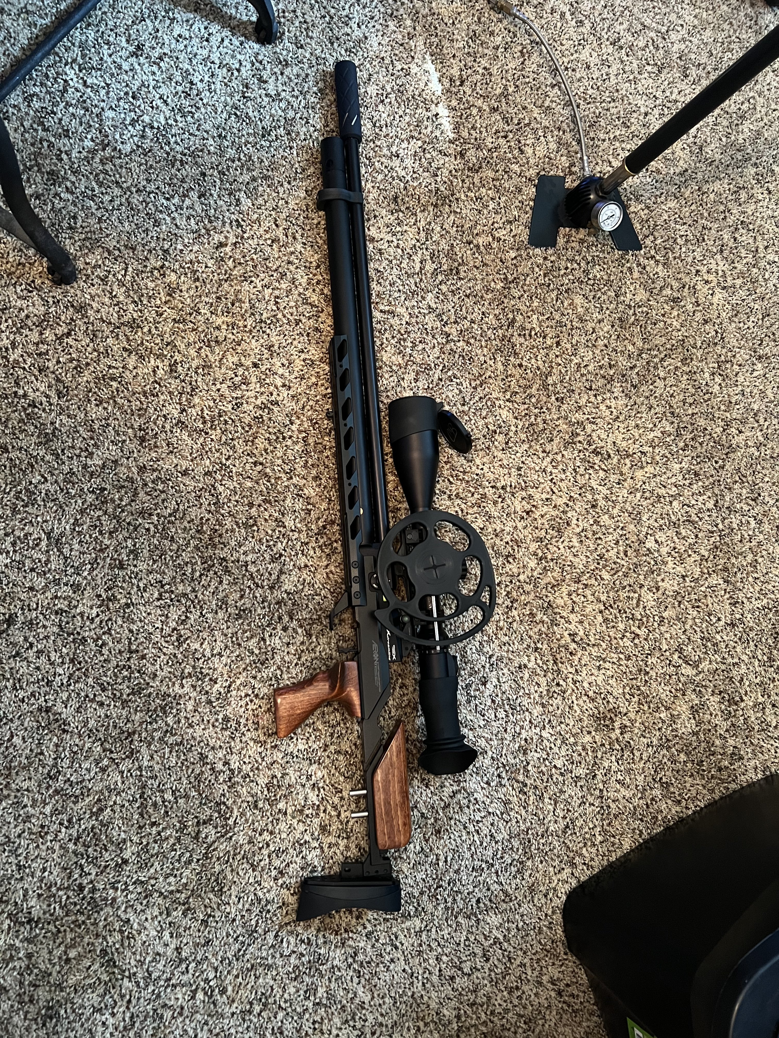

My new "backup" WFTF gun is a smoking deal!
So I saw this dreamline in ACZ FT chassis on sale at Utah Air and I couldn't myself cause I can't pass up a screaming deal!!! A dreamline classic is already $1050 normally and this dreamline in FT chassis is only $1019????? In FT world that is CHEAP for an almost competition ready FT gun. I mean every one "NEED" a backup FT gun right?
I ordered it with a carbon liner sleeve as I always do and received it in 3 days! UtahAir rocks as usual.
Here are a list of things I added/modified:
- Tuned it down to 12 FPE
- Noticed the hammer weight came with the gun is the 11 gram medium so switched to a 9 gram light hammer weight I had on hand
- added my Rowan adjustable hamster from my other FT gun, factory anschutz rail on this chassis!
- epoxied the carbon liner sleeve
- Noticed the dreamline superlight barrel does flop a bit so added a 3D printed barrel band
- UA only had the hunter version so I printed a knee rest for the rear stock
- SubMOA butt plate and hook
- Added one of my 3D printed moderator
- Printed a jam nut for the hammer spring adjuster
- added my Element Helix 6-24 SFP scope
- adjusted the trigger to single stage and 11oz
Scope is Element Helix SFP 6-24, ranges surprisingly well/accurate for $400 retail and 24x Printed a sunshade with antenna wind indicator, I really like this design.
The tune:
- Reg = 100 bars
- 9 gram hammer weight
- transfer port = medium
- Turned the hammer sprinter till I got to ~710fps with 10.3 grain pellets (the gun took a while to settle so had to adjust the HS a few times)
In the short 2 weeks I owned the gun I've already shot 2 matches, Oregon state GP and our local club match. I know some folks had issues with FX in 177 but I'm thoroughly impressed with this little "bargain" FT gun. I intentionally keeping everything as inexpensive as possible with all the things I had. All thought I didn't score as well as I liked but I blame showing up to matches with parallax wheel missing yardage markers, TWICE and the heat!!! 😅 Last weekend at the local match I decided to try a different scope I had but the scope didn't range down to 10 yards and didn't like to range between 44-55 yards so back to the Element helix. But when I did get the range right it was spot on and even knocked down quite a few long shots in 5-10mph wind where I had to hold off target, very satisfying!
Just this evening after the kids went to bed with a little day light left I grabbed my bum bag and the DL to sneak in a few shots at my 34 yard pellet box. Off my knees in my WFTF position I dropped 10+ shots into a hole no wider than 3-4 pellets across. Then I switched to empty part of target with a shot then try to hit the pellet hole with a second shot, I was able to hit most of them in the calm evening. Sadly it got dark and gun got off reg but I had a huge smile on my face. This little dreamline really impressed me, it's going to be hard to decide which gun to bring to the next match.😅
Here is a list of what I like:
- stupid accurate after little bit of work and tuning
- light weight(a little too light)
- consistent
- super quiet, very backyard friendly
- good ergonomics on the chassis that was designed for FT, can easily add on whatever you want
- very efficient with well over 100 shots @12 FPE from the 220cc tube filled to 230 bars
- CHEAP! (in FT world)
what I don't quite like:
- light weight, I need to add some weight!
- go through pellets fast!
- had to add a barrel band
If you are in the market for a FT/HFT gun, this little gem is a smoking deal right now.

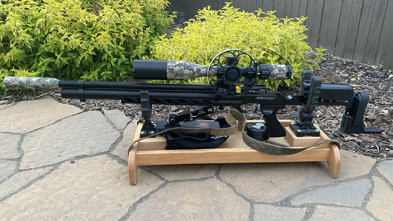

Hahaha, I’m working on it. No, it can’t quite hold a candle to the Thomas YET, but it certainly has plenty of room for improvement. Due to its inherent “weaknesses” it’s a better practice/training FT gun. Due to its light weight and “cheap” 24x scope it take a heck a lot more concentration to shoot any where near as well as I can with the much heavier Thomas with 40x scope.
I’m planning on adding some weight but will likely keep it relatively light just so it is harder to practice with. Either way it was a great deal and fun project.
Maybe, just maybe one day I’ll get a springer just so I can look as cool as Cameron! 😅 you know who I’ll bug for help if that ever happens. 😜
Now being I frequently shoot with Mr. Q, am yet to see this FX perform to the level or really actually even close to his primary FT rifle.
May have kinship to why in the FT game was see so few FX's in the game :unsure:
Mr. Q is a talented FX fiddler & if anyone can get it sorted out it is him ... we'll be watching to see what he can do with it as time marches on ?
So the Dreamline FT rig is coming along quite nicely. The 7 gram hammer needed too much spring so I switched to a 9 gram brass hammer which settled the shot cycle quite nicely. Also added sub MOA butt plate + hook.
Decided to attend the FT match at concord and scored a 54 out of 62, one kill zone was not really visible behind obstruction at lower ground level WFTF shooting position but oh well. Don’t think my Thomas would do much or any better today. Will see again next weekend.
