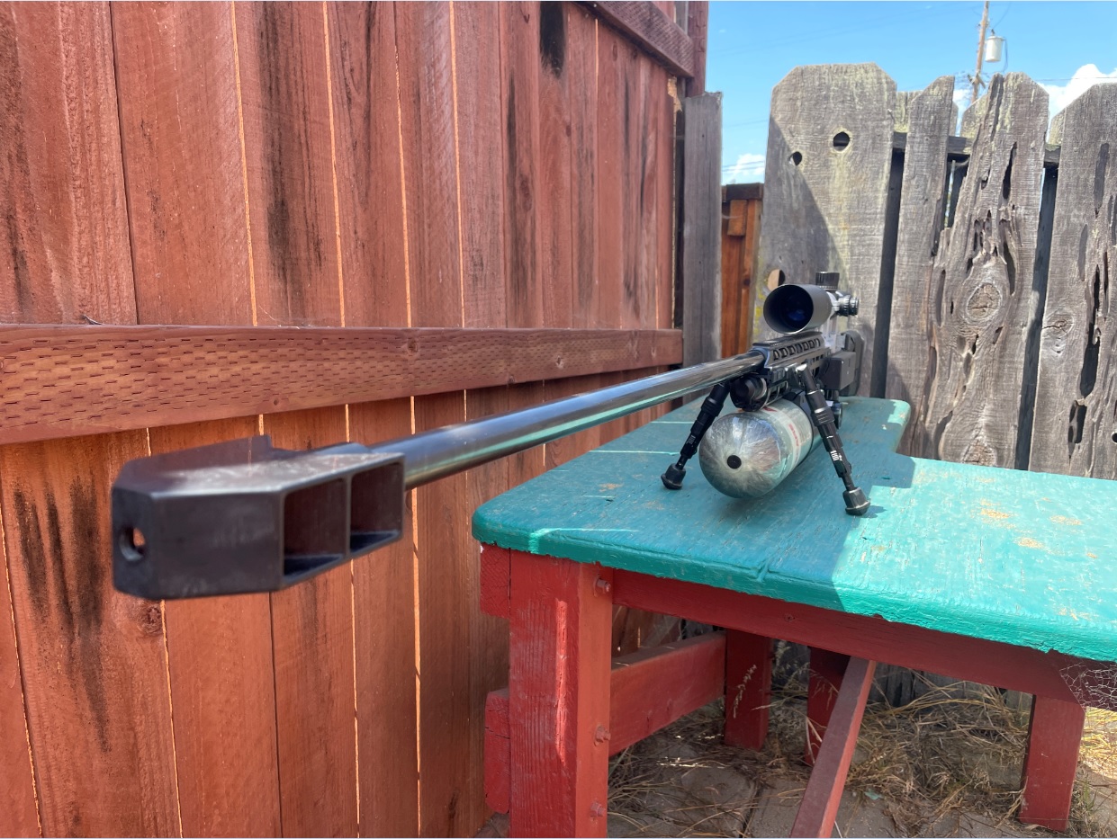

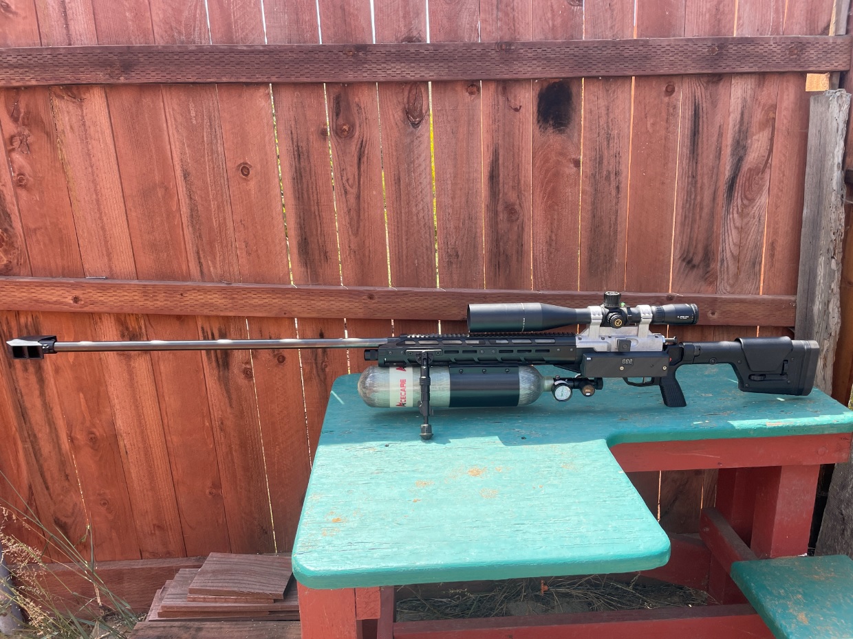

Actually, a rebuild. I had built a .257 ELR air rifle specifically for the ELR Magnum/Bigbore slug matches such as those at RMAC and EBR. It did great, but new rules at EBR necessitated an upgrade. Also, there have been instances where target distances have started to exceed the 300yds that the gun was originally designed for. The .257 was shooting 71gr slugs at 990fps. The “new” 7mm will shoot 100gr slugs at 1020fps. This is intended to be a 400yd rifle. The object being to hit a 4moa target on the first shot encounter at any distance out to 400yds. If this new barrel is as accurate as the .257 barrel, I'll be satisfied.
I wanted something to protect the crown/muzzle. I put the brake on because it looked appropriate. Recoil is not that much. I have yet to see how the brake works. So far I've only shot over the chronograph sans the brake.

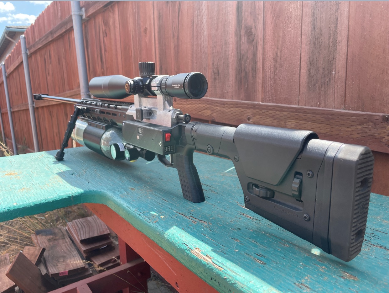

The "electronic doohickey" is the control box for the electronic hammer/solenoid. Sort of like a Daystate, but no computer. Hammer strike is controlled by turning the potentiometer through that hole on the side, using a small screwdriver.

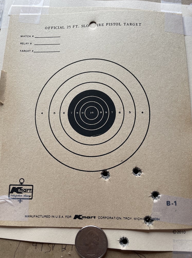

I spent a couple hours at the range yesterday. Tore it down last night to fix/change a few details. I’ve settled on a tune for EBR. Spent three hours at the range today. Currently running regulated at 2650 +/- 50psi. 106gr slugs at 992fps average (230fpe) are looking best so far. About 1.5moa five shot groups on paper at 200m. Not quite as accurate yet as the .257 barrel, but able to hit high power pig silhouettes at 300m for most shots. Even knocked down a couple. Still working on DOPE.

Thanks. A .257 has a 6.5mm groove diameter. A 6.5mm Creedmore has a 6.5mm bore diameter. At 160fpe, the .257 is a great caliber for long range airguns. I needed >200fpe. It's just easier to get there with a bigger bore, so that's why the switch to 7mm.

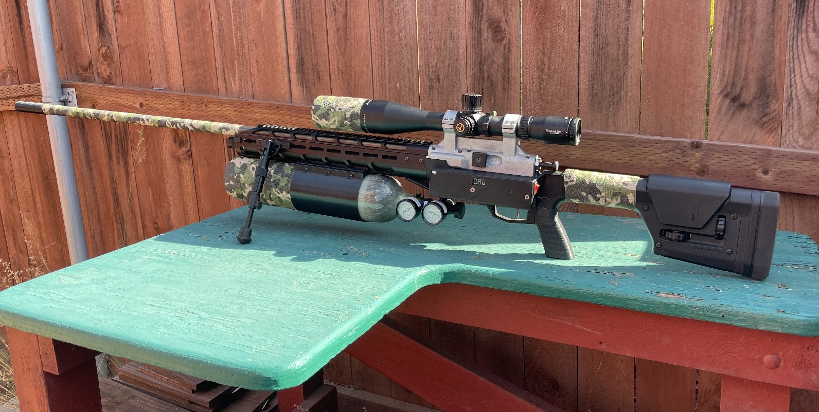

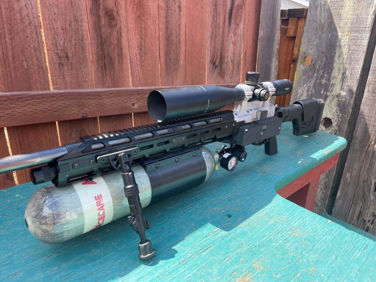

I eliminated the brake, and added some camo accents. I also went back to all analog pressure gauges which are easier to read in the sunlight.

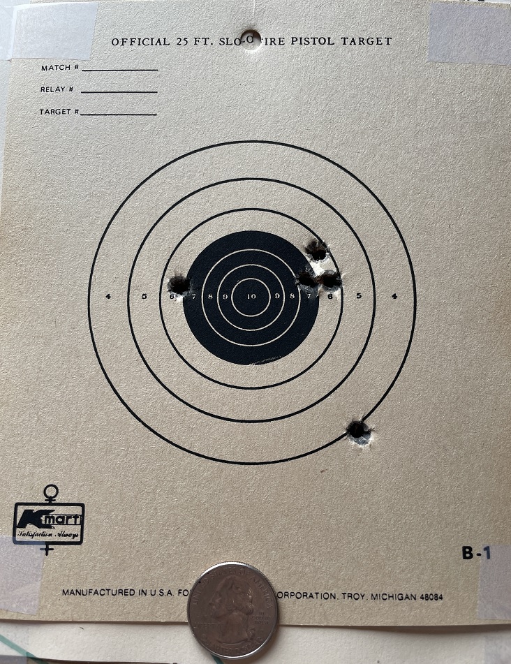

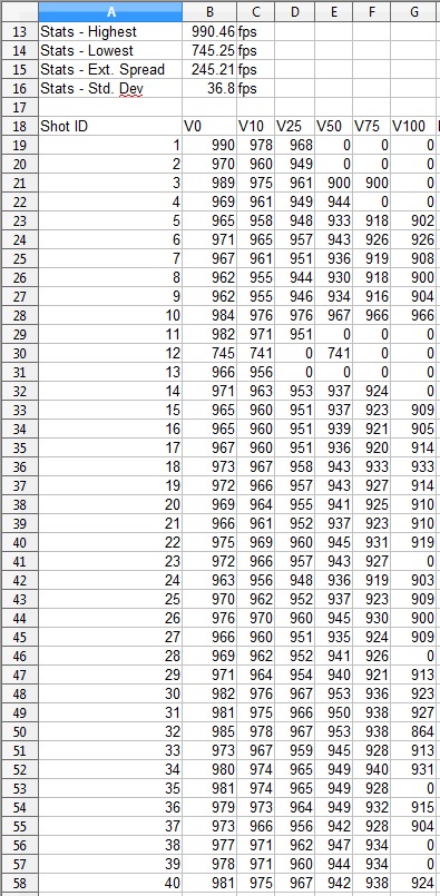

I'm working on getting better BC data for the 106gr slug. I went to the range this morning and had a calm day. I took 40 shots with the 106gr slug, and most registered OK on the Labradar. I shot two five shot groups at 200m. 1st group was barely on paper but under 1moa in diameter. I dialed in another 1moa of elevation and the 2nd group was closer to center and about 1.12moa in diameter. Velocity spread wasn't as bad as shown since the 745fps was a bad reading, but it still could be better.
