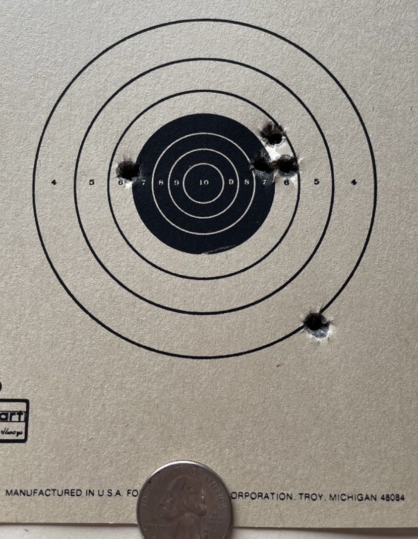

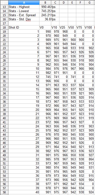

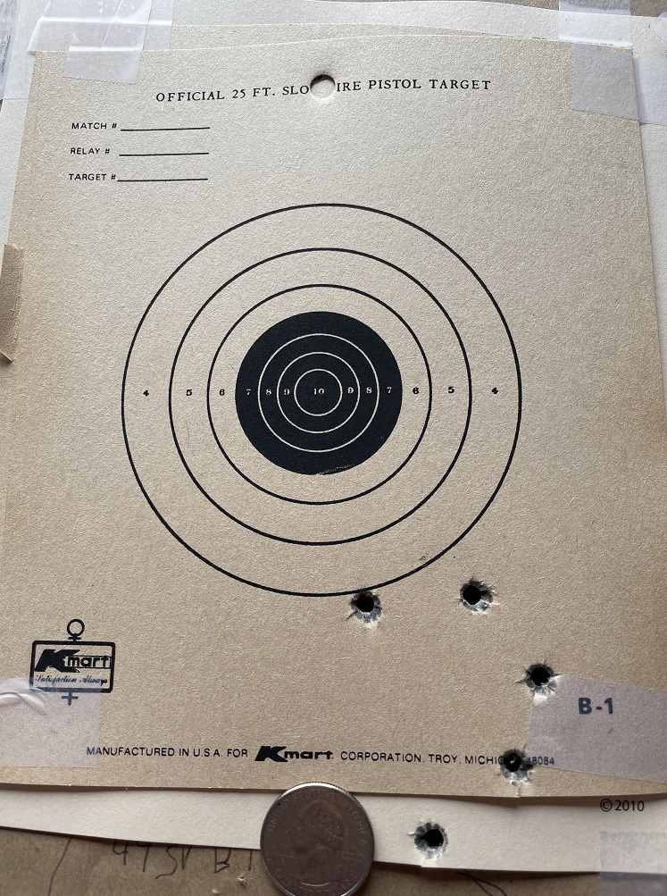

I'm working on getting better BC data for the 106gr slug. I went to the range this morning and had a calm day. I took 40 shots with the 106gr slug, and most registered OK on the Labradar. I shot two five shot groups at 200m. 1st group was barely on paper but under 1moa in diameter. I dialed in another 1moa of elevation and the 2nd group was closer to center and about 1.12moa in diameter. Velocity spread wasn't as bad as shown since the 745fps was a bad reading, but it still could be better.

! That's getting it done!
I bet you’re having a blast shooting that thing. It would be really cool to shoot that in the real world in the wind out to 400 which I know you will do.
I know you’re not into magic groups as much as I am, but when I look at this group I see you one shot away from a magic group…
I’m interested to see how small of a group you can shoot at 300 yards. In great conditions.
That gun is such a hot rod dude!
I love the three bullet Cloverleaf. It says so much about the rifle. That’s not an accident at 200 yards.

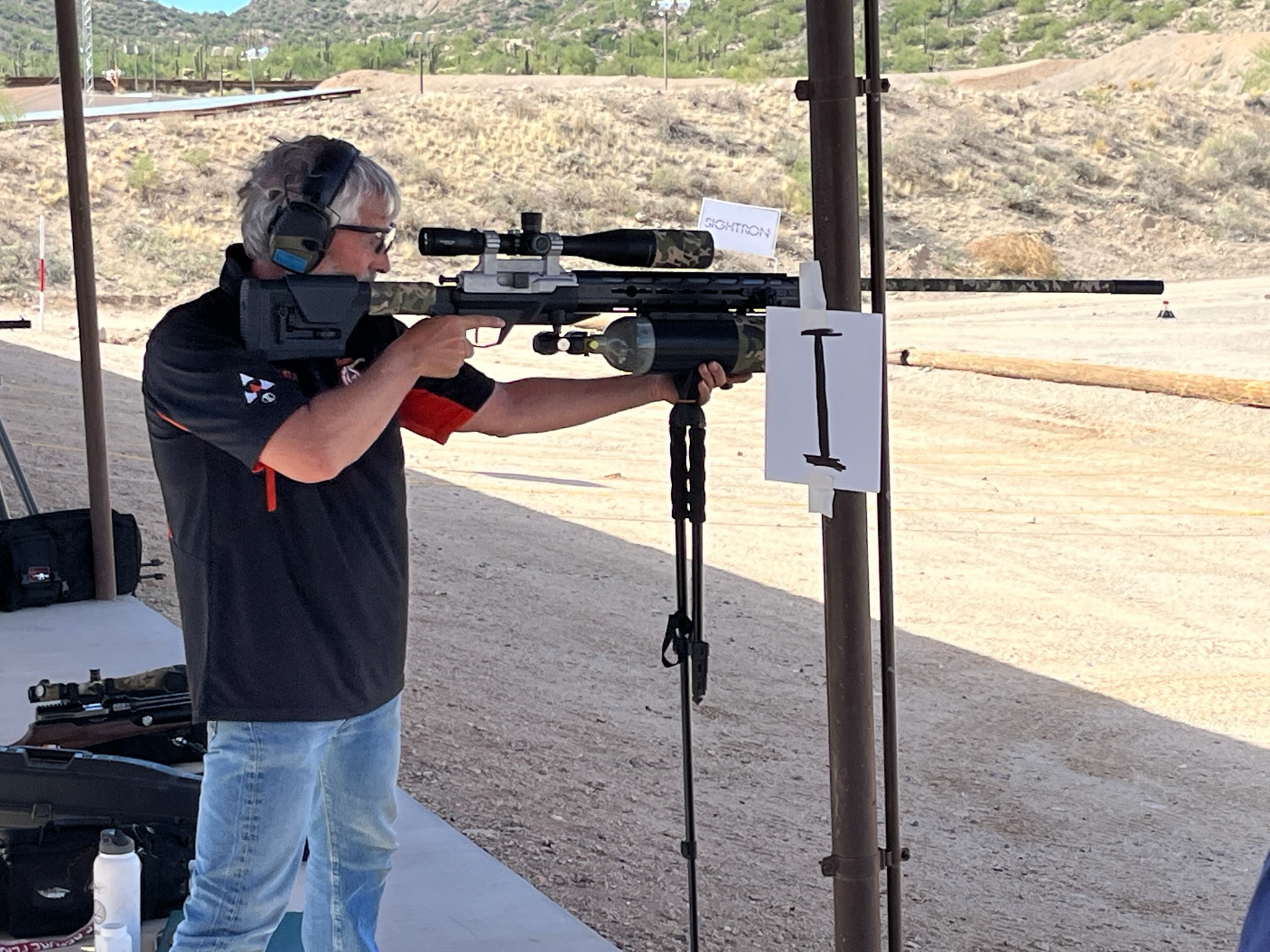

I wanted something to protect the crown/muzzle. I put the brake on because it looked appropriate. Recoil is not that much. I have yet to see how the brake works. So far I've only shot over the chronograph sans the brake.
The "electronic doohickey" is the control box for the electronic hammer/solenoid. Sort of like a Daystate, but no computer. Hammer strike is controlled by turning the potentiometer through that hole on the side, using a small screwdriver.
Good idea leaving out the computer. You have the best parts about an E-rifle without the complicated programming. Cool build!
