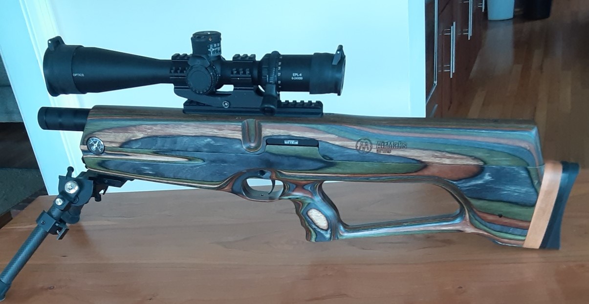

My stock did not fit my action real well either. The forward screw attaching the top part of the stock to the action could not be tightened when I got the gun, it would distort the stock. I #10 washer between the action and the stock solved that. The other issue was the cover over the manometer kept popping off. The top part of the stock was rubbing it a little. The stock is so thin it flexes some and when it did it popped that cover off. I used a drum sander on my drill press to relieve the area of contact and put a little epoxy on the manometer cover. Seems to be fixed.
You will also see that I made a cherry spacer to increase the length of pull. It came at a reasonable 14 inches or a little more but I like closer to 15. So I picked up a scrap piece of cherry off the floor of my shop and made a spacer. I shot the gun from the bench to test pellets without it but it is nice to have it fitting me now. I put the "Uncle Mike's" sling mount I use with my monopod rear rest into the spacer. Space if tight at the back of the stock.
A nice thing about the Caiman is it is reasonably quiet without an added moderator. It comes with several sections of moderator screwed together plus it ends with a 1/2 UNF fitting in the end. When it got to me with the hammer spring max'd out for the regulator setting it was noisy and I put on my Tanto. But when I got the hammer spring more reasonable adjusted it seems significantly quieter and I am just using the stock baffles. I may look into adding a section or two to the stock moderator.
It came with two magazines (which is nice because extras are apparently over $50) and they hold 10 rounds. This keeps them small and they do not bother me at all shooting from my left shoulder. I moved the cocking lever from the left to the right. That was not hard but you have to take off the upper part of the stock. There are instructions for that in the manual. I did not get the air evacuation tool I expected nor is there a plug on the fill port. I have a request into Utah about those parts. They do not seem expensive in the Air Maks web page so even if I have to buy them it is no big deal. Seems like they should be included.

Shooting this is a little nicer than my less expensive guns but isn't really much different. When I am making an adjustment or something I can see it is better machined and is generally well designed and thought through. I am also unsure about velocity variation. I do not see a declining curve of velocity with tank pressure as has been reported but I do see a somewhat high ES. I was measuring velocity as I shot that 30 yard challenge target and I think the ES was about 42 fps. That's worse than my cheap guns by at least a factor of two except for the unregulated Prod. It has a huma regulator so that shouldn't be the issue. I need to watch some videos on the Katran to see what those owners report. It may be that the unique hammer arrangement of air maks guns contributes some to the ES. Or my gun may just be breaking in. I don't think it affects the accuracy at 30 yards but it would if I stretch it out so hopefully it improves. But long range accuracy is much less of a concern to me than accuracy within 50 yards and I don't see the ES as a likely issue within 50 yards.
