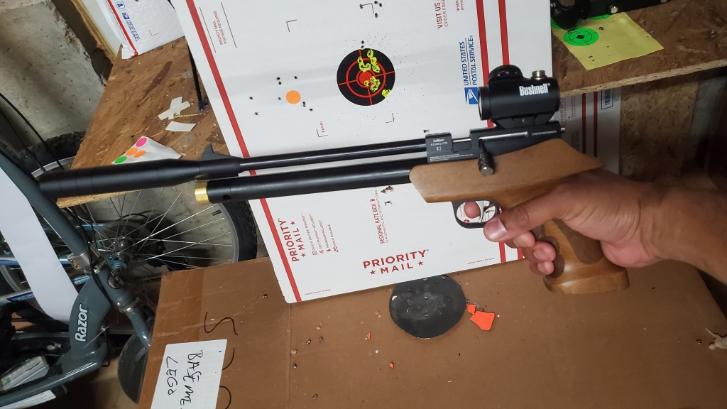

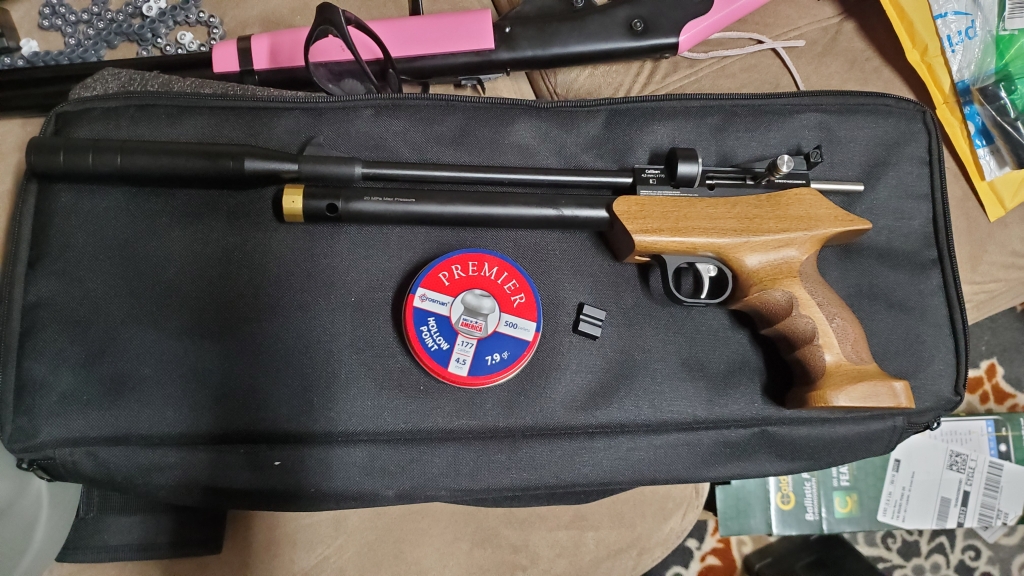

Gun arrived yesterday. Immediately put my red dot on and did a quick zero. Magazine and bolt work flawlessly. Bolt in is a great place for fast follow up shots. Very happy with the purchase. As plenty of people have said, the handle is huge. I wear L or XL gloves so it fits me good enough. I will likely shave down the lower area where my pinky and adjacent fingers are.
My extra mags and regulator just showed up from PA. The barrel bands are on preorder and I definitely need one mainly because I'm not gentle with my guns.

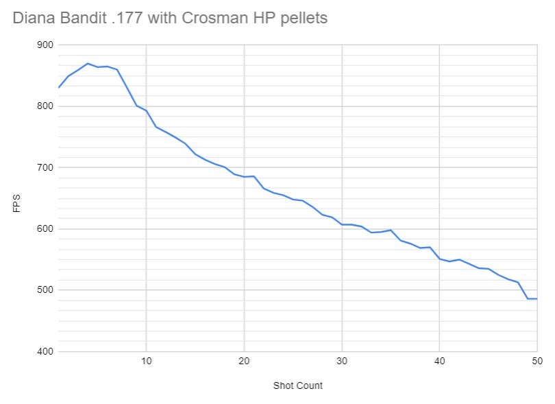

FPE ranged from a max of 6.87 down to 3.84 before at the 50th shot.
That shot string looks to be perfectly normal for that pistol. Looks like you're into accuracy so good thing you bought a regulator for it. The barrel and magazines may be the limiting factor though.

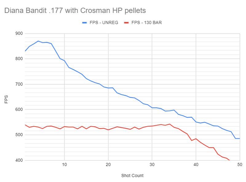

My pistol shot similarly when I got it. I installed the reg in about 5 min and it flattened my shot curve completely. I lowered the pressure on the reg to shoot two full mags for 8 g pellets before it falls off the reg. I get about 8 ftlbs per shot.

Added the regulator. Had to adjust it several times to get it right. The chart included is way off for my pellets so I had to set it a lot higher than expected.
The reg is definitely doing its job. The reg takes up volume in the tank which leads to less shots but I've read that I can pump in more pressure now that I have a regulator and that will get the shot count back up.
