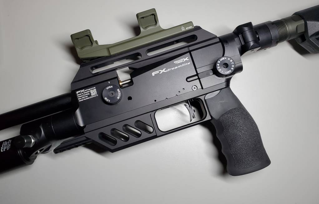

My new Dream-Tac Compact .177 backyard multishot plinker

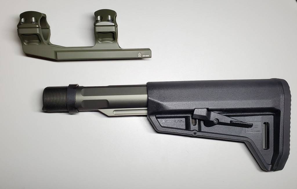

I'm going to put on the Vector Optics Veyron FFP scope with a Magpul stock.
I will report back with the weight. Thanks
