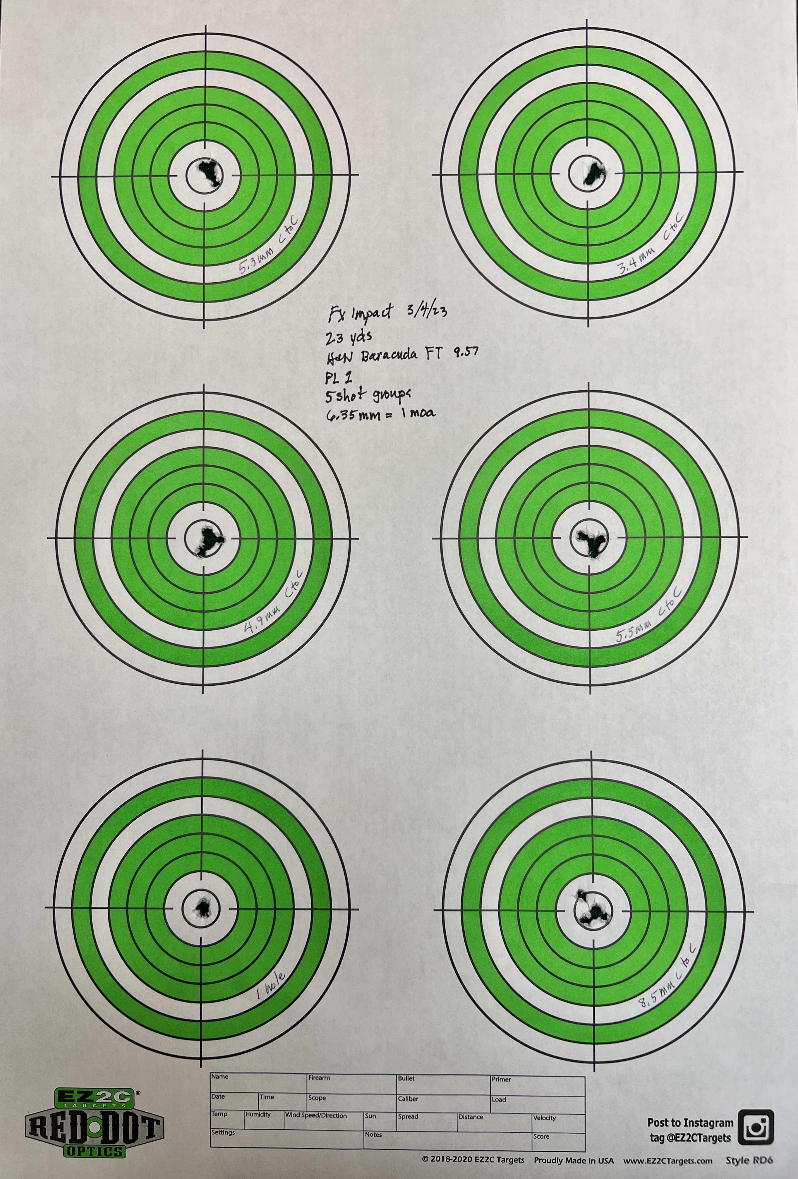

Took the new Impact I bought for my birthday to the indoor range today to shoot as close to 25 yards as possible. I got 23 yards. The rifle is setup for JSB 13.43 redesigns at PL8 shooting 870fps and 10 grainers at PL 1 at 850. I also tried my trusty H&N Baracuda FT 9.57 pellets that do so well in the HW44. Well, the winner of this shoot off was the Baracudas with all sub-moa groups and one one-hole group.

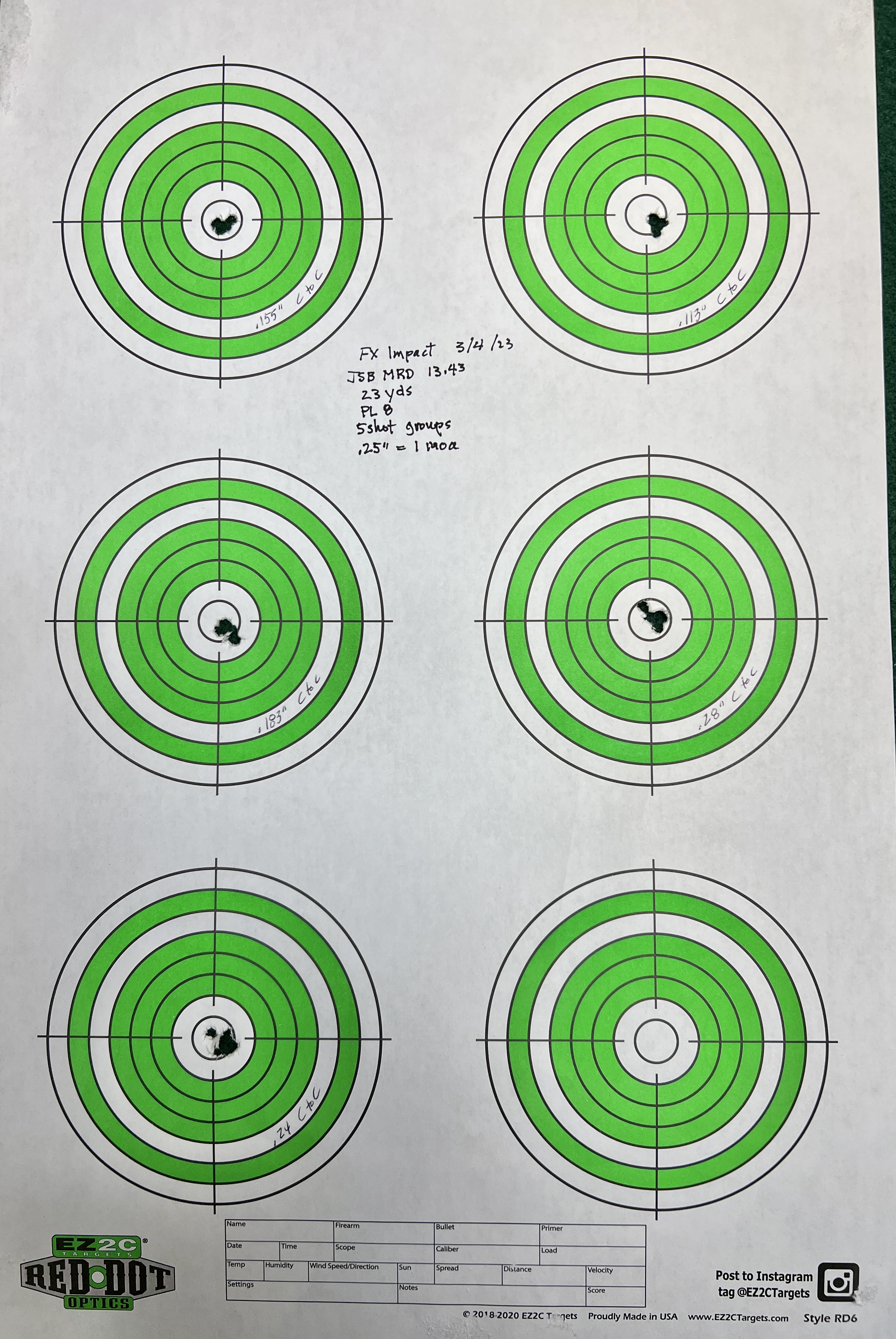

The JSBs did respectable as well. These are actually the pellet I intend to shoot regularly. Best group .113” Center to Center. The largest was right around moa. Keep in mind these are the first tins of pellets shot at targets. Previous shots were for tuning only and with a filthy dirty barrel. I'm thinking this gun'll shoot!

I tried the FX 13.4 and the Jsb 10.34 and they were ok. The Baracudas shoot so much better for me. Yes, Superior liner - 600mm. Think if I sort the FX and JSB 10 grainers they might be more consistent. They shot several fliers as opposed to the JSB redesigns or the Baracudas.

I didn't think I would even try the H&Ns past 10 meter, but obviously they did well at 25 yards. I bought this gun for 25 yards, so that's its home for now. I usually head size and lube pellets, but these were shot straight from tin. I have a bunch on the way that I will sort and lube.
