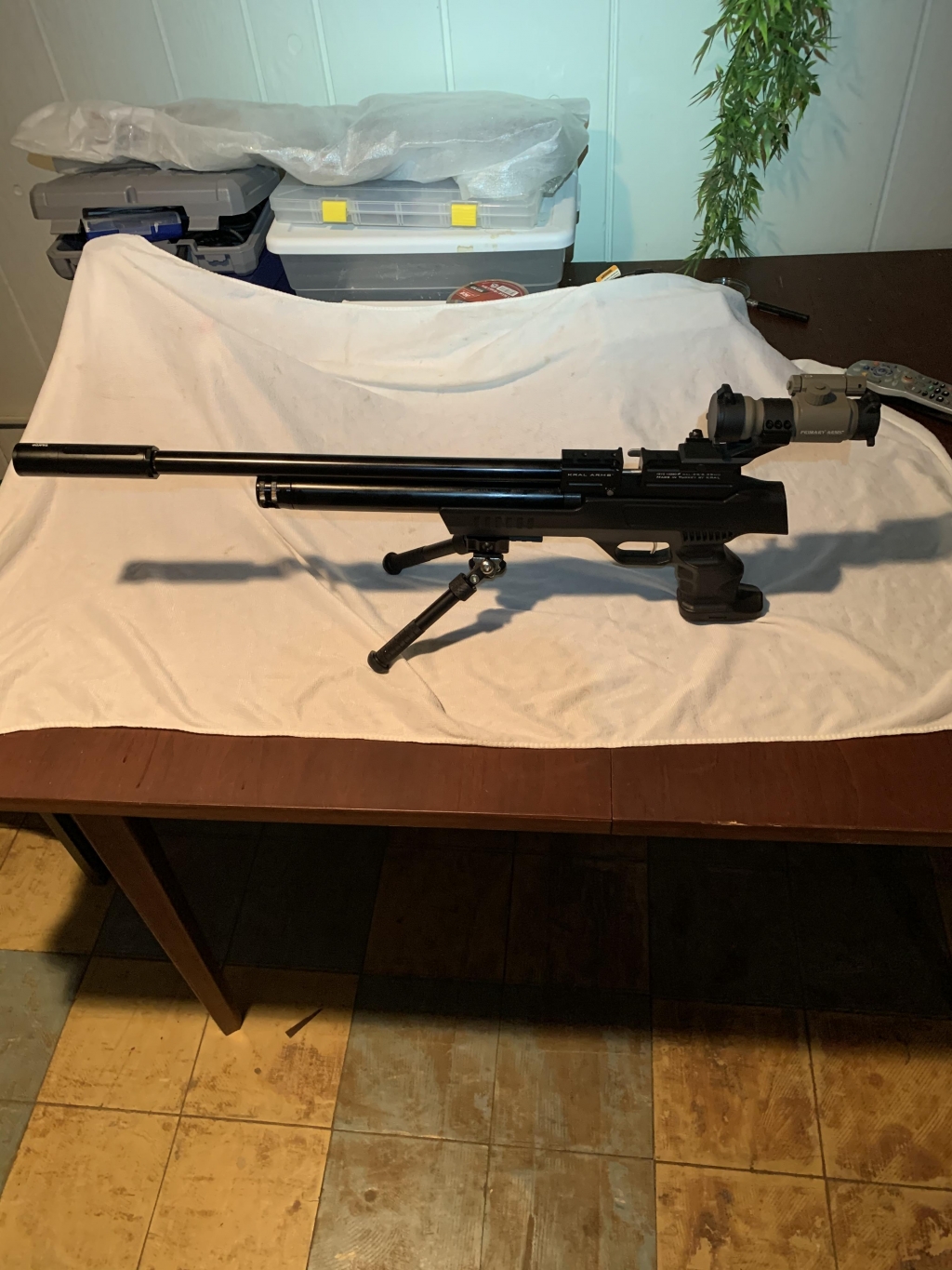

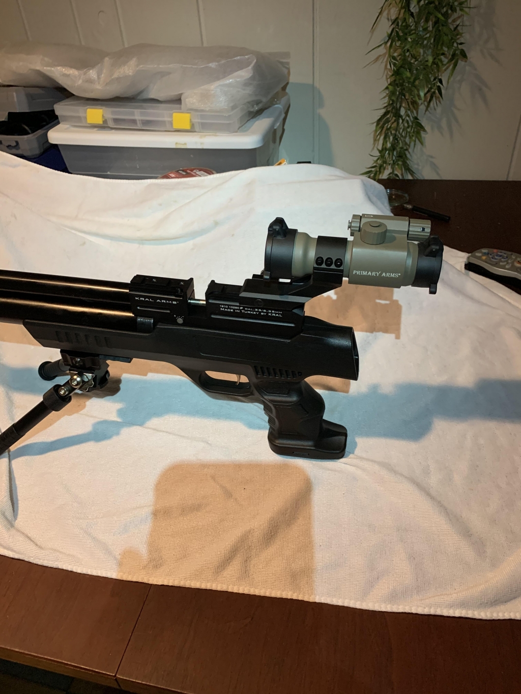

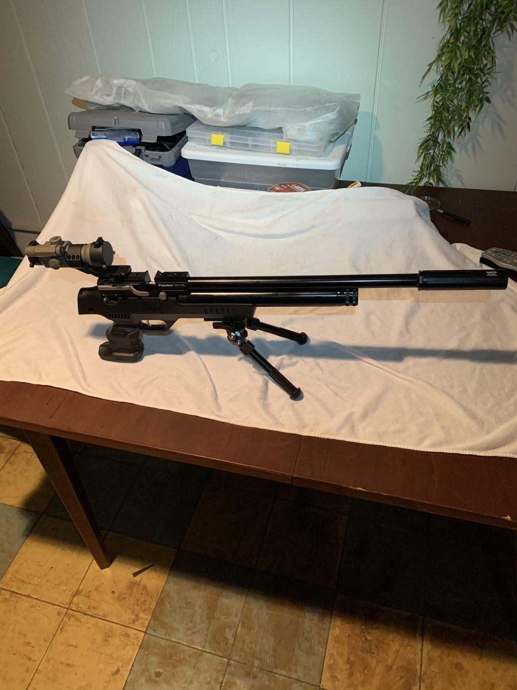

Just some eye candy. No i have not shot it yet as in came in LATE today. pulled the back stock , threw on a primary arms red dot with big eye relief. and capped it with a donnyfl tanto.
update shot count / power high 20 shots 739 fps-654 fps 30-23 FPE , medium 25 shots 623 fps-572 fps 21-16 FPE , low 40 shots 437 fps-406 fps 11-9 FPE out of the box.
marflow , mikeVV, Bravo1956, i appreciate your perspectives. obviously , this is not a true pistol. that was why i put it in "quotations" it's really a backpack gun that's been pistolized. , it's 28" long with the mod. but fairly light. i will post groups shot with 2 hands , shooting freehand. i could not even hold an HW44 steady with one hand. and this guy is for pesting close quarters , as all my guns are. i was never a 10 yard target shooter. I was looking for a "pistol " in 25 cal. repeater , with approx 25 FPE level. The HW44 , which i liked a lot, was about 19" with the mod. 22 cal was about 17 FPE. Steve Scalli shot it with a bipod to maximize accuracy at distance as i would do to shoot target , or ethically pest. I admit ,this gun is a tweener , i was not sure to list it in pistol or rifle section. certainly not trying to mock traditional pistol shooters.

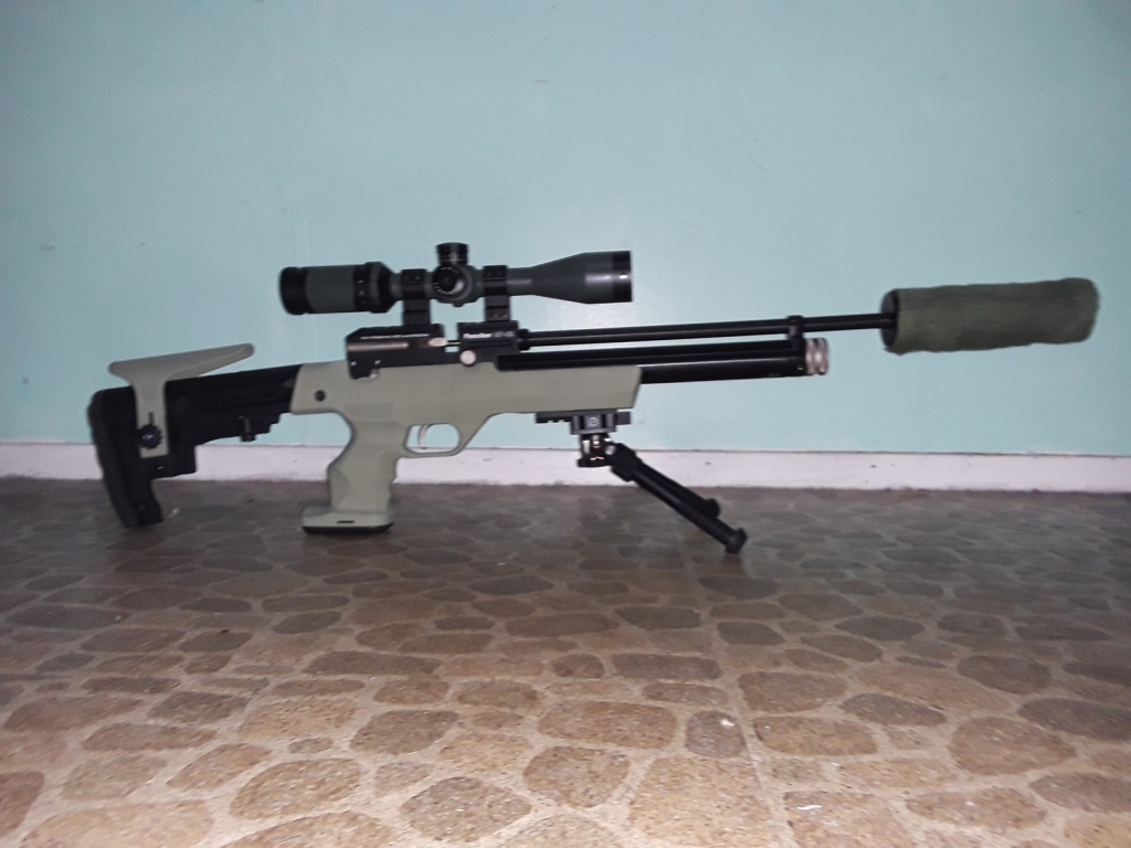

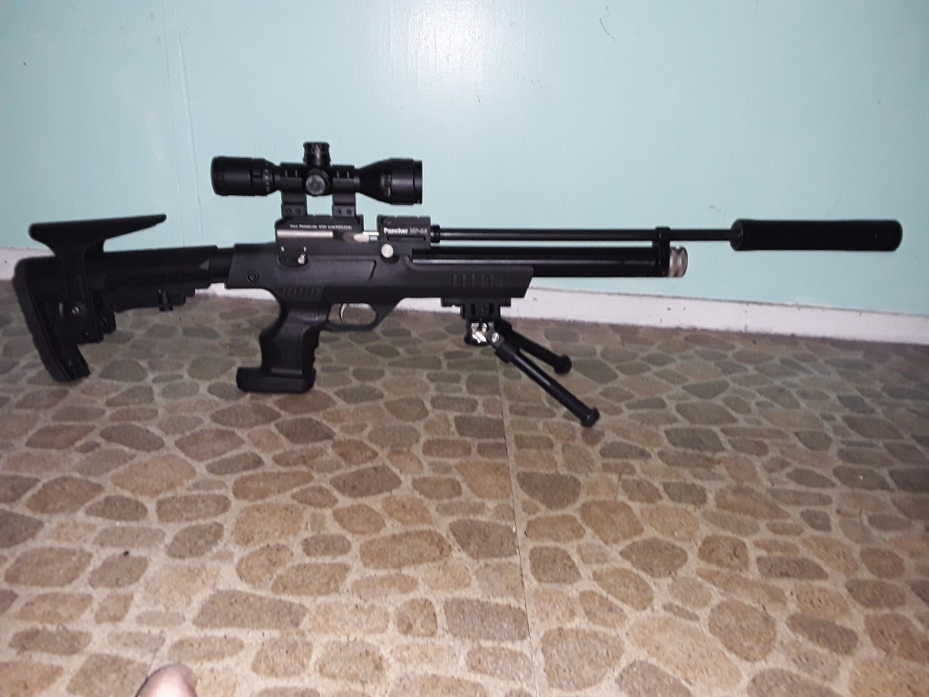

Mine came in today. Removed shroud to clean barrel real good. Had a barrel band so used it and kept shroud off for now, fill port cover from puncher breaker.
Trident moderator, bugbuster, high rings for now, but will order offset mount I think.
Like the way it feels, and while single hand pistol shooting isn't going to happen, when I removed the shoulder stock and fired a few shots, it balances pretty well, it's going to be fun shooting like this.
