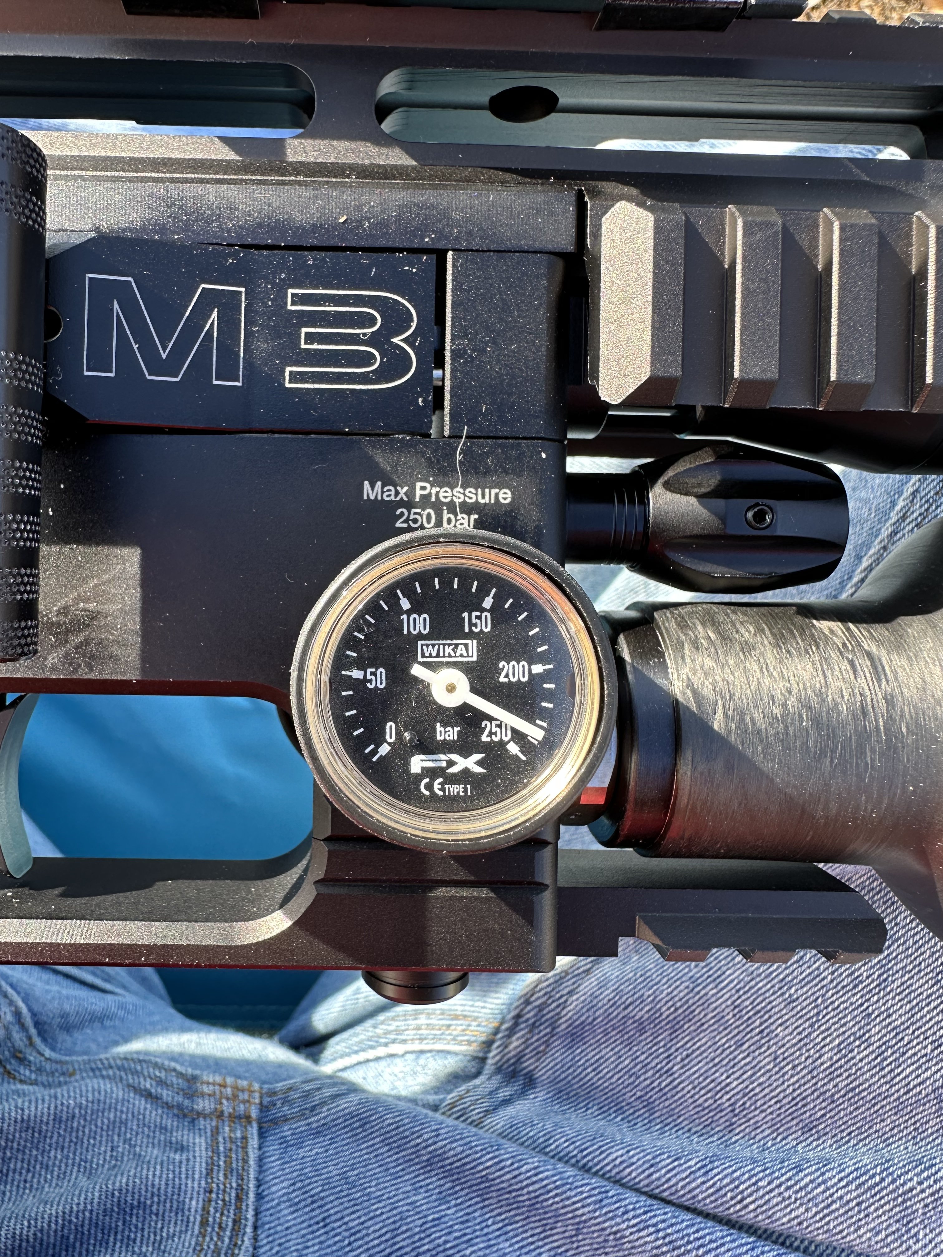

I am liking my new M3 with 700mm .22 and 580cc bottle (well was 580, just installed 700). Tuned it to shoot cphp at 880fps and 10 mags it took 130 bar, 235 down to 105, that is 280 shots. cphp do great out to about 40 yards but they start to open at 50. Put some 15.89 jsb in without changing anything and 5 shots were touching at 50 so I know it is the cphp not doing as good for that distance. I will play with it more and see if I can get them better, but I am pretty happy with them for $7 per 500.

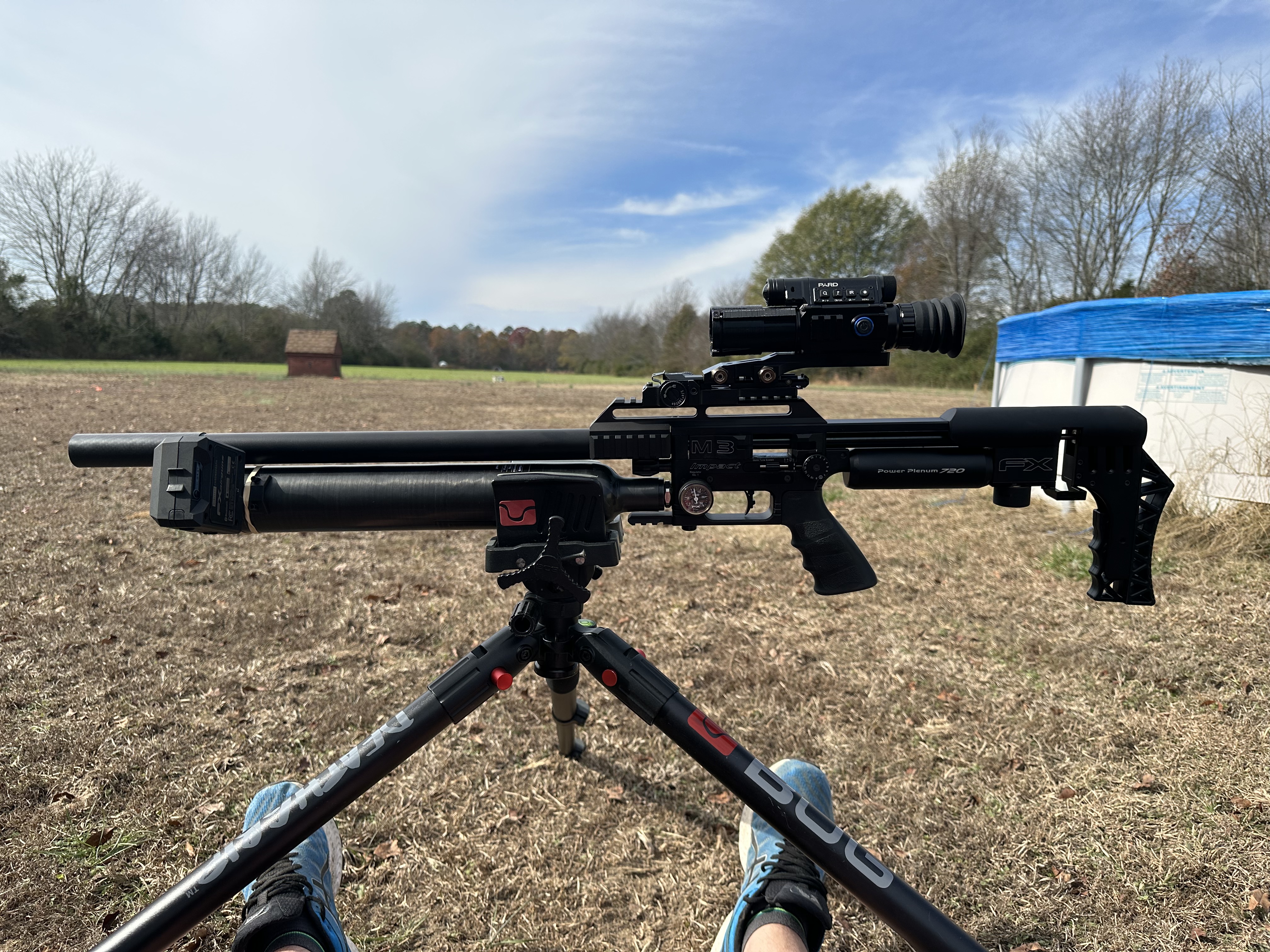

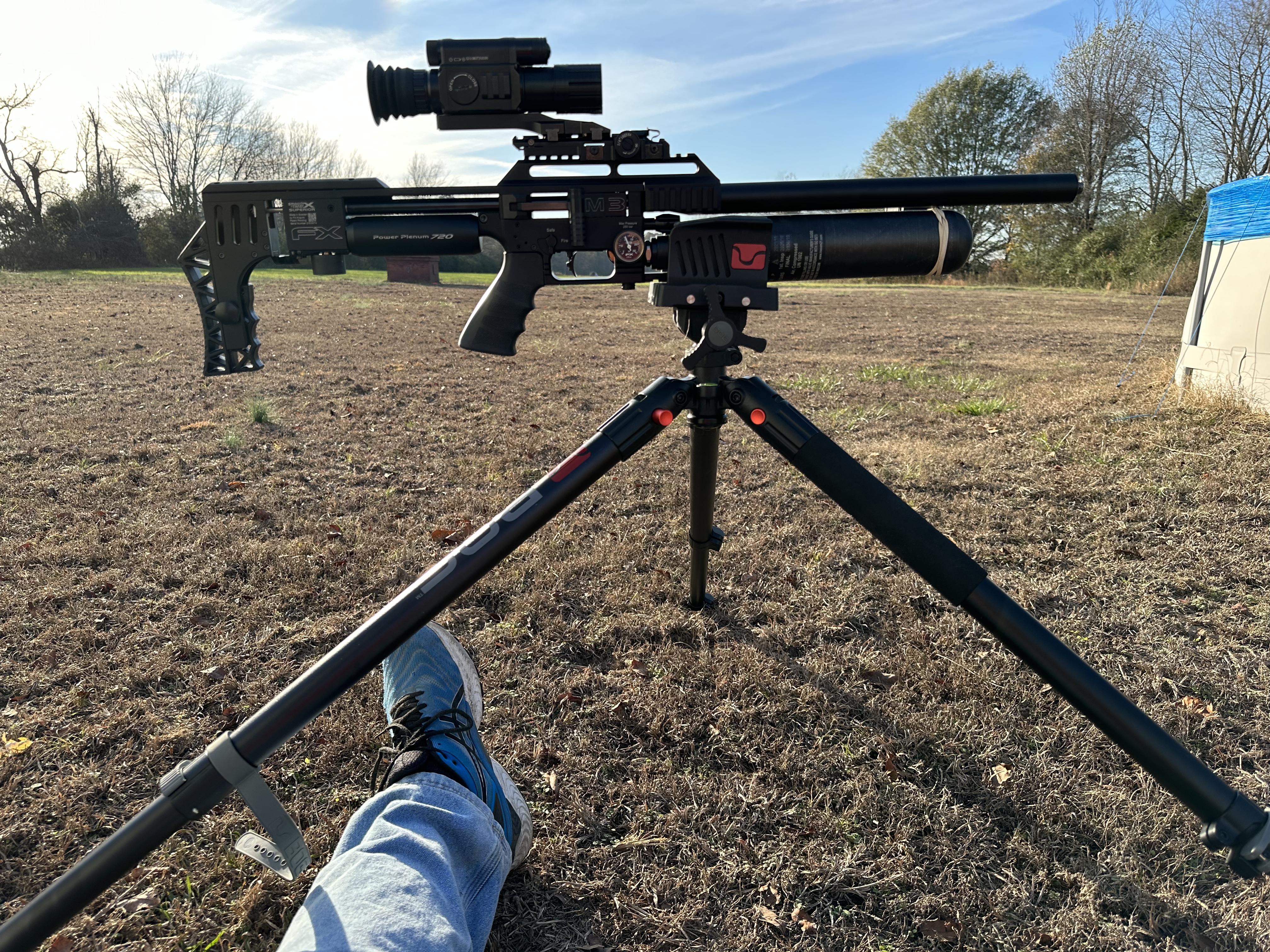

Reg at 150 first and 100 second
Micro on the 2
Macro on 1
Valve on line 4
Might play with reg later but want to see how it does with the 700mm .177 barrel first.
Ready to see how many shots the 700cc bottle gets. Hopefully that will be tomorrow. It looks nice with 700mm barrel.

Currently shooting 18.13s at 770 and using about 10 bar per magazine. That would be 17 mags or 476 shots from 250 to 80 bar. Not as accurate as higher speeds but I think my compressor is going out (would not get above 2800psi yesterday when outside in 55 degree temps, took it inside where it was warmer and it had no problem hitting 3600psi) so I am ok with decent accuracy and high shot count for now.

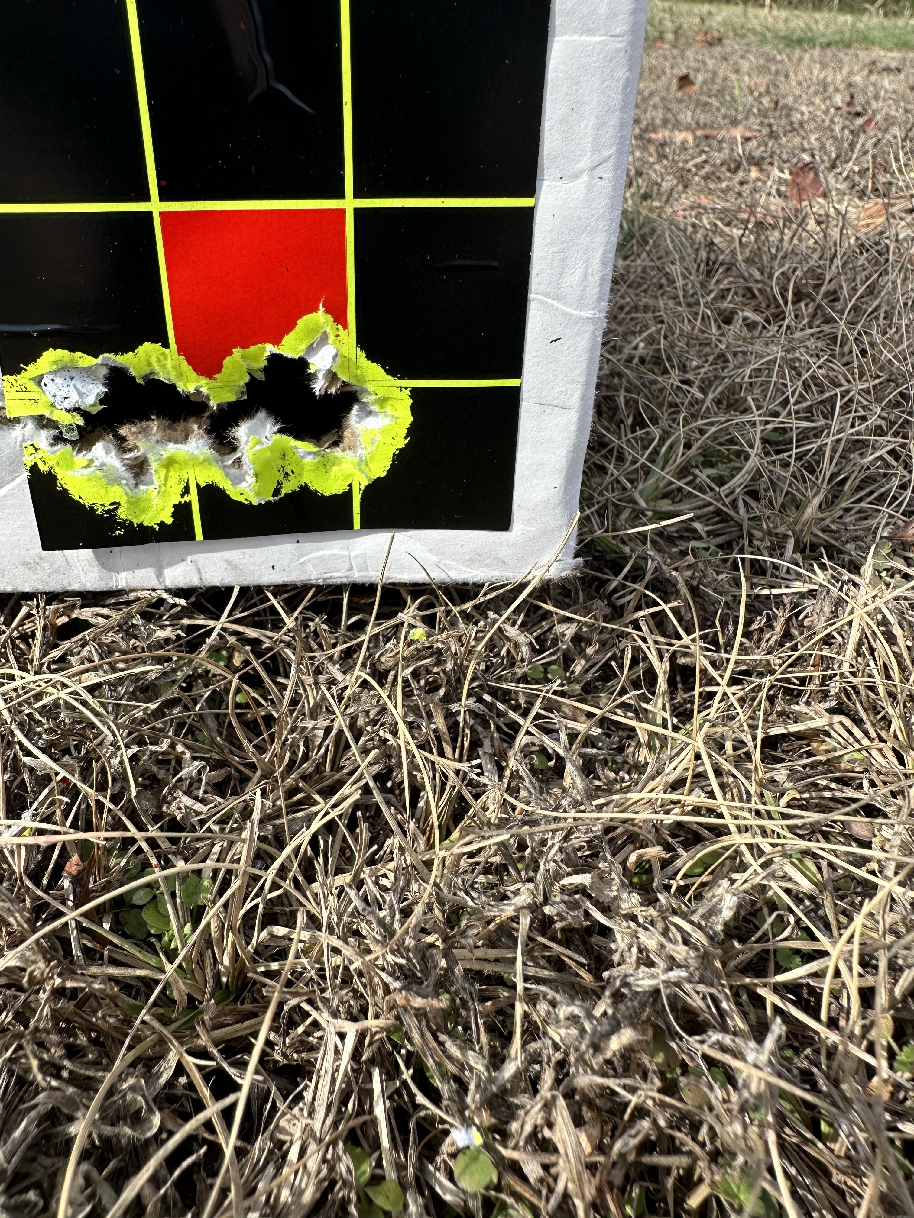

Below pictures are two groups, left one is 2+ mags and right one is 1 mag. Other picture is about 14 yards behind my target. Wind gusts up to 19mph so that is not really helping the groups.
