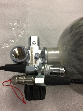

I have the 75 Cubic Foot Omega air cylinder with an HP3 “upgraded” valve. They said it was an upgrade and would make things easier. The picture below shows the tank and the hose it came with. I have two questions:
  1. I think they gave me the wrong hose attachment. How do I fill my FX-Impact with this equipment? I can easily fill my Impact direct from my Omega Turbo Compressor because the compressor hose has a female foster fitting that would go directly into my Impact. Five minutes into the video below, he shows how to fill a rifle using the upgraded HP3 valve, but the hose he uses has a female foster fitting on both ends. One side of the hose he uses in the video snaps over the male foster fitting on the tank, with the other side going into the gun. I think they forgot to send me a hose with a female foster fitting on each end. From the picture, I think they gave me a “DIN” hose system right?
  2. Is the brass fitting the bleed valve?

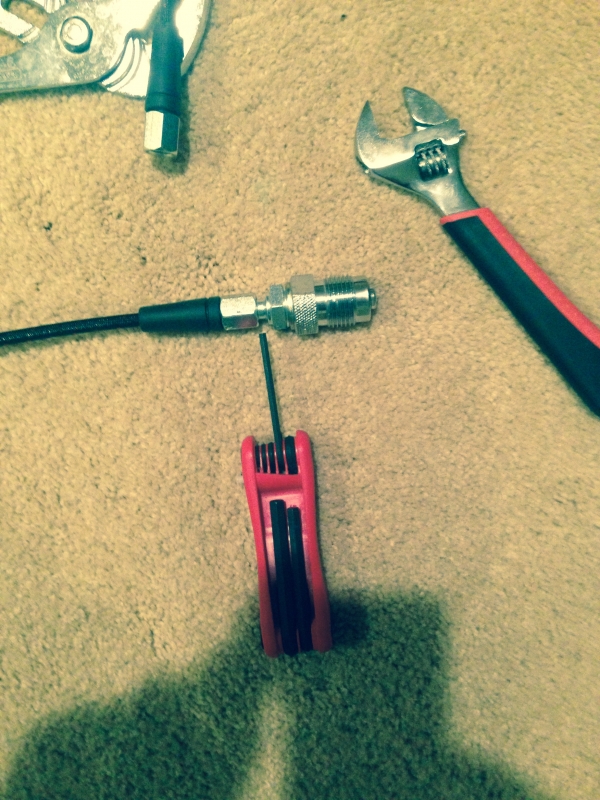

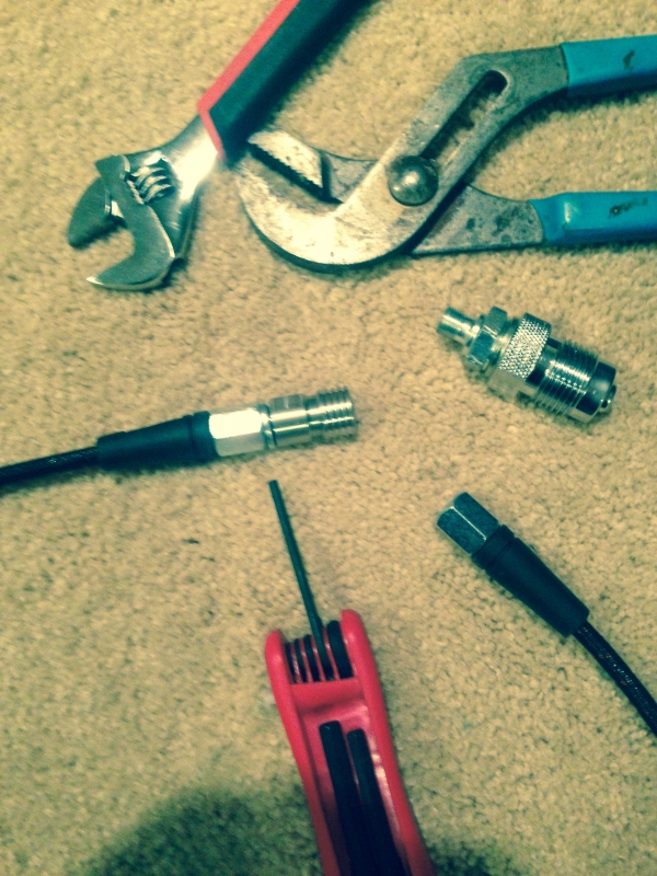

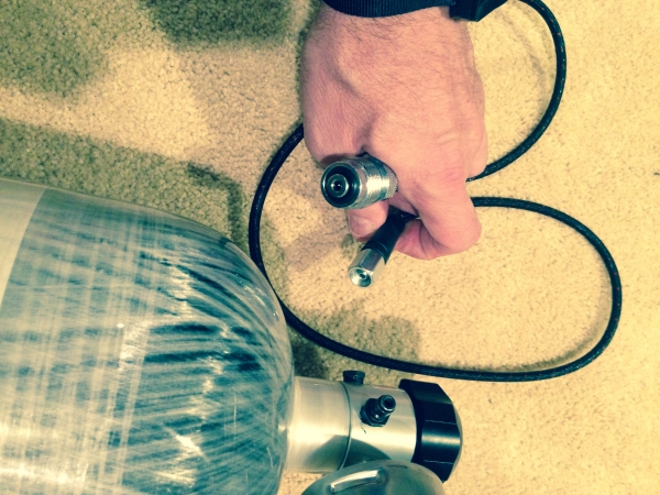

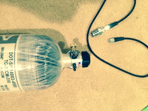

I spoke with AOA today and they are taking care of the issue by sending me another foster fitting. They told me to remove the DIN fitting and replace that with the foster fitting that came with my FX-Impact. I was not sure where to unloosen the DIN fitting but one look at the foster fitting that would be replacing the DIN it became apparent where the removal point was. I have my hex pointing where I unscrewed the DIN. Once that was off, I screwed the foster on. But how tight? Using the tools pictured, I applied as much pressure as possible while still being prudent. When I had removed the DIN fitting, I found that there was a ball and socket fitting just like the one on the other side. I tightened the foster from the Impact on hard because this will be my dedicated hose from my tank to my rifle.
