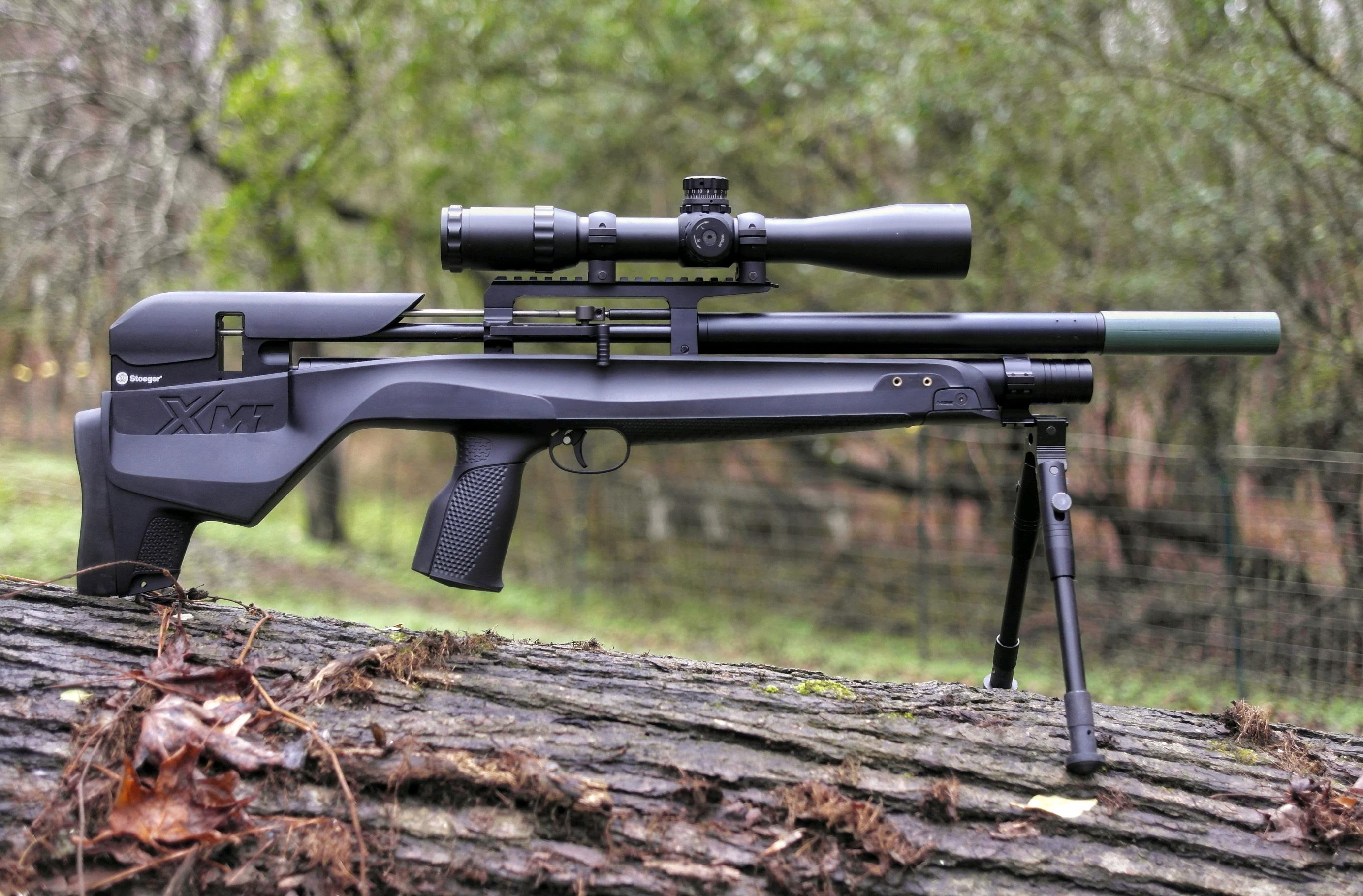

My new P35
"Subscriber" designed the moderators and referenced me to another member who 3D printed them. I paid the guy who printed them a small fee approximating his cost of the materials he used. If you want one and subscriber is unresponsive I will try to find information on who printed them.
If you can find me someone who can print them that would be awesome. Just shoot me a dm or post here, thanks.
I'm just trying to get some pellets through this P35 to wear it in. I had time for 2 10 rnd mags today before dark. I'm just shooting the 25gr snowpeaks at 20 yards. It's zeroed for 34gr FX pellets, I have it ready just in case a rodent stops by. My Yong Heng pressure gauge decided to give up the ghost today, so I wasn't able to fill it up. I was shocked with the 5 round group in there. I wasn't taking a lot of time with each shot.
