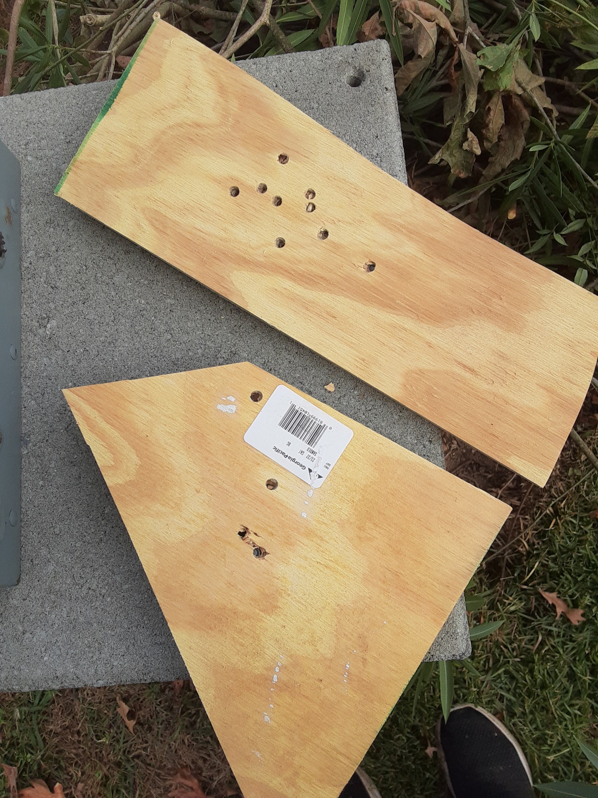

I think I am done modifying my P35-25 except for probably a new wood stock. It has the first one I made of softwood and I can do better. But it works. The light in the picture is not great to reveal detail but the plenum extension is installed and with my in shroud moderator the shroud was still a little shorter than the air tube. But I put in my DonnyFL adapter for a moderator and that made it slightly longer. I did the same thing with a short hair curler and a couple baffles. I also included pictures of some 3/4 plywood scraps I shot at 25 yards. Nielsen 26.8 grain slugs, 31 grain Baracudas and JSB 33.95 grain all went through. Any should go through a skull of a fairly large animal. Accuracy is still so-so. I shot one 5 shot group at 30 yards that was about .15 center to center with the Nielsen slugs but I could not replicate it. Most were 1/2 inch or bigger. I had a very limited supply of pellets but MK1 JSBs seemed to shoot the best, probably better than the slugs. I ordered more to make sure. I'm still hoping Krale delivers the new barrel I bought from them in April. My phone sound app says the noise it makes is about 80 db at my shooting bench. Likely a little louder in front of the muzzle. Sounds quieter than the pellet hitting the trap, however.

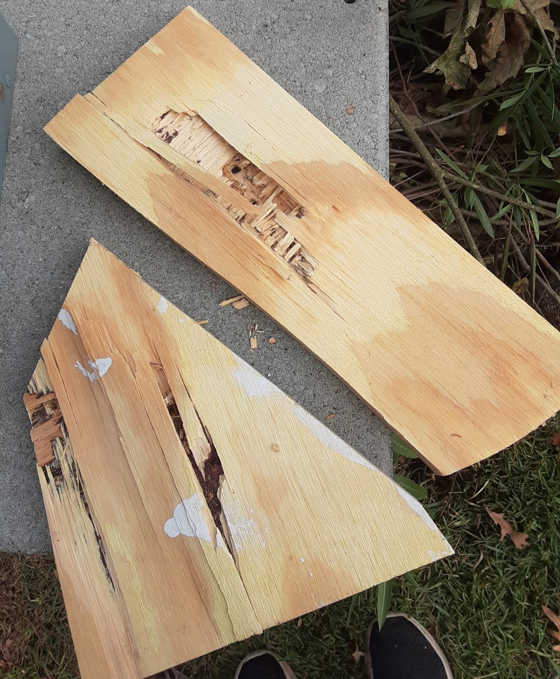

My final fpe is a little over 43 fpe with slugs and about 48 fpe with heavy pellets. Not quite the 50 target I had but close enough, I think. I tested penetration of these projectiles and a few others today in wet paper. The Nielsens expanded but that cut their penetration to almost exactly the same as 14.66 grain FTTs out of my Prod. That's my minimum penetration standard. So they would work but would rarely exit a squirrel. Would make big holes but .25 holes drop them very quickly. The Heavy pellets went about 50% further. That is more what I want, I think. Enough penetration they should kill a racoon pretty well with a well placed shot. My hammer spring is almost max'd out with the brass shim that came with the plenum extension. I had to adjust the regulator to eliminate a first-shot-low issue with my first increased setting. I think it is now about 135bar. The hammer spring is just below the point that gives me maximum velocity. I lost less than 1 fpe turning it down and it cocks better and seems a bit more accurate. I may play with this a little more when my pellet order shows up. My prior tunes of this gun and my two other P35s results in increase velocity as the gun comes off the plenum. That does not happen with this tune on this gun. It just slowly decreases. I did not do a full shot string but did several strings of 20 shots or more while monitoring the pressure. From that I calculate I will get 43 shots from a full charge. The ES over 20 shots or so is consistently about 7 fps. Seems like a pretty good tune.
The poppet diameter change Mike recommends still seems interesting but I think I will mess with other things, at least for now. I'm pretty happy with my almost 50 fpe P35. Maybe it will get to 50 next summer but I doubt any target will be able to tell the difference. The 33.95 grain pellets are going just below 800 fps but I looked at the trajectory and I think it's flat enough. Their BC is almost as good as the Nielsen 36.8 slugs. Baracudas go faster and are almost exactly the same fpe but so far it looks like the JSBs are more accurate.
Reactions: Florida_Man

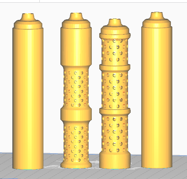

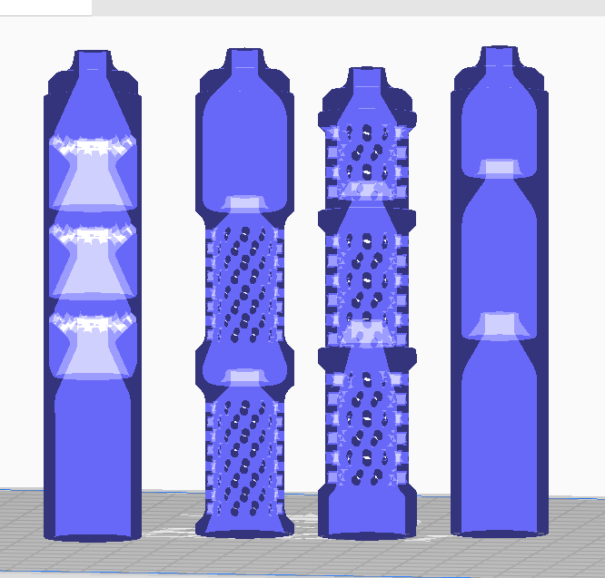

Getting them quiet… still a work in progress. Subscriber made some designs for me. In shroud you don’t have a lot of volume/length to work with. His designs that had a section that extended beyond the end of the shroud worked best.
I wound up buying a 30/28mm OD/ID CF tube ($30 on Amazon for two 500mm long). I used it to make a longer shroud. Since the application was custom and I didn’t want to monopolize Subscribers pro bono design work I’ve been fusing bits of his design and my own. My P15 in .25 is shooting JSB Kings at 880fps The .25 pellet whizzing through the air and impact are now more obvious than the shot itself. It is now much more pleasant sounding than my .22 (which also saw lots of experimentation in this regard).
(Lots of amusing failures along the way in silencer development. Most good ideas aren’t easily realized. Stupid hair curler/fender washer style designs are surprisingly effective. And if you can live with longer, it’s easier to get quieter.)
