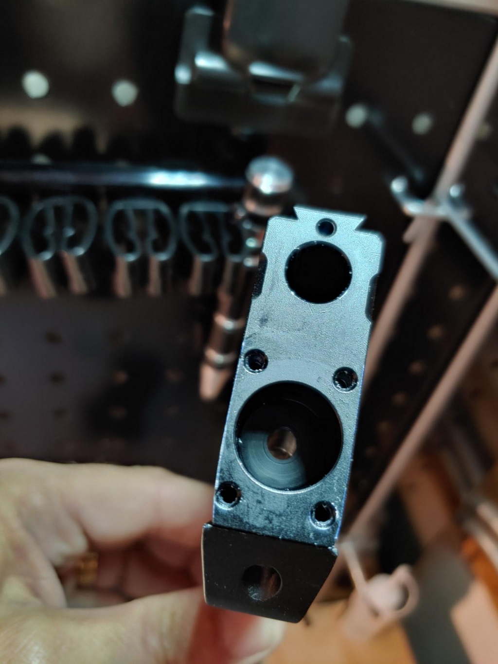

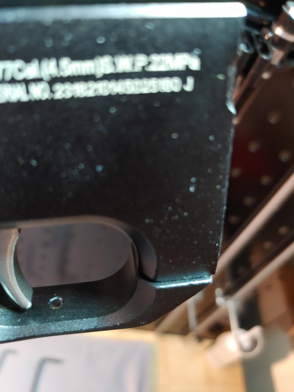

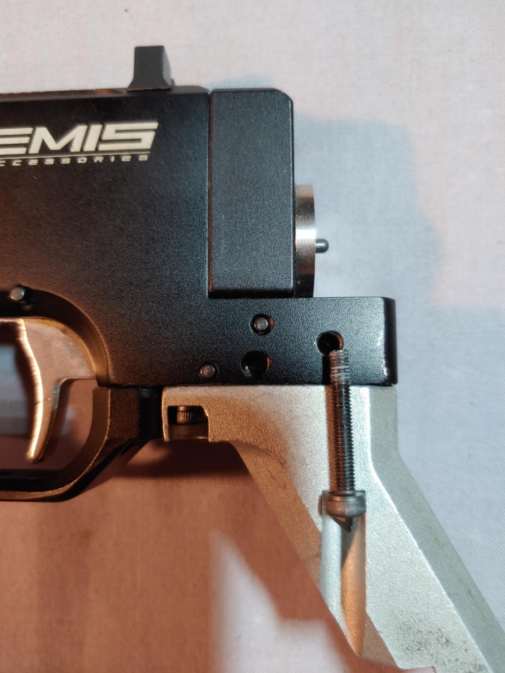

Sir a brief on what was found upon inspection of your .177 PP700SA sent to Veradium for tuning, My inspection.
Upon Inspection of the .177 I determined it was not suitable for use. Reason as follows
1.HammerSpring mount screw was to long had broken thru to hammer pin forcing up and damaging pin hole. Hammer was being forced to the right and rubbing the right grip guard, Hammer was striking valve off center. Thread holes for opposite screw were stripped.
2. Pistol body had significant less metal on the right side of the pistol, regulator screw had broken thru at top of hole exposing threads. Regulator could not be properly secured to body.
Regulator missing 3 belville washers.
3. Signs of moisture being introduced into air tank.
As we discussed for your safety, the pistol should no longer be in use. As I hate delivering bad news, I decided to perform the original tune but upgraded you to a PP700SA .22cal.

How"s that for customer service?? I'll try and post the pictures he texted me.
