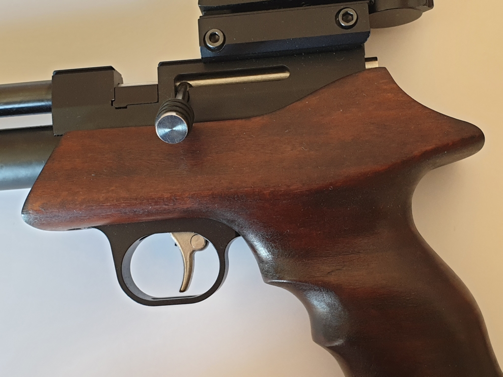

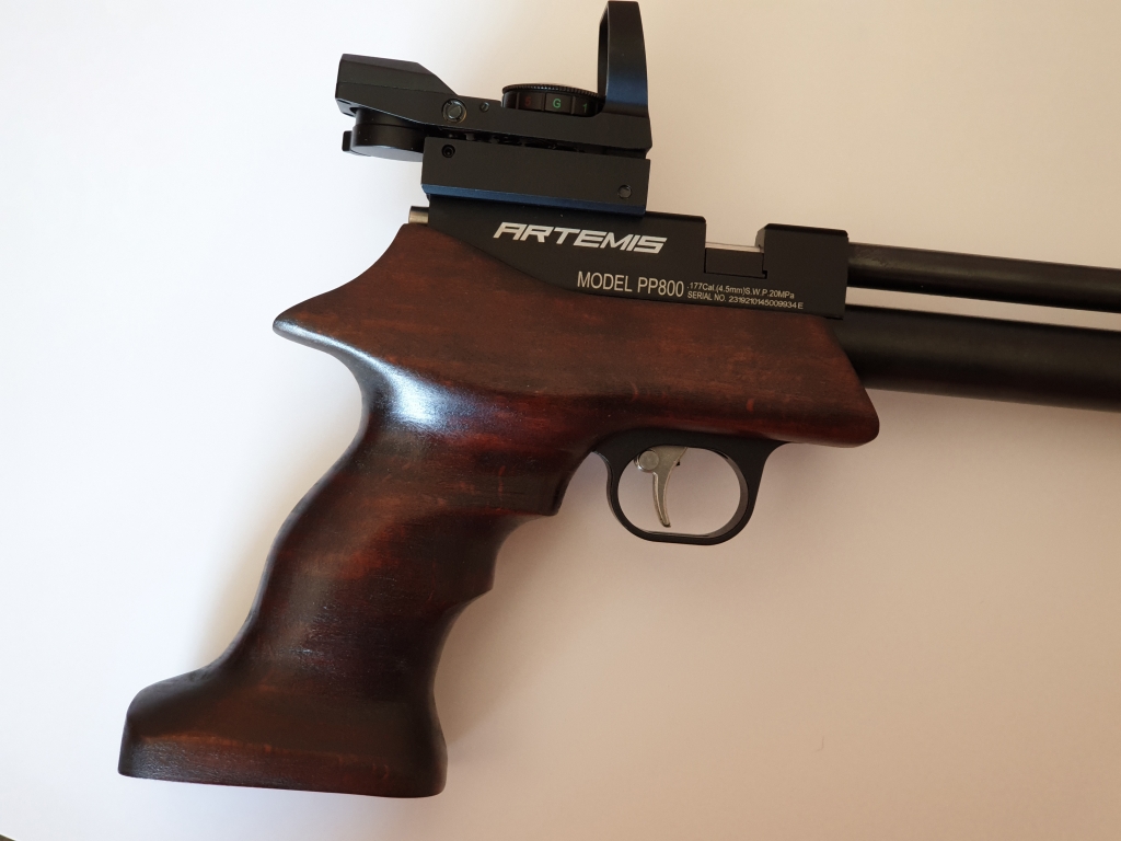

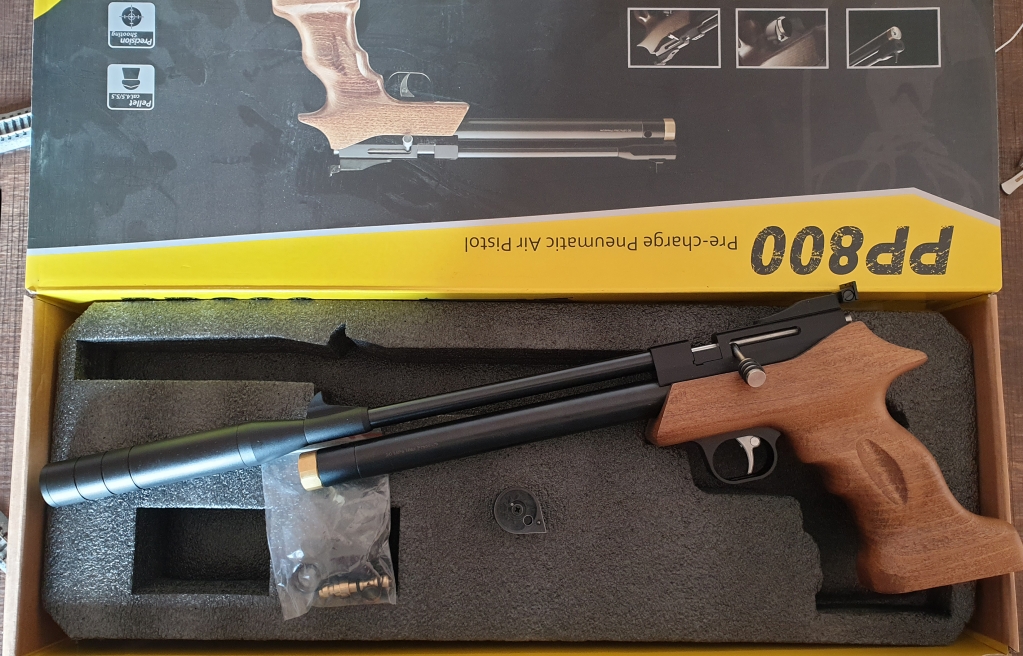

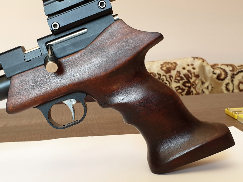

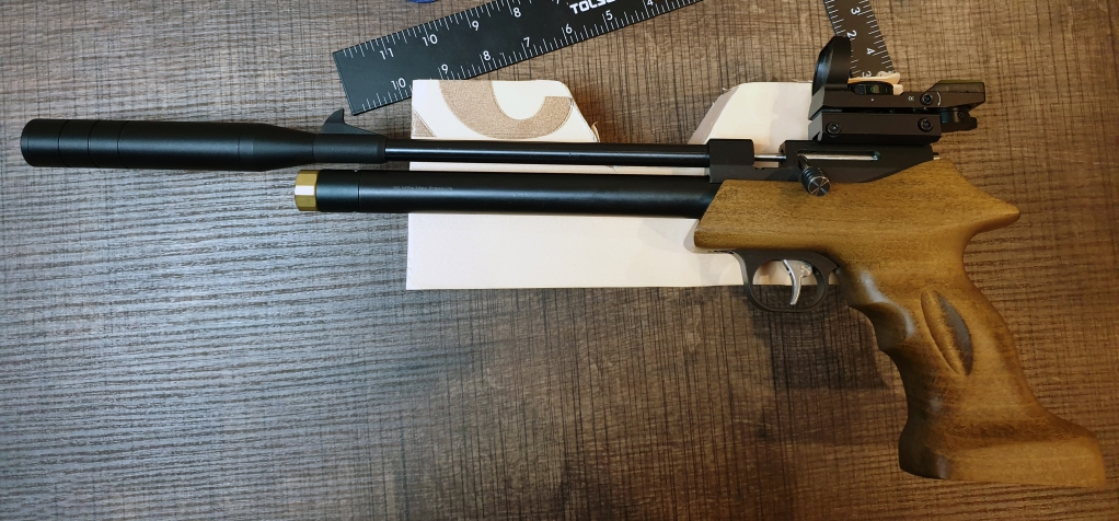

My new PP800
Today got my new toy :) and I'm in love with :)

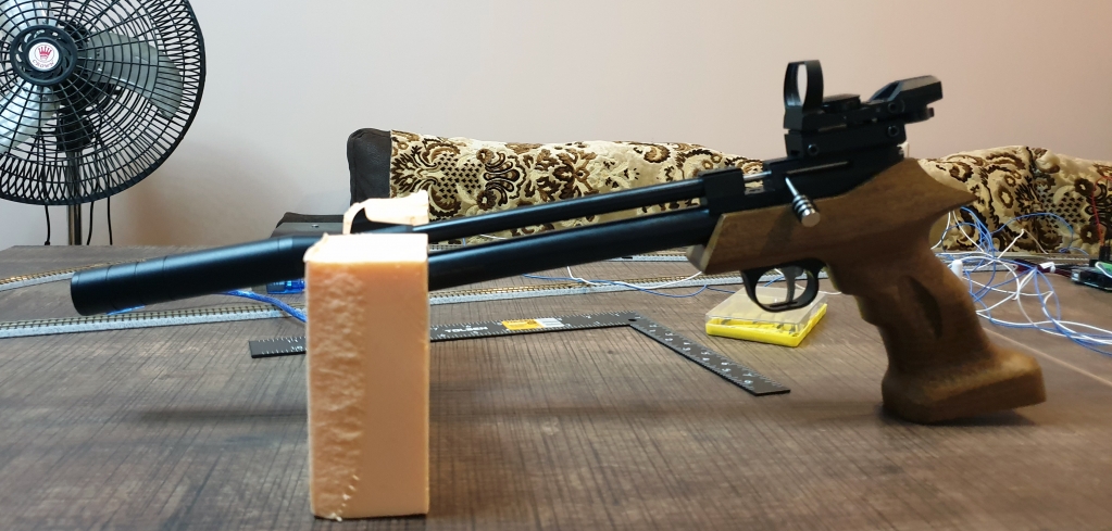

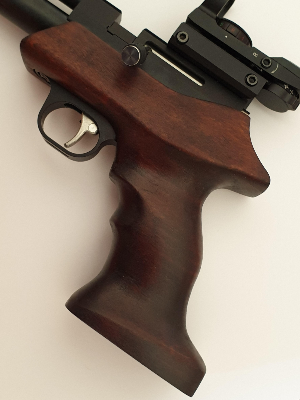

As I said yesterday, I install a collimator on the pistol. Today I tried to shoot at the target at about 6.7 meters. I don’t have any device with which I can accurately align the gun. I shot not from a solid surface. At this distance, after adjusting the collimator, I got the following result: the target is a 25 mm circle. The shots landed in a 19mm circle. It took me 18 shots to achieve that. The pressure dropped from 150 bar to 100 bar. The only thing I didn’t like was the trigger, very heavy
Forgot to mention, pellets I use is Luman Domed 0.68g, one of the cheapest

Trigger has several set screws to play with. One of mine is set to 14oz, the other is set to 16oz.
