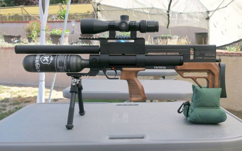

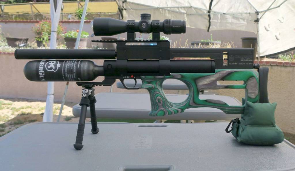

I have a .22 cal/450mm gun, and while I love the bottle & shot count, I really didn't like the 'tactical' stock set up as much as I liked the standard Cricket wood stock. And I was able to grab the last laminate C2T stock which Steve had in inventory (don't worry - he is making more...). Was due over the weekend, but FedEx had some internal delays, and it finally arrived this morning.
It really seems to have transformed the handling of the gun. I like it a lot based on some very preliminary shooting, and will be shooting it much more at this Thursday's shoot at my house.
First appearance - very personal, but really looks incredible to me. Before and after pics (and the camera doesn't do the laminate stock full justice):

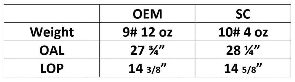

The new stock resulted in some changes to weights and dimensions. Here is a short chart:
My basic first thoughts:
1) I don't notice the weight difference. Lightening cuts were thoughtfully made in the design to only add 8 oz overall while giving you so much more stock to utilize, especially on the bench;
2) Handling of the gun is much improved. Shouldering, cheek weld and carrying the gun by the handle is now much more secure feeling;
3) It no longer says 'Tactical' on the side
4) I'm 6'4" tall, so I appreciate the slightly longer LOP. OAL difference not noticeable to me;
5) Very comfortable butt pad (also adjustable like OEM);
6) Beautiful appearance, and beautifully made. Nice instructions with it. Fit is perfect;
7) Steve made accommodations to switch over the OEM in-the-stock magazine holder to his custom stock;
8) Gun is now much more stable on the bench for me. But at the same time is also more secure in the hand if on a walk-and-stalk;
9) Grip is very nice with great stippling (better than OEM). If anything the grip (like the OEM one) is just a tiny bit small for my 2XL hands. This is normal - it should therefore fit more folks with normal sized hands better than those like me with mongo hands;
10) Did I mention that it is really beautiful and very well made?
