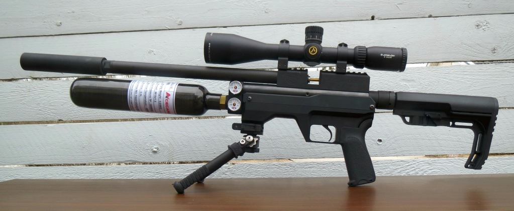

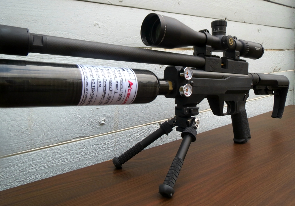

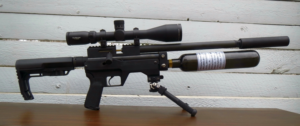

Here's my new WARP Cobra .22
Got it 2 day ago. Nice rifle i would say.
This is my setup at the moment:

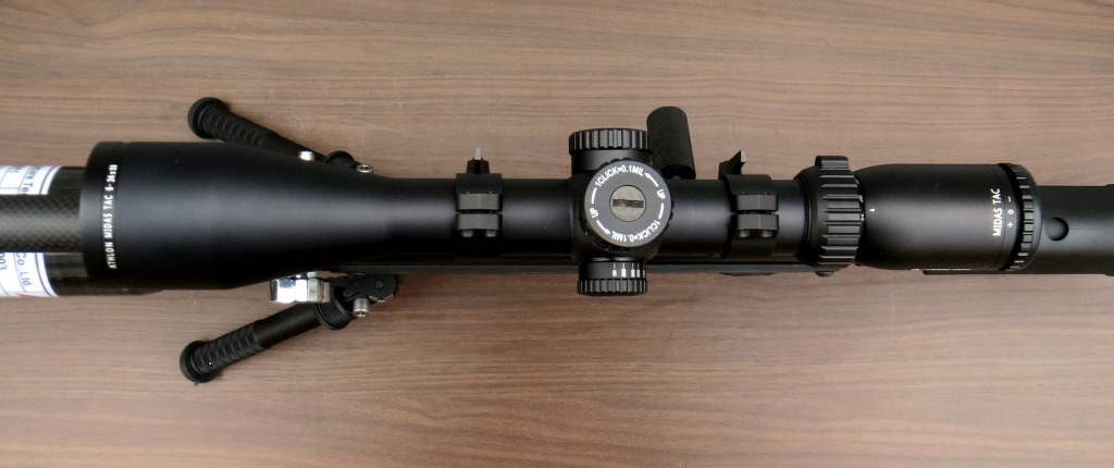

* Athlon Midas TAC 6-24x50 FFP scope
* Warne Maxima QD Rings - High
* Mission First Tactical Minimalist Stock / I have also FAB Defence GL-CORE Stock
* ALG Buffer Tube - Mil-Spec
* Daniel Defence Castle Nut
* BCM GUNFIGHTER MOD 2 Grip
* Atlas BT10-LW17 V8 Bipod
Reactions: Navnesen

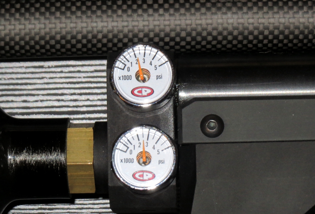

I know you will tune you warp down the road, but I think 2000psi on reg may be too hot for your 22 set up. And of course you have to adjust hammer spring tension also.

Yes.You are right, that the reg pressure might be a little bit too high, These settings or adjustments are made by Jim. I don't have chrono right now, so i'm not going to start adjustin the pressure or hammer spring yet. Right now this shoots 18.13gr JSB:s at 820 fps. This is how Jim said he had adjusted this.

To adjust the Cobra regulator to a lower set point, SLIGHTLY unscrew the burst disk on the regulator til it's hissing a bit of air. THEN screw the set screw on the bottom of the regulator IN (NOT OUT!, setscrew 'out' increases the set pressure). Better to go too much than have to do it again.. Then tighten the burst disk to stop the 'leak' NOTE: don't OVER tighten or after a couple of times you will have to replace the disc. Then fill the bottle and adjust the set point to what you want. I do it in a couple of steps and chronograph the test shots to tweak the set point to exactly what I want {Diabolo pellets do not like over 900 FPS in my experience} You do NOT have to loosen the burst disk for increasing the set point, only lowering it.

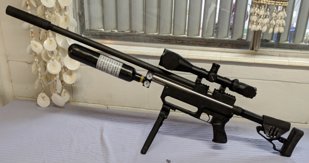

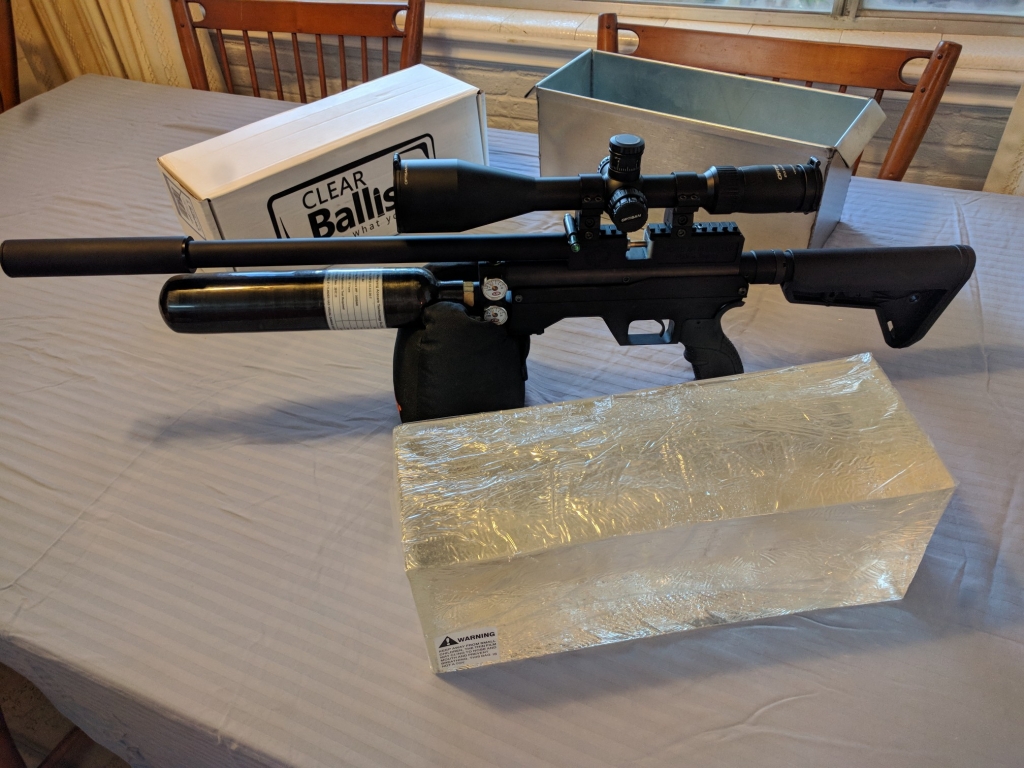

and here is my WARP
and here is my custom .357 FLEX+ with titanium air tube and prototype collet barrel retention system so can really tension the barrel. This is a long range very accurate airgun, less than 1 MOA at 100 yards and 4" groups at 300 yards! I should also add that an owner should not set the Cobra regulator above 3000 PSI as it could damage it. My FLEX+ has a custom regulator that sets at 3400 but it took Jim reworking the internals to do that!
