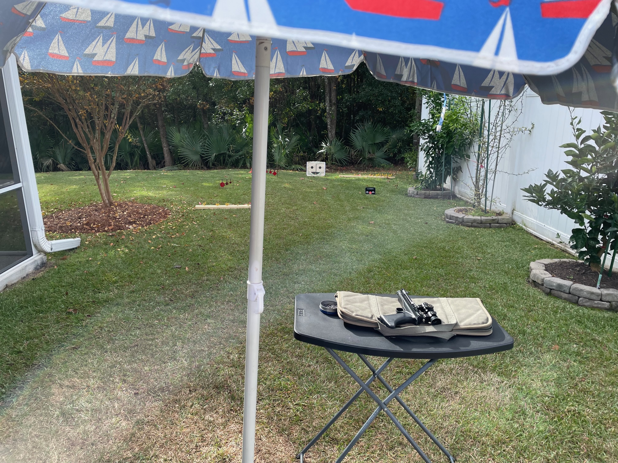

My new Chaser with Ultradot and my 10M target, silhouette and plinking range.
Not broken in yet and only shot with CPHP 7.9g pellets but already accurate. Grip a touch small for me but it has the accidental effect of locking in my hand similar to an anatomic grip. Trigger has lots of creep but is smooth, consistent and not too heavy. I actually prefer that kind of trigger, contrary to popular wisdom, especially when shooting offhand with one hand. I may not even try to lighten it. I am very pleased with it.
Some men prefer to spend their retirement in golf clubs or yatch clubs, but this is my kind of hang out. Grandpa Day Care.

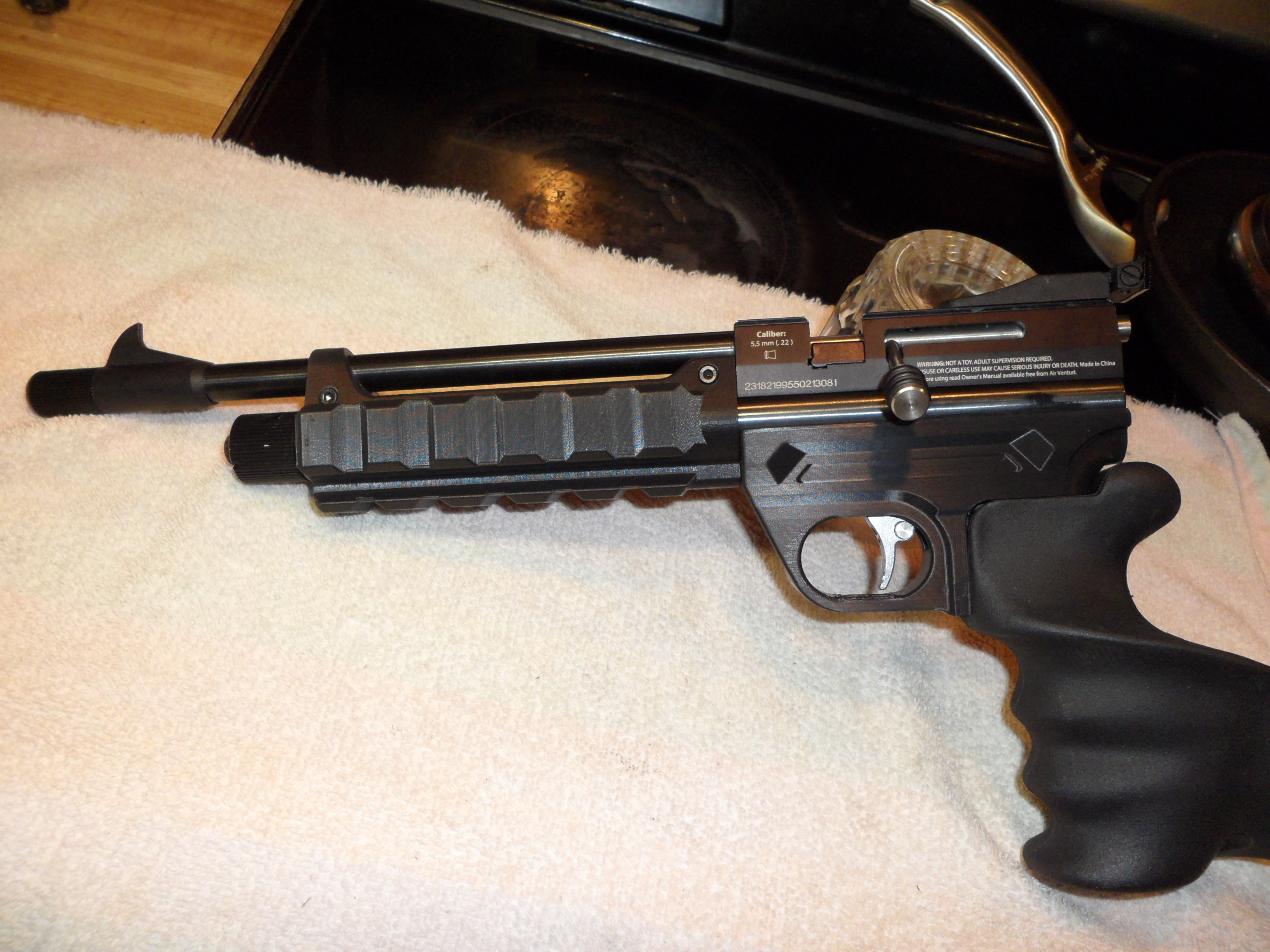

the front is a piece that is sold at Pyramyd Air it has a 15mm OD so i use a 12mm ID x 15mm OD carbon sleeve the globe sight is also sold at PA it is plastic and take Anschutz 17.2mm inserts
in the front barrel weight is a turned down Marauder 1/2-20 adapter
the weaver rail is M-Lok 13 slot and has some mods to make it level and by stealing one barrel screw hole and use the barrel band give you a spot for a scope red dot or reflex sight or nothing at all it is not in the sights way
the barrel band was cut to make the band parallel on the side
a 3 slot M-Lok was use of the bottom of the band with epoxy and the one screw
the rear sight is a the blade style from PA
was a cheap build no lot of bits and pieces and so i built one in each caliber
and of course, i have rebuilt the complete trigger group
new pins, bearing ball end grub screws, .25mm aluminum shims and drilled and tapped the sear and added a 3mm grub screw for a trigger stop
total trigger moment 1.5mm
