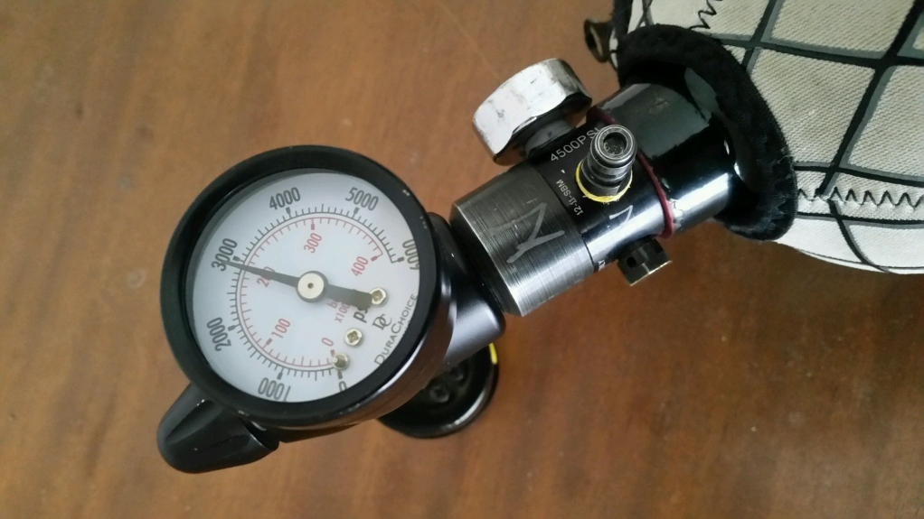

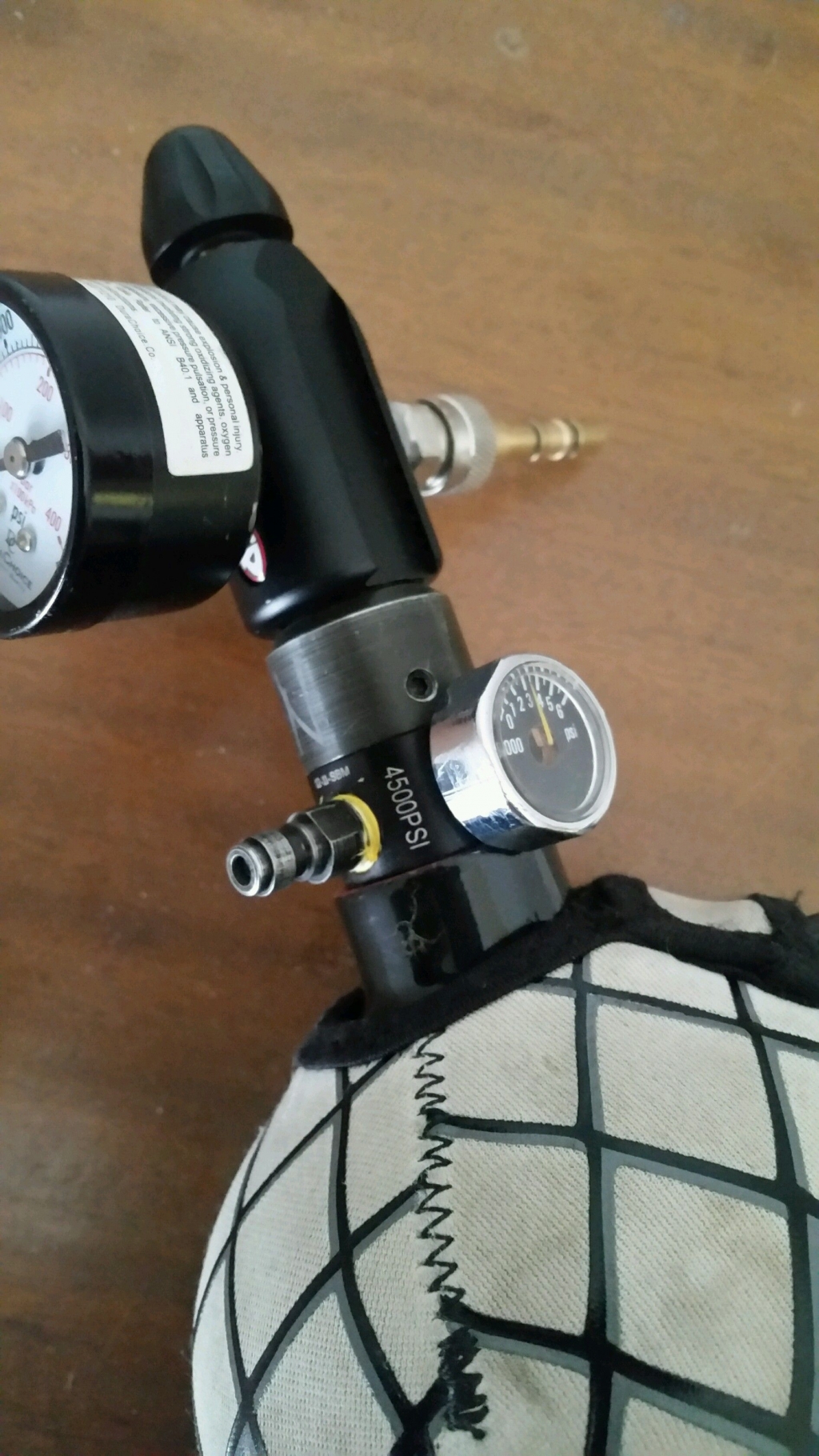

You could have gotten some .047 bellvilles and then you could use a mini CP ASA on/off with bleed which works great. It is super easy to open for filling and bleeding the air.
You would have to also put a 5K burst disc in the output side, but the regular Ninja regs will go to 3K output. I have mine set at 2900. Here it is with my fill probe, and then with a deadhead open showing output pressure
