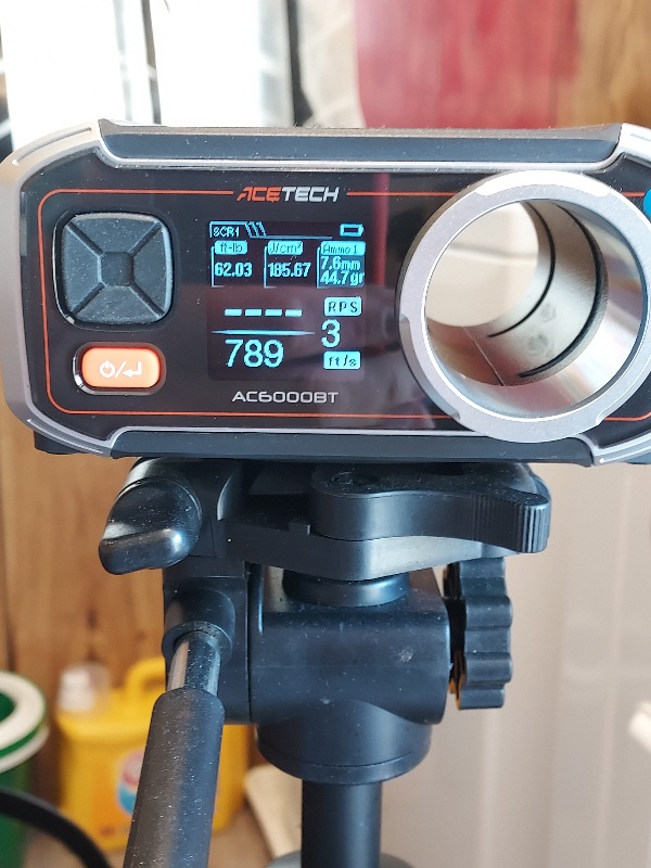

Very consistent FPS. Out of 15 shots I got a SD of 2 and an extreme spread of 6.

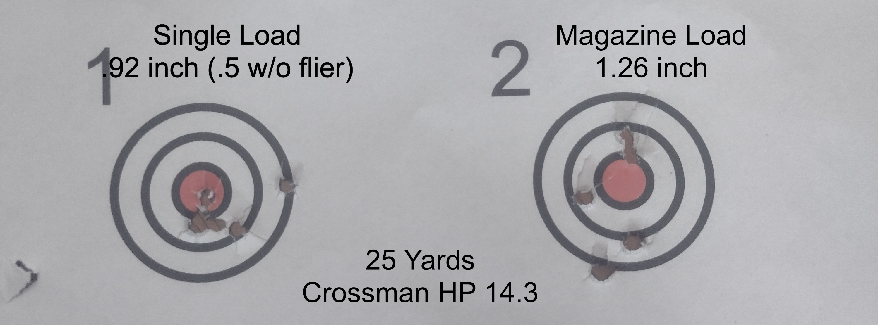

Here is the difference using the single shot tray vs using the mag (5 shot groups). Quite a difference if you ask me.

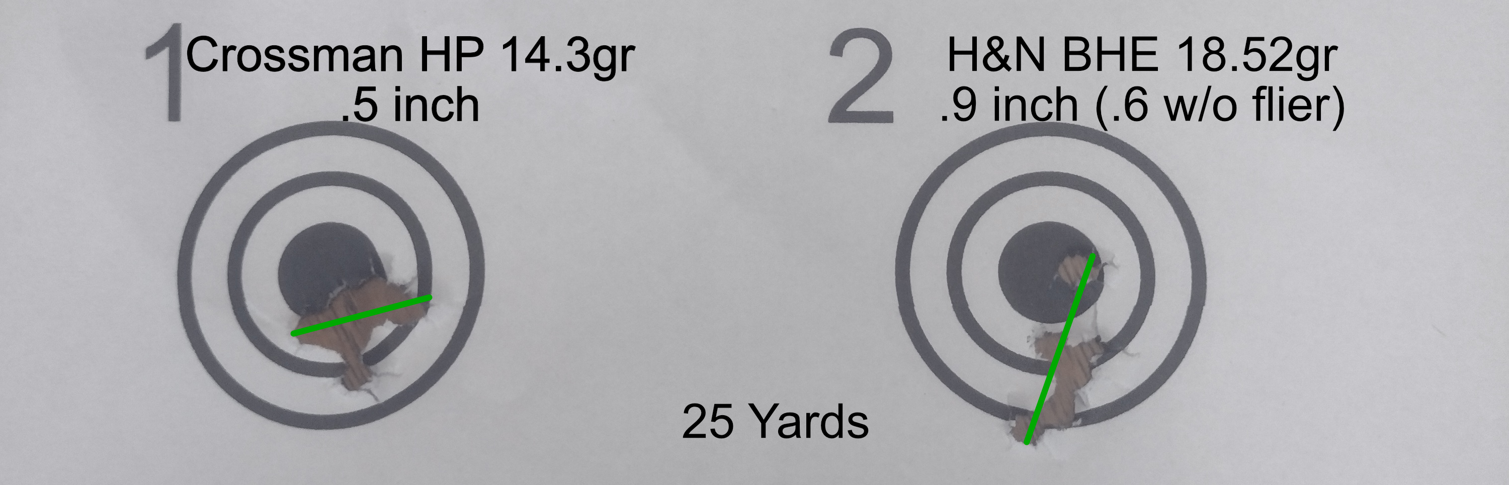

Here is Crossman Hollowpoints and H&N Barracuda Hunter Extremes (using the shot tray). I did shoot some Hades as well, sorry I didn't take a pic of them. They did slightly better then the BHEs. I also shot some JTS Dead Center 25gr, but they were so bad it wasn't even worth taking a picture. I feel like it just doesn't have the power for 25gr pellets.

I can only speak to my experience. And that is Notos vs Aveng-X. I realize this isn't really a fair comparison in terms of power. I'm getting 20fpe (with the hunter extremes 18.52gr; 698fps) at the moment, which is fine. But the Aveng-X can do just about double that. Don't get the wrong idea of me liking the Aveng-X more, just in power they are miles apart.
Overall I'm ok with the power it produces but I was hoping to get 22-25fpe out of the little guy. It's not a huge diffrence from what I want to what I got, which is why it is the lowest on the list of cons.

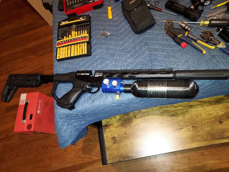

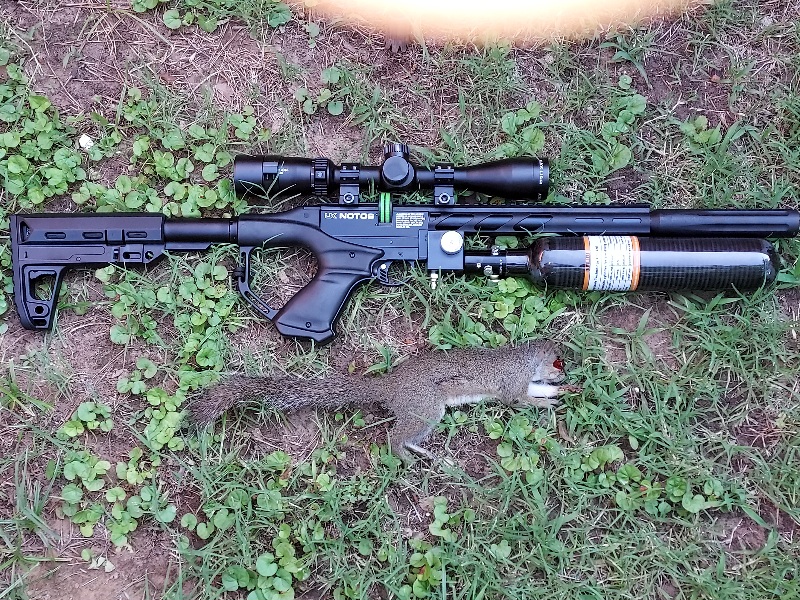

here's the one I made for my brother
300cc 4500psi bottle adjustable regulator, his got 789 with Crosman domes

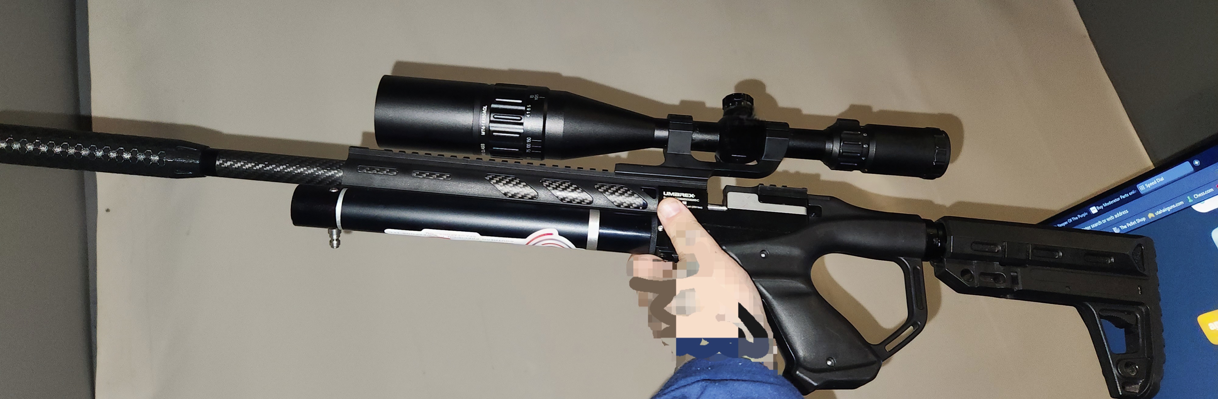

I've added a 380mm fx stx superior liner and the c88 machining plenum and fx barrel adapter kit. Adjusted the regulator to 150bar/2175psi and set the hammer screw about 1¾turns in from factory setting. I'm shooting jts 16.08/fx15.9 @ 781. Drop block and 2200 psi output regulator on a 360cc bottle is next. Let me know how those CARM Mags perform. I prefer single loading over the stock magazine (2nd shot dumper while loading mechanism). I find it wild that the buck rail moderator is the ONLY mod I have that hushed the bark. tatsu, "fx", and tanto dfl's did nothing.

it only added 3oz with the 500cc Carbon fiber bottle, a 300cc would probably be equal to a stock Notos
