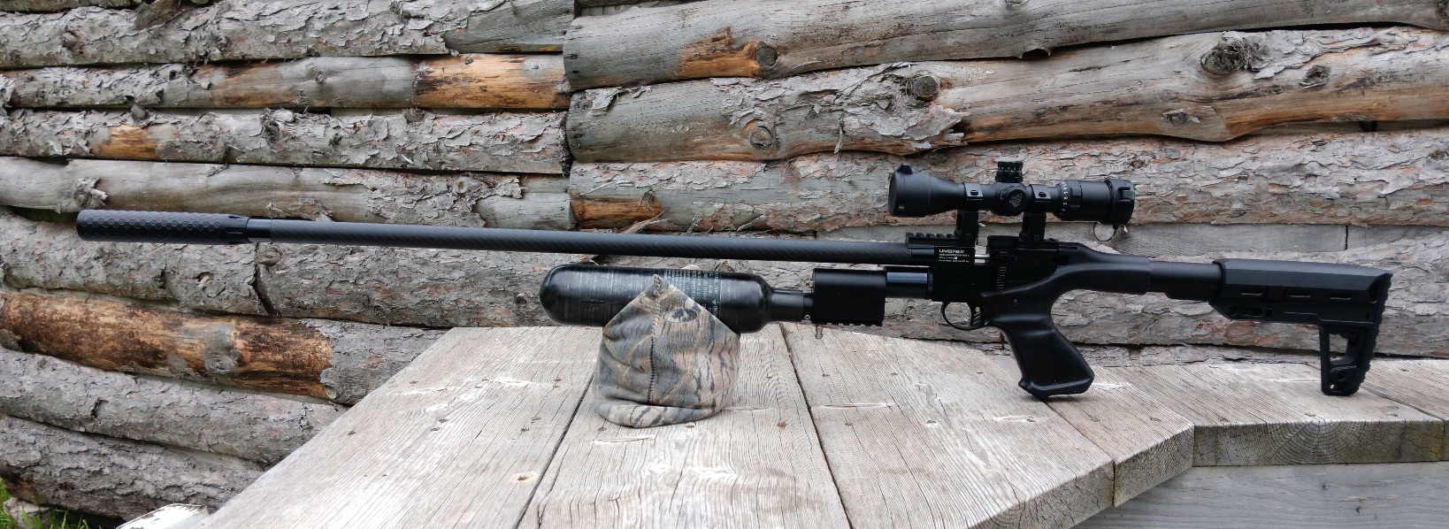

I've added a 380mm fx stx superior liner and the c88 machining plenum and fx barrel adapter kit. Adjusted the regulator to 150bar/2175psi and set the hammer screw about 1¾turns in from factory setting. I'm shooting jts 16.08/fx15.9 @ 781. Drop block and 2200 psi output regulator on a 360cc bottle is next. Let me know how those CARM Mags perform. I prefer single loading over the stock magazine (2nd shot dumper while loading mechanism). I find it wild that the buck rail moderator is the ONLY mod I have that hushed the bark. tatsu, "fx", and tanto dfl's did nothing.

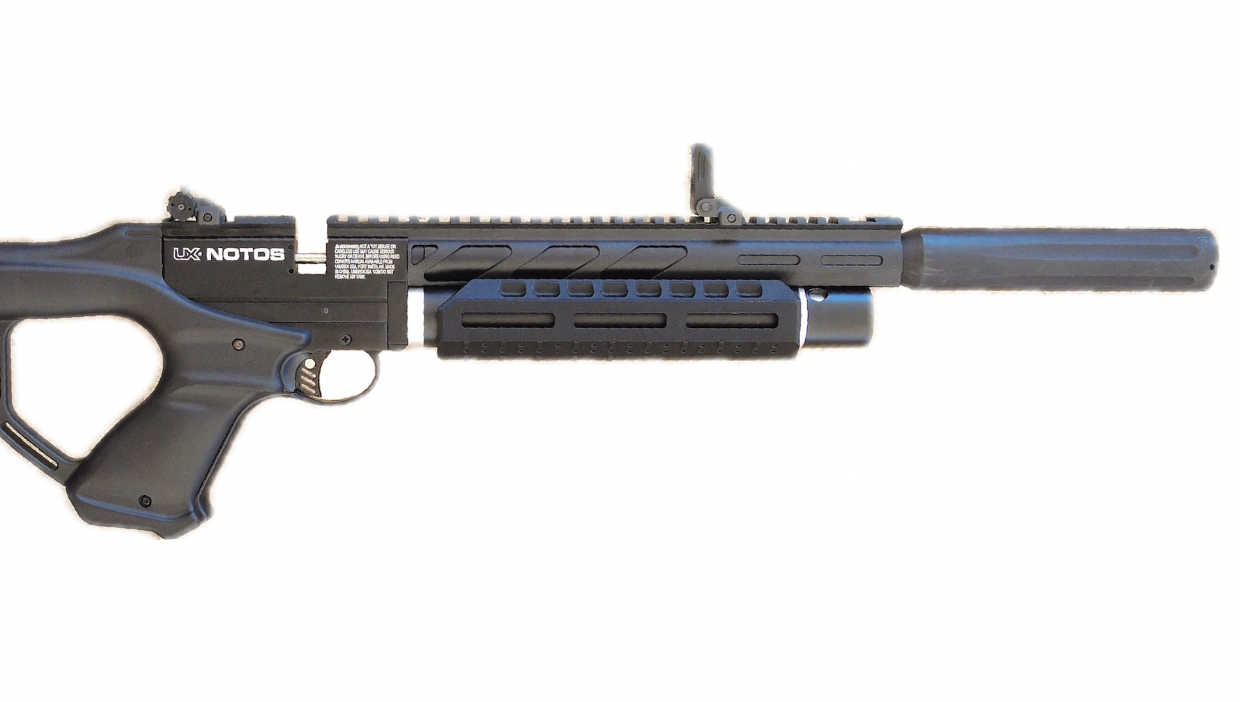

The real joy of the Notos is the ease of modification. The receiver is solid, the bolt/probe is a good design, the gun lends itself to modification and boring out the air path for more air and higher regulator pressures.
Because I'm personally wired to find performance gains in mechanical devices, I've been chasing the dream of a 50fpe Notos for the past year and have been converting Notos as a byproduct.
Here is a solid 40fpe Notos with an FX 700mm kit, porting to 4.5mm and a Cricket Z-block with plenum and .48L carbon fiber bottle.

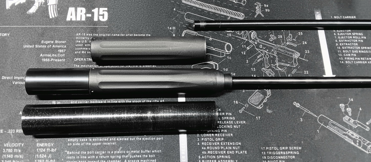

Just need to remove .200" on the bottom of the EZ-Lok and ³/¹⁶" off the rear of the buckrail mod.
I have the fx barrel mod but for 380mm. Did you not notice the muzzle plug threads can be used to leverage against the barrel sleeve and pulling the breech end forward slightly?
In all transparency, I use EZ-locks now on all my moderator housing removals on Notos for customers and I run them through the lathe to face them with the housing so that it's all flat and I'll do that with BR and Long John's too.
As far as pulling the liner jam nut against the shroud, that's called tensioning and can reap smaller groupings. That's a good thing!
Just make sure your receiver grub is well seated first.
Yes I know. Read my post prior to that. I know it's called tensioning. If I tightened the grub any further I'm afraid I'd strip it..
Do you know the pitch of the breech grub?

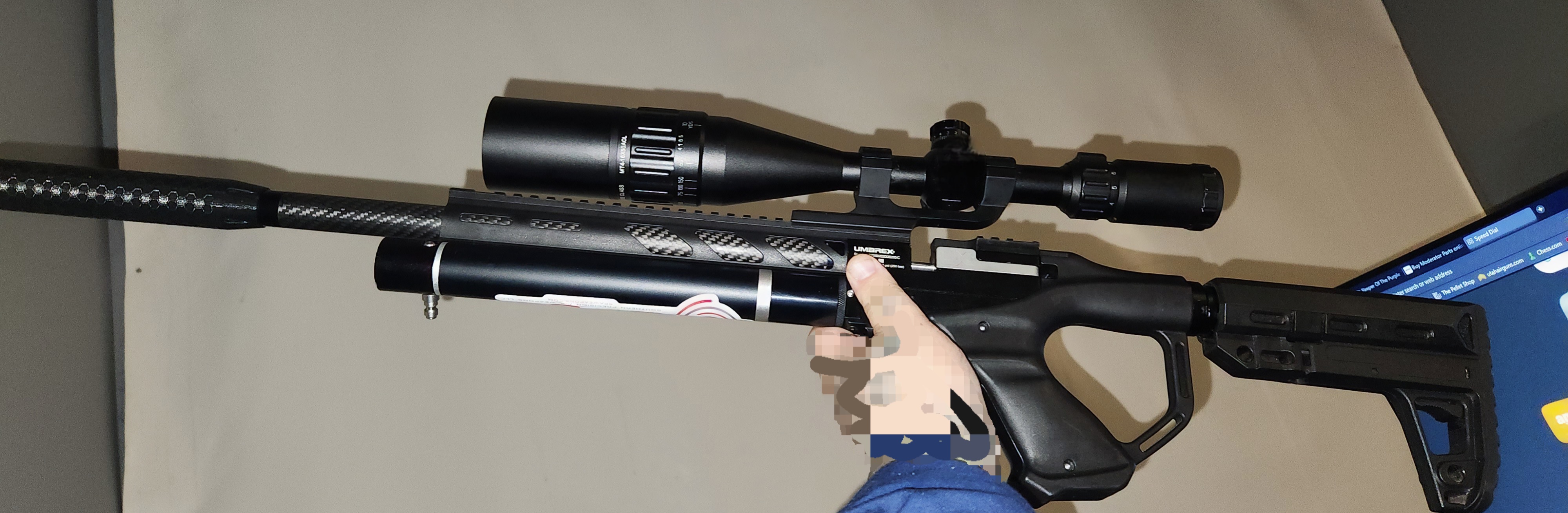

Got the plenum kit from c88machining. I am quite underwhelmed by it, at least the plenum itself.
So some numbers:
All shooting was done with 14.3gr Crossman hollows. I'm cheap. All numbers is based off 17 shots.
No mod (+2.5 HS):
FPE: 17.5
AVG: 744
SD: 1
W/ mod (+2.5 HS):
FPE: 18.2
AVG: 758
SD: 2.4
W/ mod (HS at factory):
FPE: 17.9
AVG: 752
SD: 2.5
W/ mod (HS all out):
FPE: 18.7
AVG: 768
SD: 1.9
So, a very small change to FPS. The SD isn't as good but it is still well within acceptable. But what about shot count... I get 2 more shots, from 17 to 19. Strange thing is it stayed 19 shots no matter where the HS was. I am unsure if this was the case without the mod though (I just set it to +2.5 and never changed it). I suppose I should not have expected much, it is quite a small change to the gun (only an extra 15cc). It isn't as though I put an all new bottle on the thing. I did do a few shots of Hunter Extremes (ran out before good testing), I got FPE of 21.
But lets talk about something I really did like. The barrel mod. And you do need to do it to use the new plenum in the kit, if you don't the tube will hit the old modulator.
I won't go into installation, there are a few YT videos that cover this, but I will say two things.
First, f that mfing modulator. That thing was a pain to get off. I tried to be nice to it and just use a dremal, carefully taking it off. After getting pass the retaining ring I discovered there was another farther back. After getting that one out of the way, I found that there is a small shelf built into the barrel that the modulator kind of hugs onto. After that I stopped being nice and took the reciprocating saw to it... Carefully.
And the second thing, Make sure your your barrel lines up exactly when putting it back on. I was slightly off on putting that grub screw back and it dropped my fps by 100, really that is on me.
Anyways, the modulator delete mod (really not sure what to call this, mod delete mod?) is really nice. They really should have made the gun this way. It is so much shorter without that modulator on (and extremely short without the stock on) and the ability to throw my own on is really nice. It is very loud without a modulator though. I would say as loud as a .22, maybe louder. I do wish the mod came with a thread protector though.
FYI, the second image has a modulator I 3d printed on it. Makes it backyard friendly. Not quite as quiet as the factory one but it is a little shorter.
Final thoughts (aka TLDR). The 15cc plenum really doesn't add a lot to the gun. I could get the extended 30cc plenum that attaches to the one I got but I think I'm good with it as it is now. If I do that I might as well just do the bottle conversion.
The star of the kit is really the modulator delete. If you have the tools and will to remove that sucker, I say just get this mod and pass on the plenum. It makes the gun the way it should have been.
I'm pretty happy with the gun as it is now, didn't quite reach the numbers I was looking for but I think I'm ok with that. Only thing I am likely to do is get a folding stock for it. And I might do a bottle conversion down the line, idk.

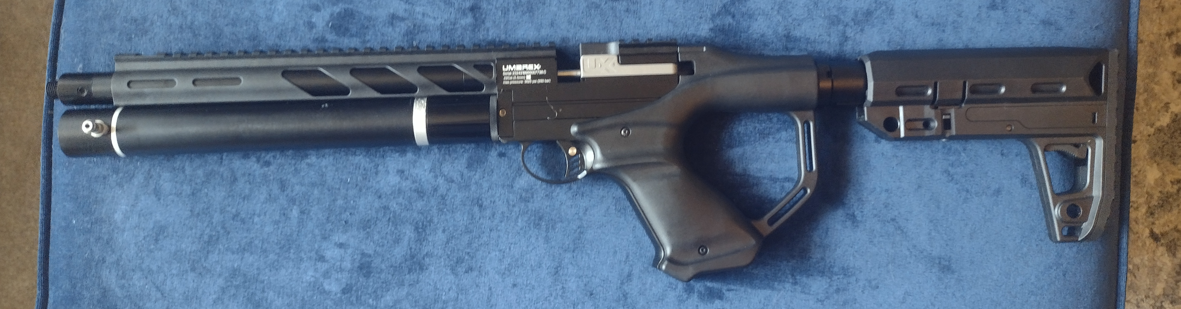

So some numbers:
No mod (+2.5 HS):
FPE: 17.5
AVG: 744
SD: 1
W/ mod (+2.5 HS):
FPE: 18.2
AVG: 758
SD: 2.4
FPE: 17.9
AVG: 752
SD: 2.5
FPE: 18.7
AVG: 768
SD: 1.9

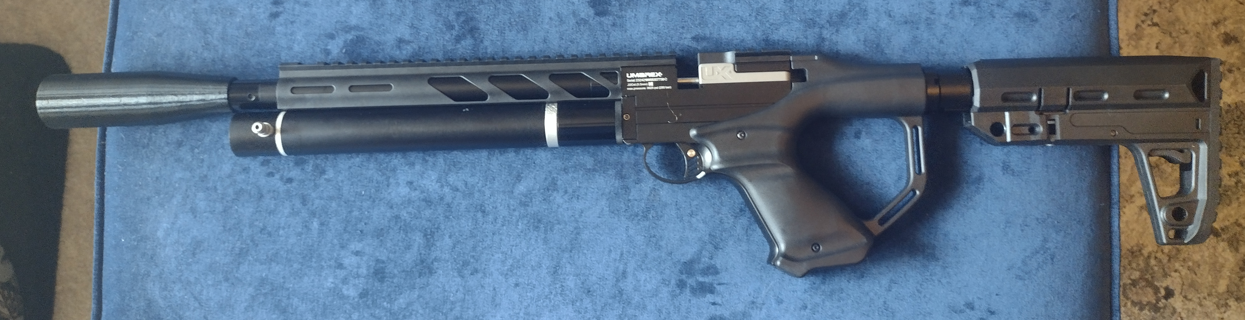

FYI, the second image has a modulator I 3d printed on it. Makes it backyard friendly. Not quite as quite as the factory one but it is a little shorter.

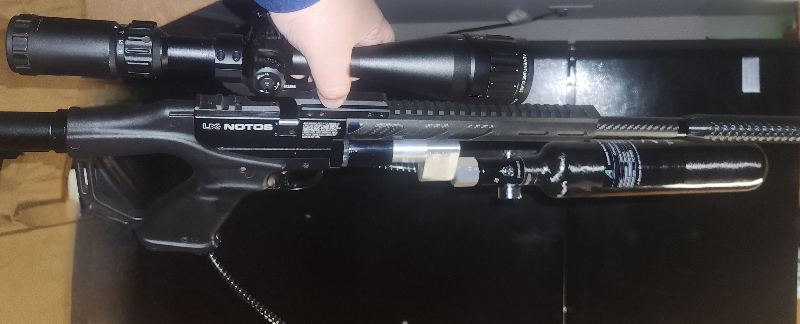

Here's what I'm working with right now. Airarcheryfun was out of the dropblock they sell. And honestly I was too dumb to realize it's the same as the ones on ebay. So I ordered this one from Murph. I had to crank it so man hard that it marred the body through the leather strap i used to protect it from the 18" pipe wrench. I'm buying the zvalve off ebay. Waiting now
