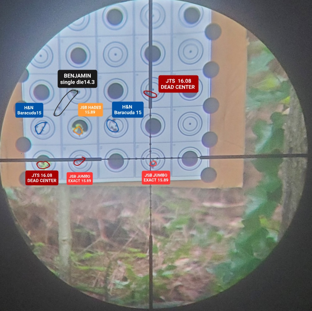

Yeah, I plan on fine tuning the HS. I just set it to max, factory, and what I had set to before mods just to see how they look fps wise. I didn't even pay attention to accuracy.
I was using my cheap plinking pellets and I'm out of any good hunting pellets. I saw no reason to fine tune for a pellet I don't plan on using for real. I'm waiting for my airgundepot reward points to redeem so I can get a tin of 500 Hades for basically nothing.

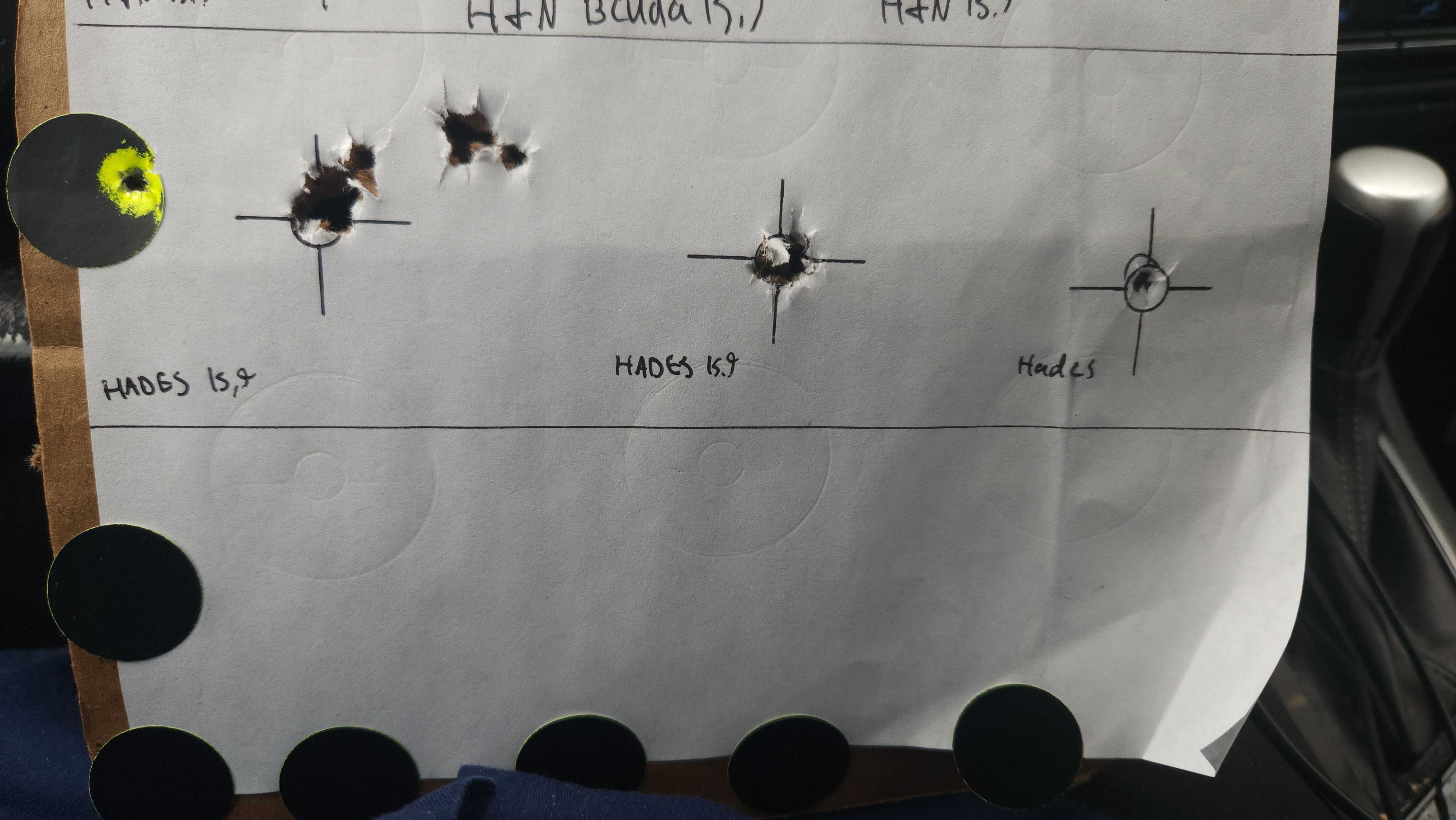

Well. Hades were a definite F YES with the notos... pic related (35y) thats 3 7 shot groups, .5" circles. Group one is center 1st target (left to right) slight right on paper is also a "seasoning" group. Center target is "seasoned". Right target is just 2 shots. After I shot one POA dead center in the shoot n see dot and I Gave it a few clicks of left windage.

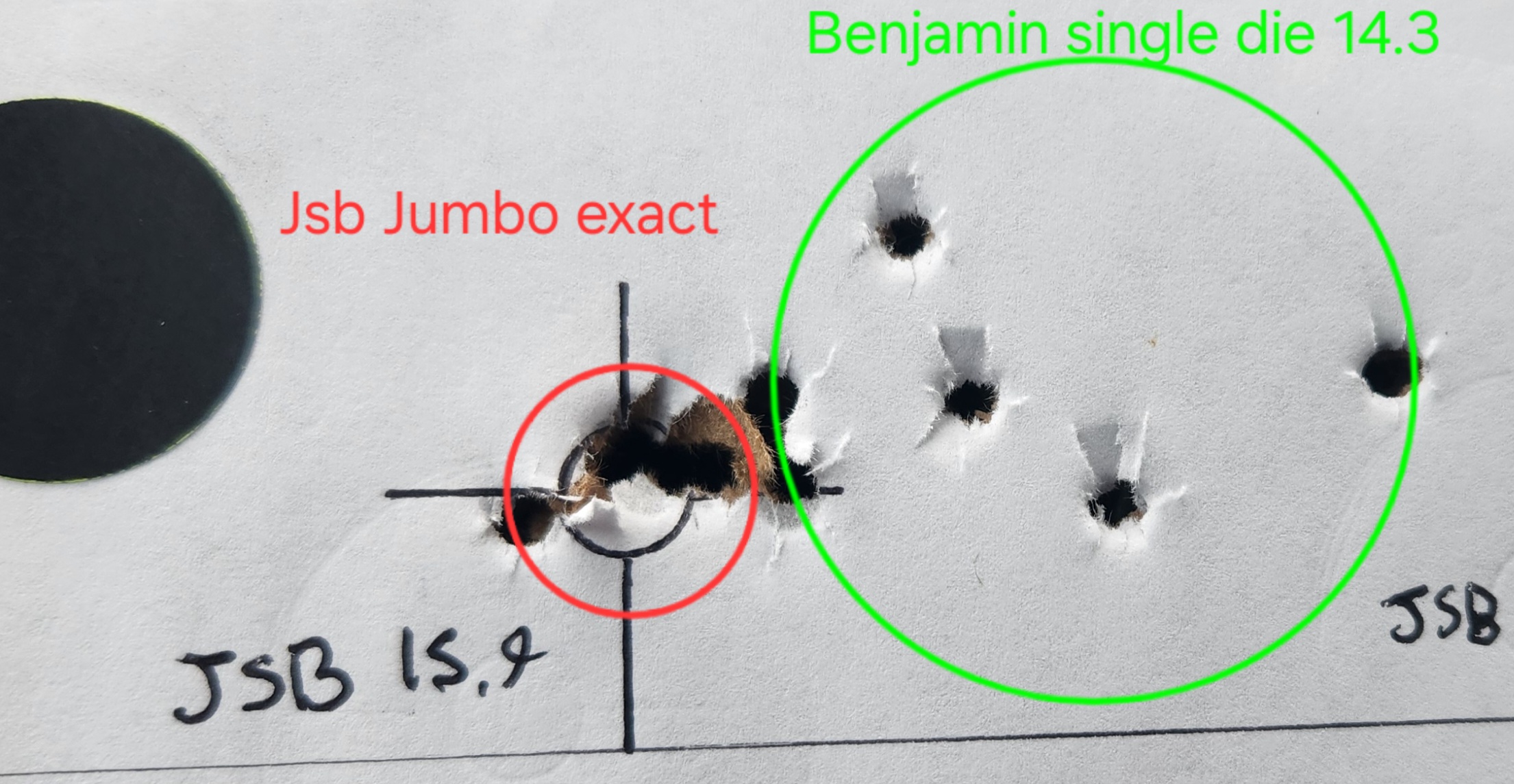

Jsb exact 15.9 and benjamin 14.3 single die. I shot the first group of Benjamin's. Same exact point of aim. Dead center of drawn target... didn't do too well. I had originally intended to do jsbs. But I had made it Wednesday and my package with the hades didn't come as expected. And ended up shooting this AM today.
The superior liner DID NOT like the Benjamin's

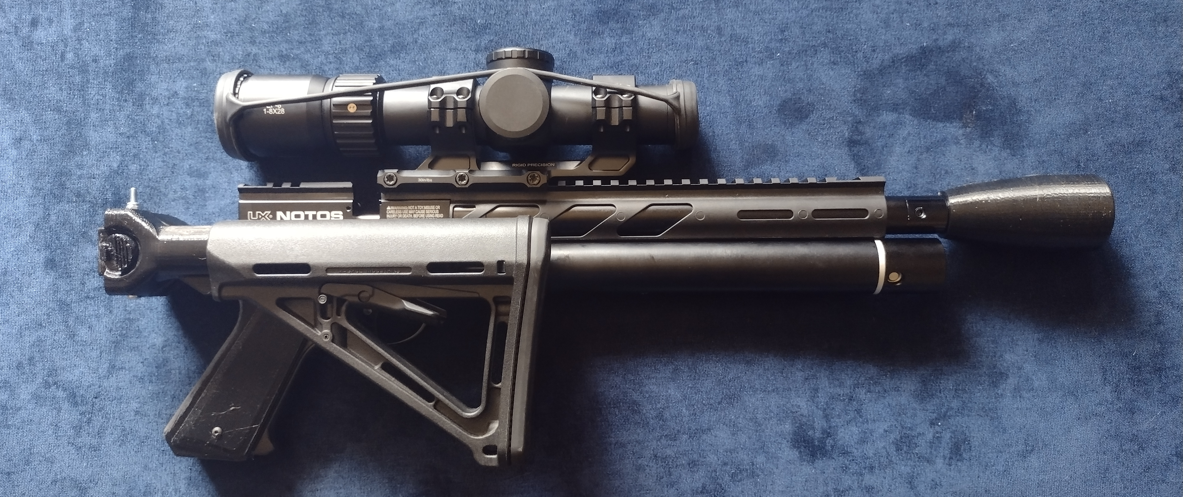

Assembled my folding stock. Has reduced it's size to 12 1/2 inches, folded and with modulator on. I made the modulator quite a bit shorter, surprisingly enough it didn't really impact the sound that much.
I used the 3d file from here. I did modify it a bit. Mostly the grip, they were way to large for my hands. I made them so you can take off the sides of the grip and replace them with smaller or larger ones.
I plan on changing the release button a little, looks really rough right now. Also want to make it so that the bolt/nut will be indented in, that way it won't snag on anything.
It works very well. The buttstock is very tight on the tube, makes no noise when you shake it but is loose enough to move without having to force it. I do have to press the button to lock it in place, but it seems secure when it is locked in. It does move a bit when folded, trying to find a way to fix that.

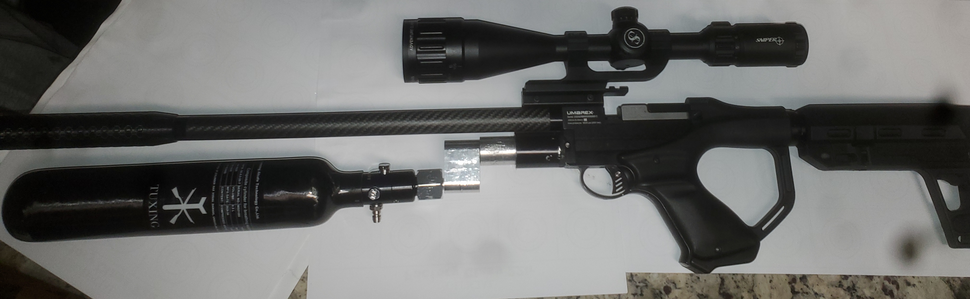

This mornings test. Took off the stock foreend/pic rail as I noticed every time I'd rest the rifle somewhere or lay it on the bags the POI would shift enough to cause misses. I bought some dovetail to pic rails and had a few sessions. No shifts at all and the grouping tightened. So it's official, JUMBO EXACT,JTS 16.08 (jsb exact clone) and hades love it. Same group characteristics at 35y too

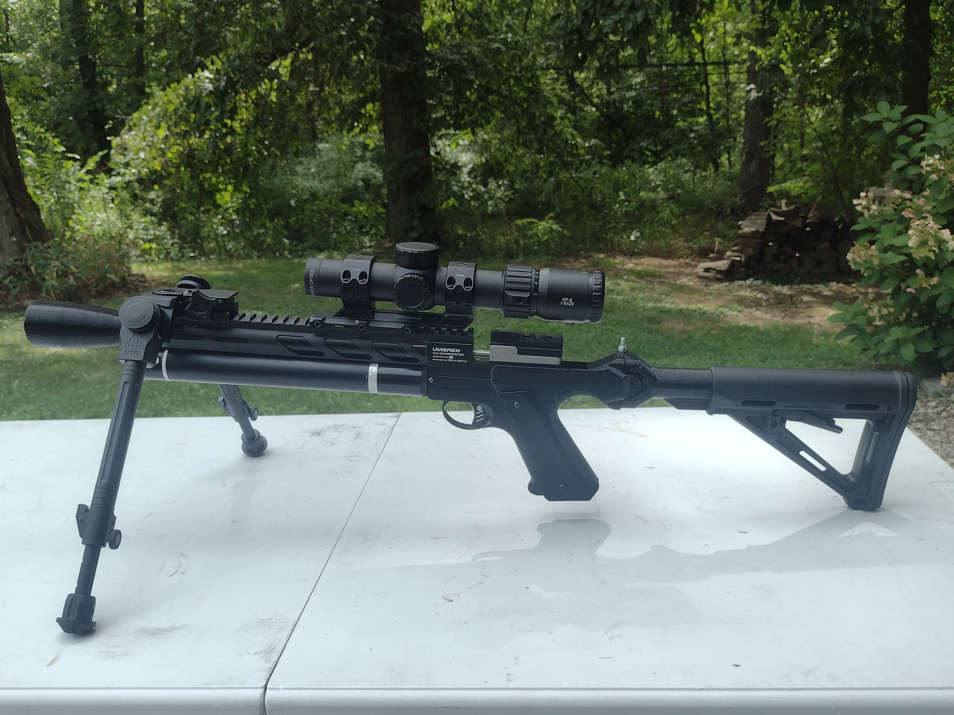

Added a UTG over bore bipod. Works great. Got it for $137 on amazon, seems to be currently on sale. I likely would not have bought it for full price. Although, after using it I would say it is worth full price ($185). It is quite hard to find over bore bipods, at least ones reasonably priced. I may even buy a few adapters to use it on my other guns.

Awesome looks! I have the “Ted setup” (Airfoce over bore bipod), but I have massive POI shifts as the barrel/shroud of the Notos is really not rigid enough to counter the slight bending when gripping and holding the gun. This POI shift is even more exagerrated as my scope (a Zulus) is only mounted on the small rear picatinny piece of the Notos, while of course the bipod is located on the long rail up front. As such the setup is actually really unuseable…) Whats your experience with your setup? (your scope mount is located much more upfront, the effect of bending might be less of a factor as the scope (POA) moves with the POi)
I haven't shot it very much yet with it set up this way, I haven't had time to shoot much. But it seems fine. I haven't noticed any POI shifts (what little I have shot). I'll have to get back to you after I shoot it more next weekend.
Only problem I have run into is the fact that I mounted it directly where my fill probe goes so I have move the legs to fill it. As for the bipod itself, it feels good to use. The quick detach thing is great. If I'm traveling with it or just don't want to use it it is simple to take it off. It is quite low, I don't see it at all when using the scope. It feels really rugged, but not very heavy.
I found the POI shifts irreconcilable and divorced from the original forend and rail altogether. Ordered a 9 slot dovetail to pic rail and mounted direct to receiver. solid POI no shift at all anymore. All the groups I posted were achieved as currently set up

I did have some POI shifts after shooting today. But after shooting I noticed my scope rings were not tightened down to spec, so that could have been causing it. I'll tighten down the screw holding the rail in place tomorrow as well.
I really hope that is the problem, I really would not like to have to get rid of the pic rail to eliminate the problem. I've grown to really like this bipod.
