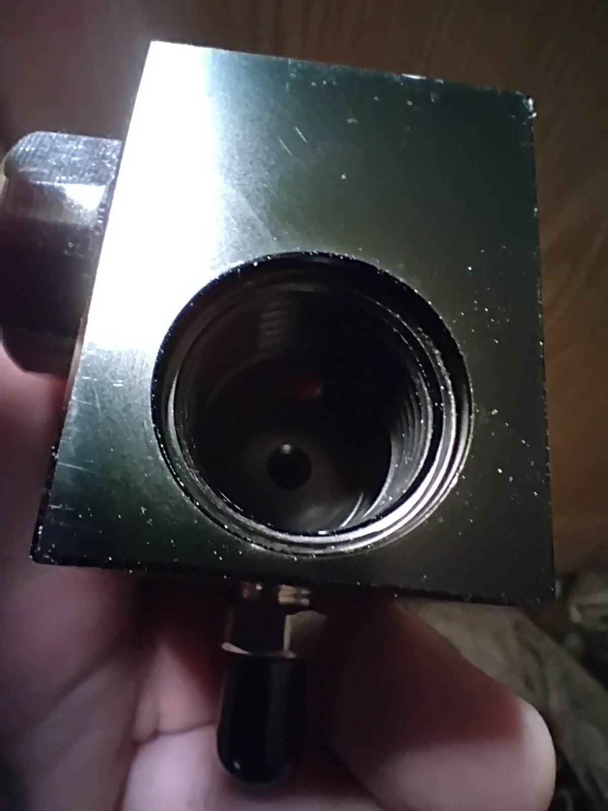

I found the POI shifts irreconcilable and divorced from the original forend and rail altogether. Ordered a 9 slot dovetail to pic rail and mounted direct to receiver. solid POI no shift at all anymore. All the groups I posted were achieved as currently set up
I ordered that drop block as a fill in
Waiting on dropblock regulator to finish being clocked
does that drop block flex? my spidey senses are going off like crazy just looking at it.
It's a POS stopgap measure. My z valve just got here , now I'm waiting for Sunday when the pinless adj reg gets here. If you can find it in stock. Buy the cricket reg from huben.
You can not imagine the frustration when I got the block which I had lapped to clock perfect.. and NO PIN VALVE DEPRESSOR!

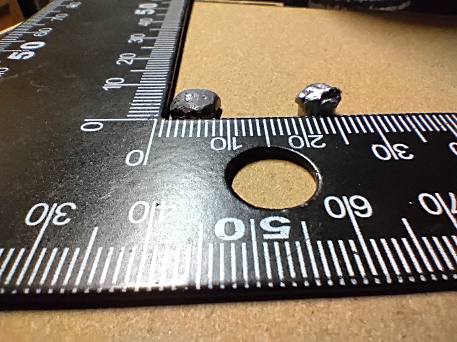

Edit: pic below are projectiles dug out of squirrel face on to me tonight.. slug entered nostril and ended in hind quarter. (33y (Right) and Hades that hit rabbit this past Sunday... 90⁰ facing left at 22-23y through left side of left eye exited right shoulder and barely entered dead log if was against.

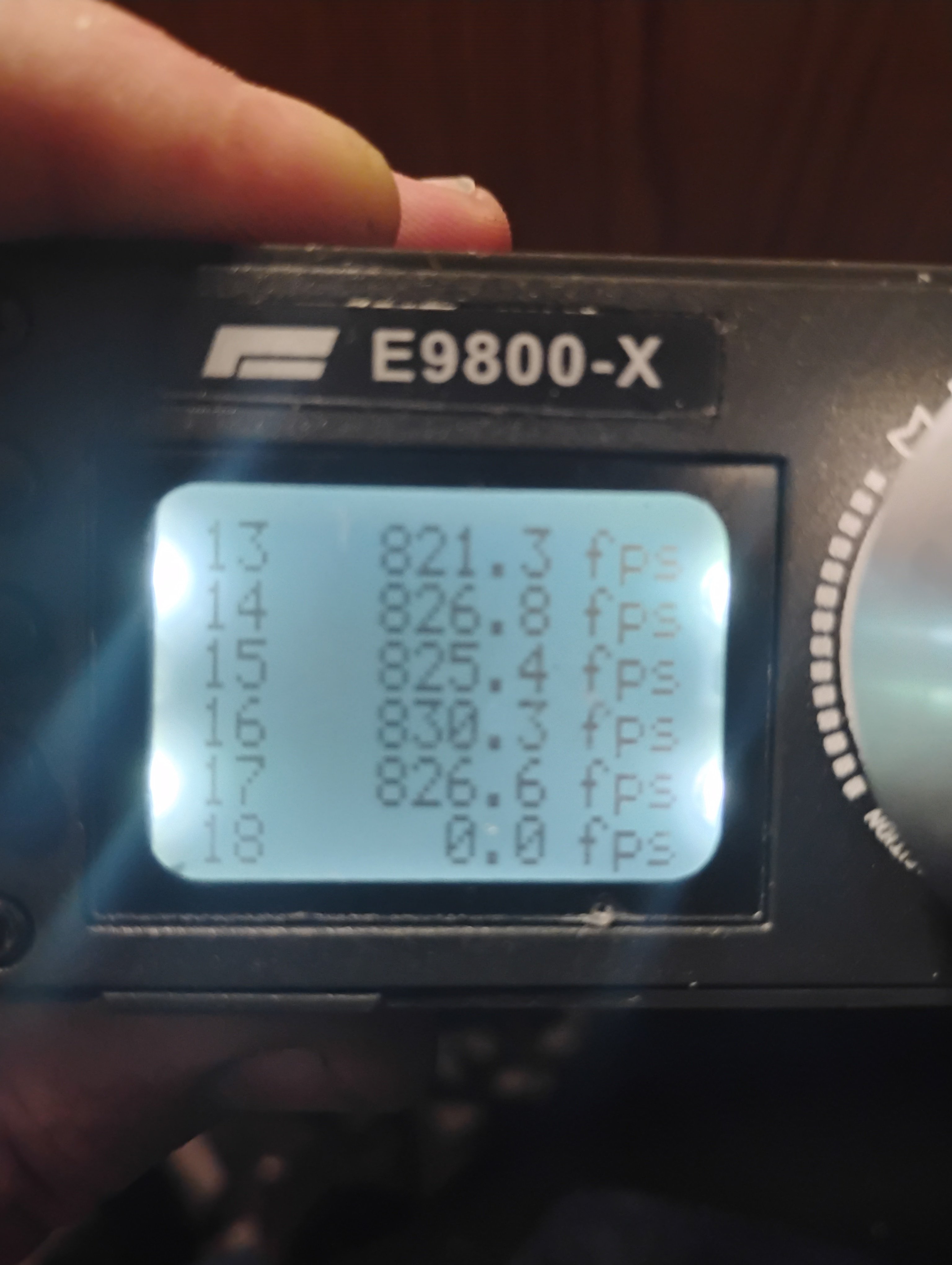

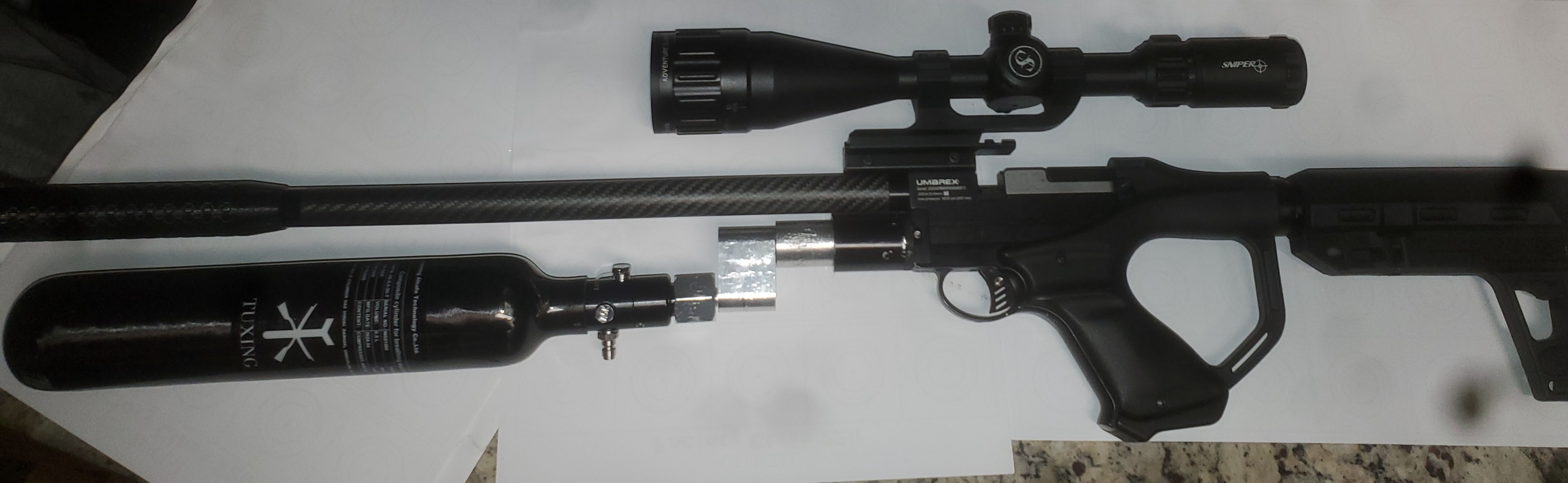

Well, fellow notos Junkies.
I ported. And I am very satisfied.

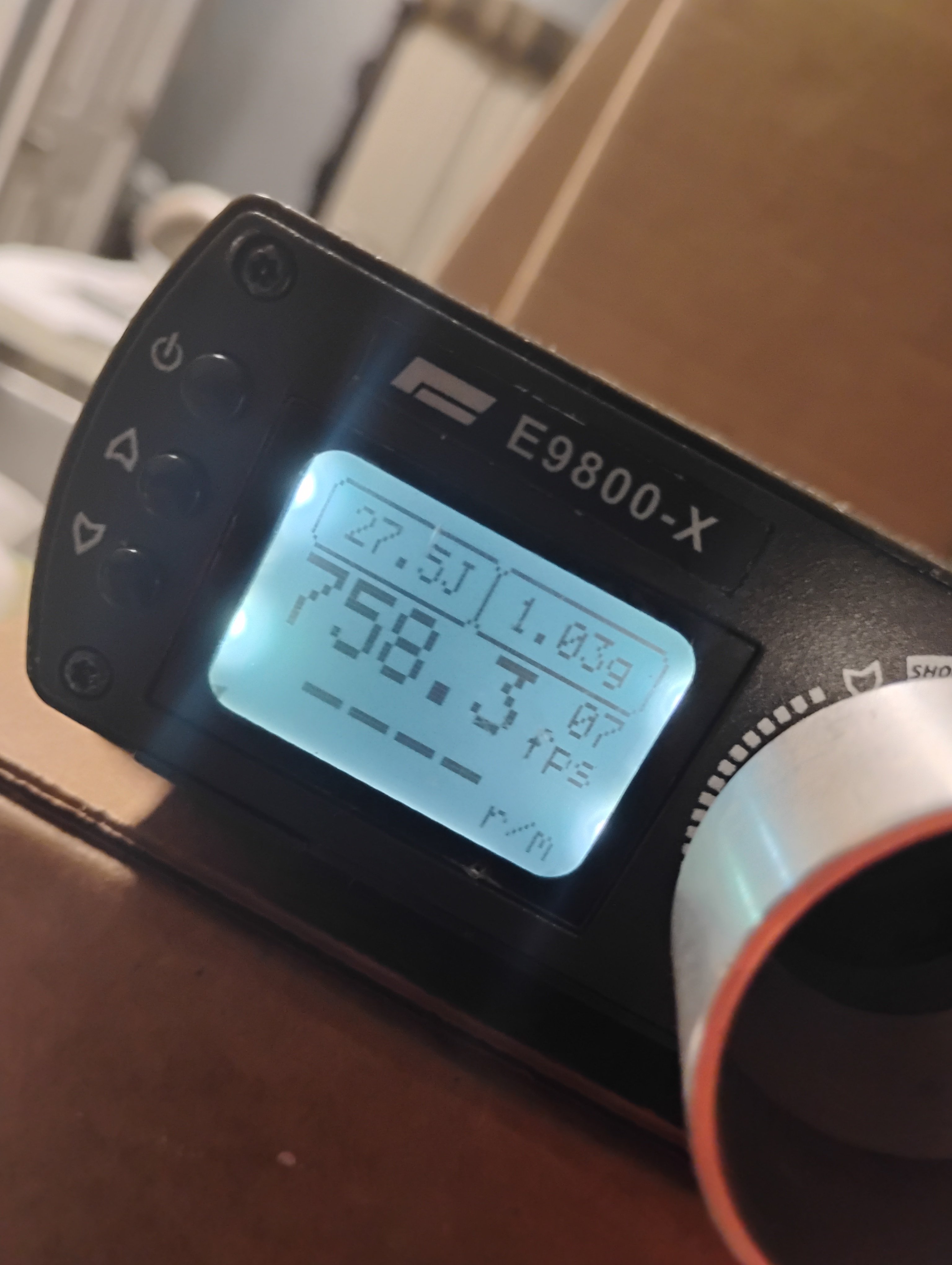

I did a very mild port. My port was originally ±2.7mm. I brought it to 3.5mm. These are my results thus far.. btw I used my original tube + plenum. Didnt want to risk a 500cc blowoff. (IDK why, I expect things to explode every time I pressurize.). So this is at 1900psi. And 85-90% hammer spring.
These are with 15.89 Hades. 825.9 average 17 shots until I hit reg pressure so a little lower shot count. But with the bottle. Worth it.... The 15.9 exacts chronod at 837.3 average.
And with slugs... 17.5gr NSA .2175(218)

told you you could do it! worth the effort
