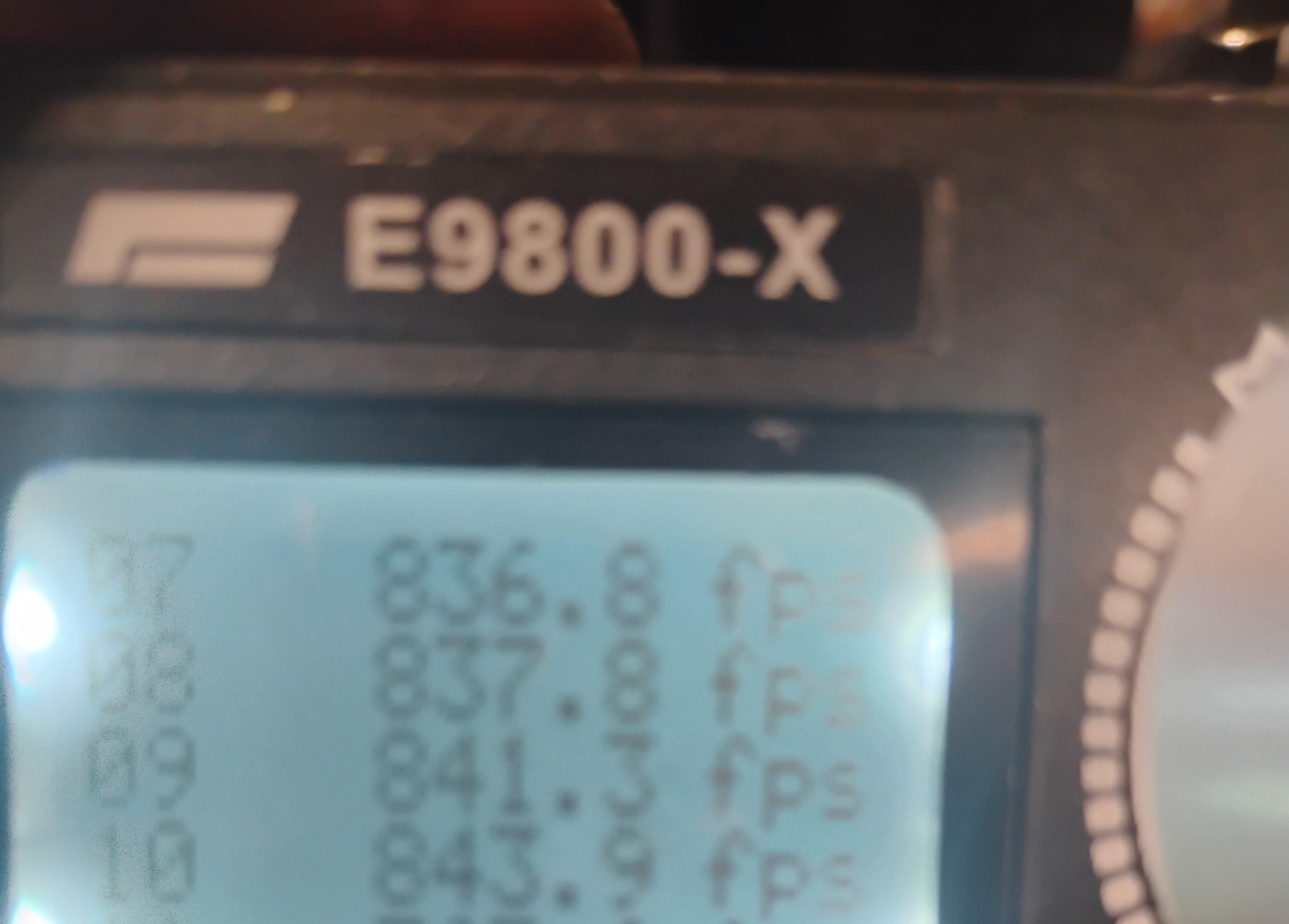

I went back in and finished mine today.
Opened the TP, Chamferred the bottom, opened the valve port, slightly widened and polished part 66 port. I'm at 1800psi now and....
Full disclosure the next string was 767-778 with the NSA .2175 17.5grs. the 836-843 was 15.9 Bcuda. JTS DC 16.08 identical results. 15.9 Hades and exact.. 830-836

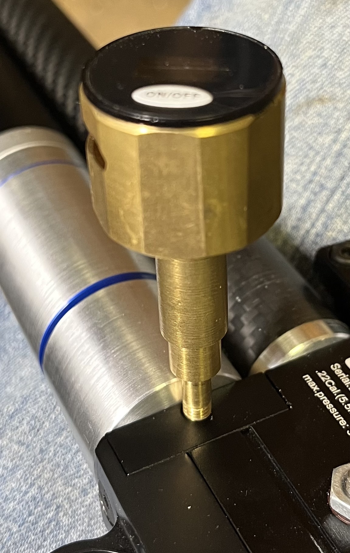

It’s actually in the block at front of receiver and I made an adapter for a gauge for setting reg pressure.
DaveView attachment 488106
It's the silver hex head. I'm familiar. I've consistently been told "not a bleed screw".
Ive always used the gauge or fill nipple of my drop block reg.

i just shoot till about 1000 psi then back out my hammer spring tensioning screw and proceed to shoot it down till the poppet valve can’t hold the hammer spring back. you can hear it hiss out the air when you get to that point. bleeding through the gauge always messes up my o-ring.

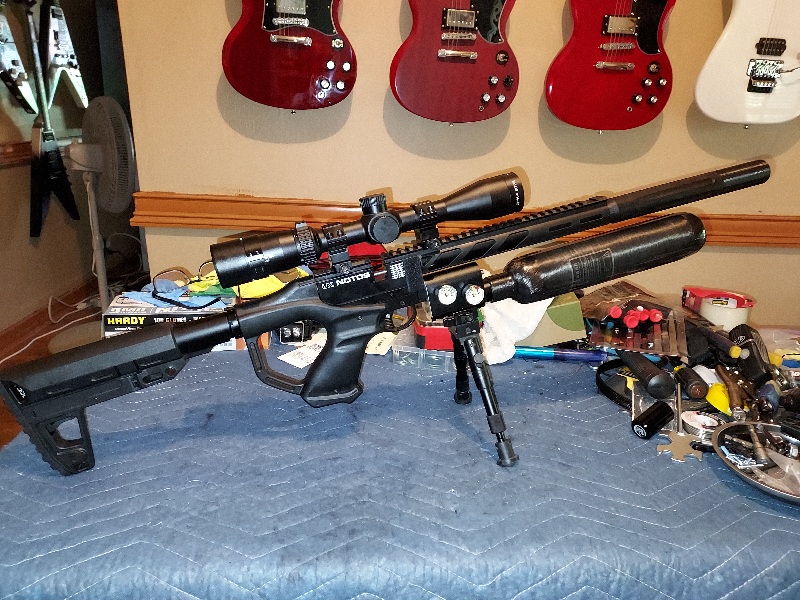

Finished mine yesterday on the performance side. Now to finish the aesthetics. And I'm 90% done with that. I've ordered the buckrail AR grip and stock adapter. Doing the picatinny stock option and I'm probably just gonna slap a UMP stock. But I know it would look incredible if I spent the $200 on the Midwest industries AK74 paratrooper stock. Like this.
Or the galil folder. Either or I'm gonna end up with a beautiful notos. Here is as is....
I switched drop blocks from the supewell to the Huben
View attachment 488767View attachment 488774
Looks good. It was my first choice. But I don't have 2 month wait for delivery patience. Airarcheryfun was out of stock and I cannot wait. I couldn't wait the one month for what I have now and used A TOTAL POS eBay drop forward that I now know was only rated for 1800PSI. So I could shoot in the meantime.
That regulator on mine is a Huben Cricket inline adjustable reg. I personally threaded and machined the super well to clock. The huben drop/reg has a sept "1st-october 13th" delivery date. I'm fine with what I've got now.
