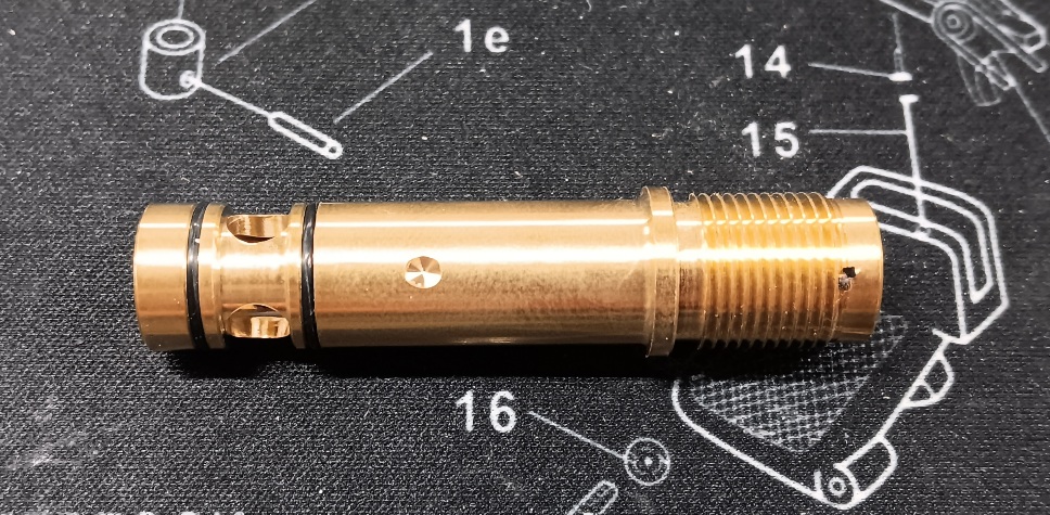

I decided to try and port mine. I have it completely disassembled now. I do have one question; Do you have to drill out the brass part (valve) the pin was holding? It seems like you should but I don't want to drill it out if I don't have too.

...Do you have to drill out the brass part (valve) the pin was holding? It seems like you should but I don't want to drill it out if I don't have too....
Yes
The goal is to increase the air path. If you don't open the port from or to the valve (the brass is the valve seat) you restrict the airflow.
Also, the reasoning behind the 4.5mm porting size is simple: You would have to drill out the TP hole threads to go larger.
Not a big deal but you need to then drill and tap the TP access hole for an M6 screw and re make the o-ring seat.
You need to drill and ream the air block, valve body, transfer port as well as the barrel to see a full uninterrupted airflow.

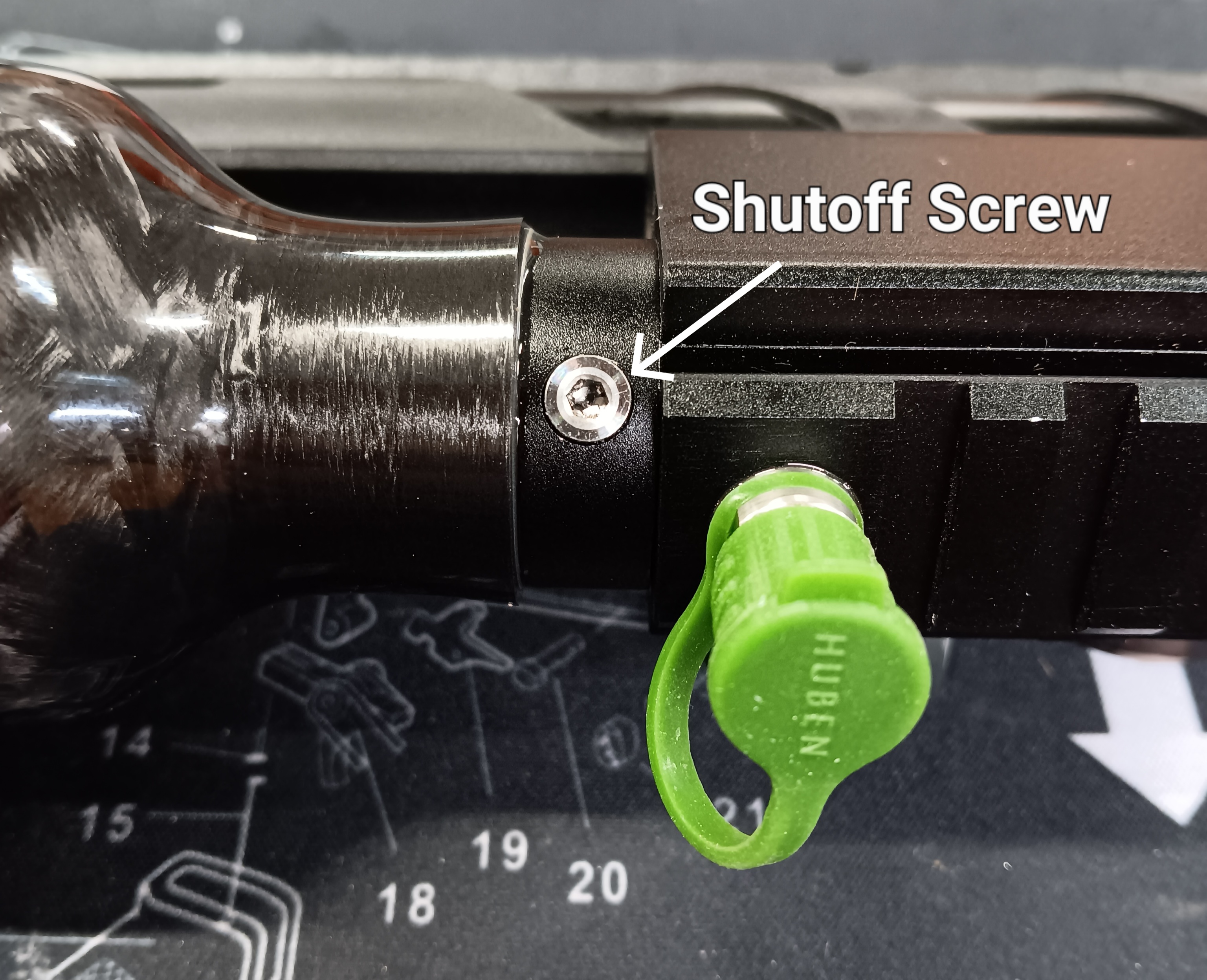

There is no need to degass your tank if you use the Huben Cricket Drop-block. There is a STOP grub on the bottle attachment collar that seals the bottle airflow from the block/regulator.
If you have a Gen lll Notos, you will have a degassing grub on the air-block to dump the regulator.
Reactions: JaceSpace1369
