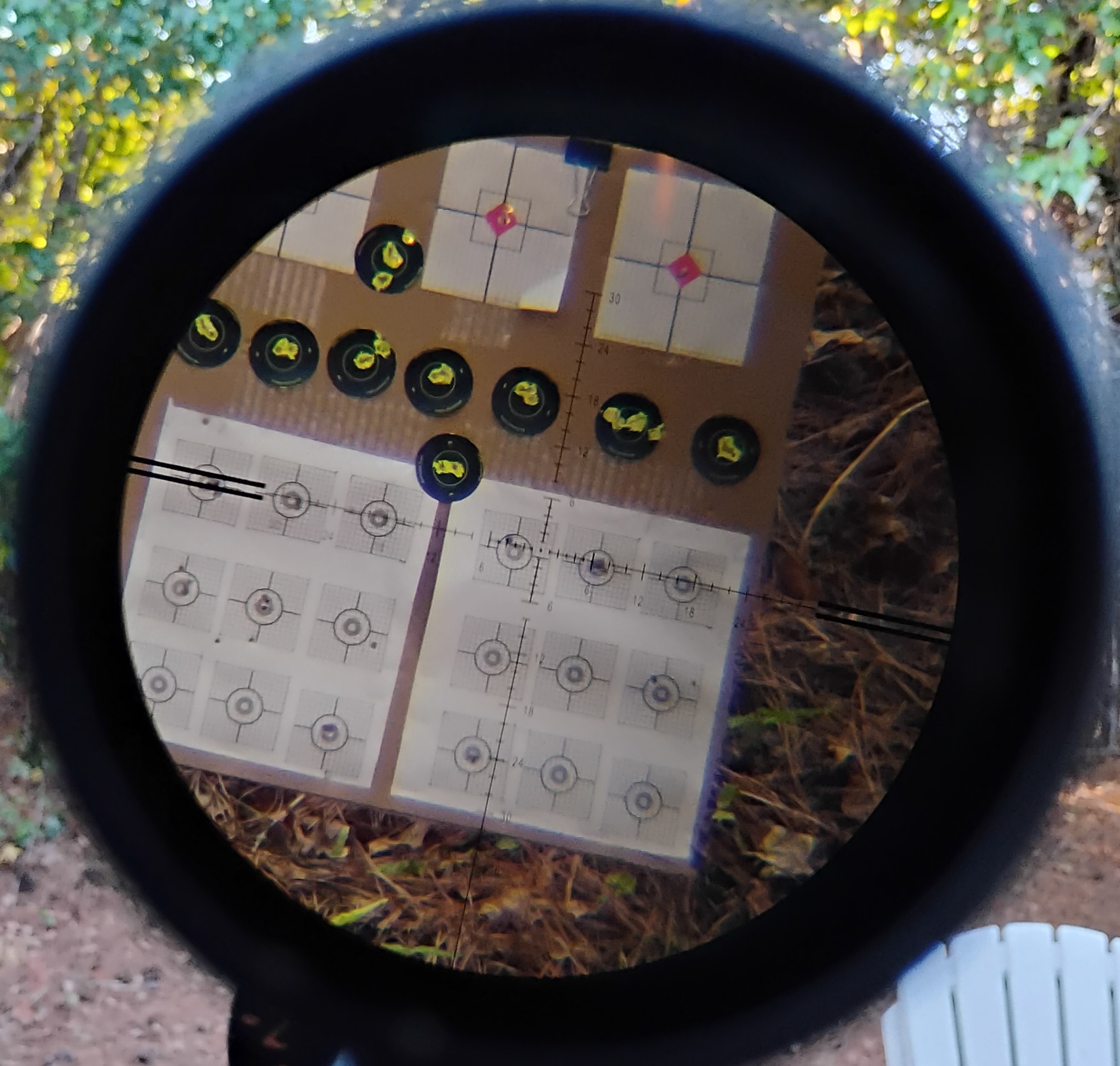

Cracked open the gun and stepped the port holes up from 5/32" (3.97mm) to 4.3mm. Used a 4.3 drill bit and a t-handle chuck to prevent drill chatter damaging the threads of the tp access hole . Got all holes to 4.3 polished them, re assembled. On the chrono I get 807... Started playing with pressures and hst again. Dropped to 1800±. Roughly 80% Hammer spring tension. And got 856 average
Had to re zero and did some shooting at 50m. The bottom left target sheet... The random Impacts on the middle layer are the first shots. 18moa low, 13 right. 1st shot was middle layer right target, then moved poa to top left target on the same sheet. 2nd and 3rd impact confirmed the ±18 low ±13 right. 4th is middle layer left target over corrected windage, 5 6 7 are windage corrected and confirmed. Then got the elevation dialed and began shooting. The shoot n CS with the marks off of bull are shooting the little "9"s. But this is how the AEA 15.9s did at roughly 847-867. The 867 is what I got when I bottomed out the hammer spring adjuster. Most shots were 854-858

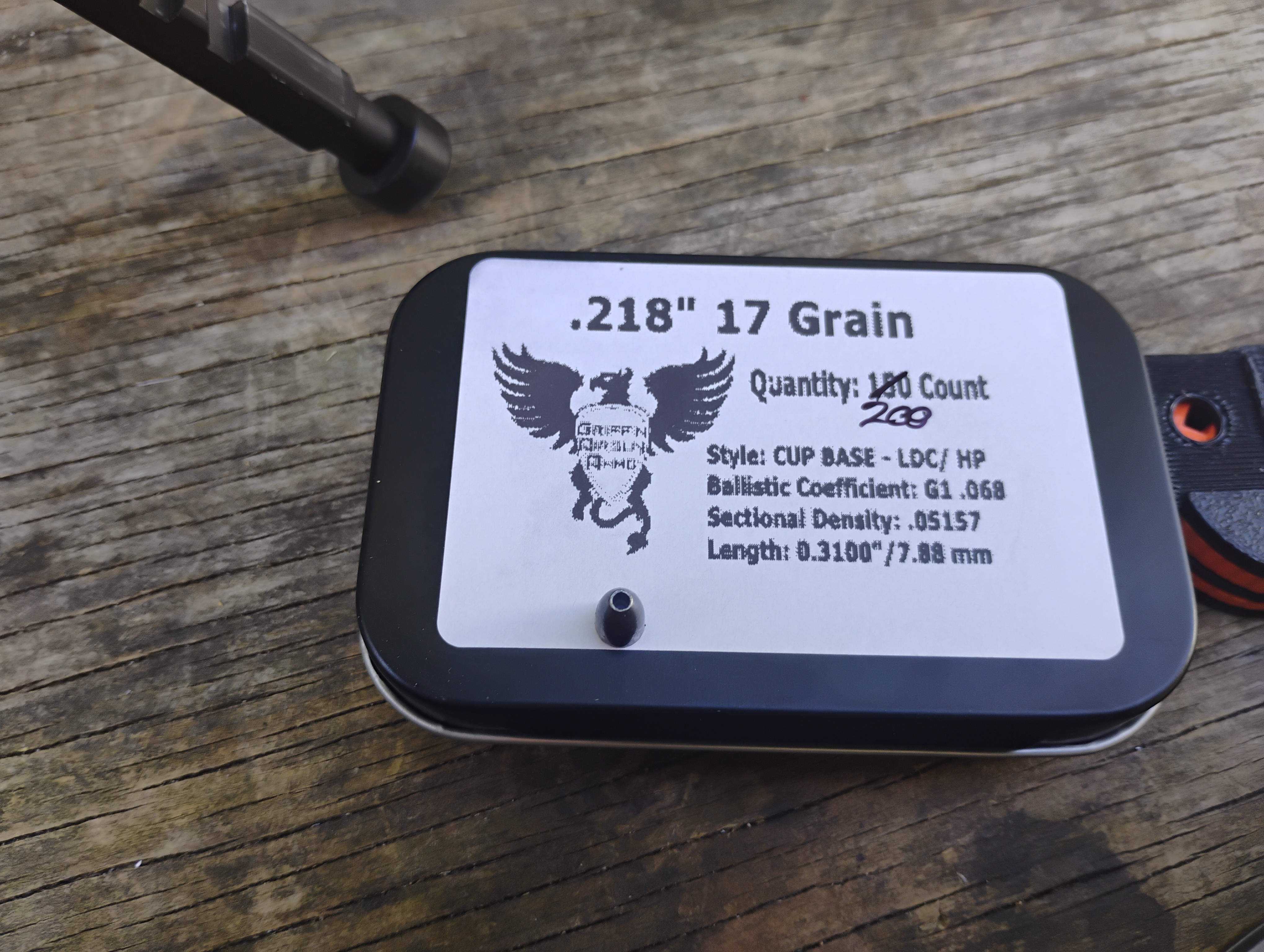

Tried these Griffin LDC .218 17gr slugs today. Whoooaaaaaa.
That's a 10 shot group at 35 yards. Going 800fps.
They're remarkable. The expansion was complete inside-out lead donut. Going to acquaint a squirrel, dove, or Chipzbollah operative with one and see the results on meat. Hopes are high with the results gotten so far.

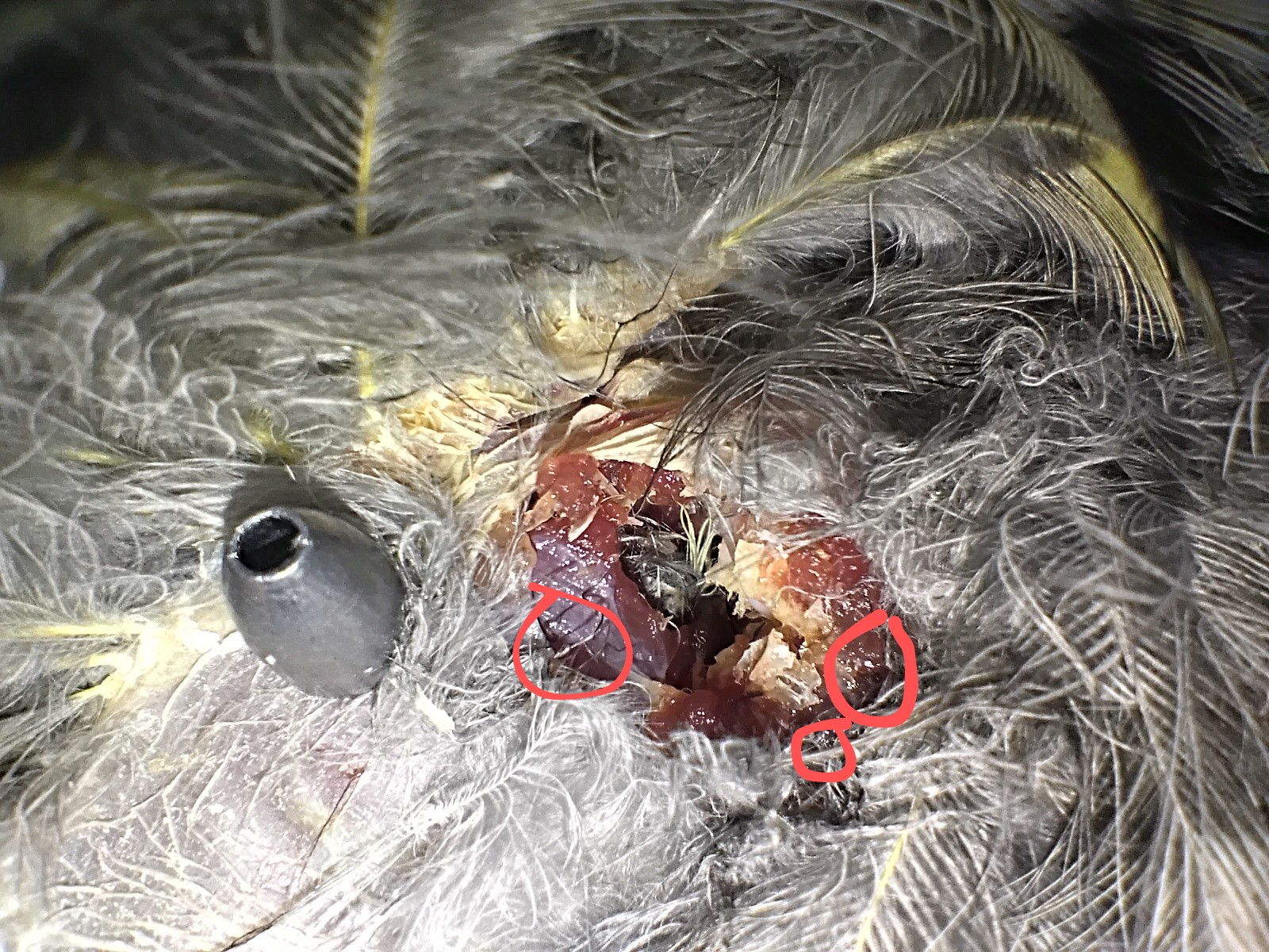

Nailed a dove at 70~.
Top of a large sweet gum, bored from mid gut upward out back just below base of neck. The small red circles are tiny lead fragments. The thing fragmented and did some obvious expansion. The deep "THOOOCK" Was another sign. And the fact it just dropped like a frozen figurine of a bird.
For reference that's a .25 hybrid placed on it

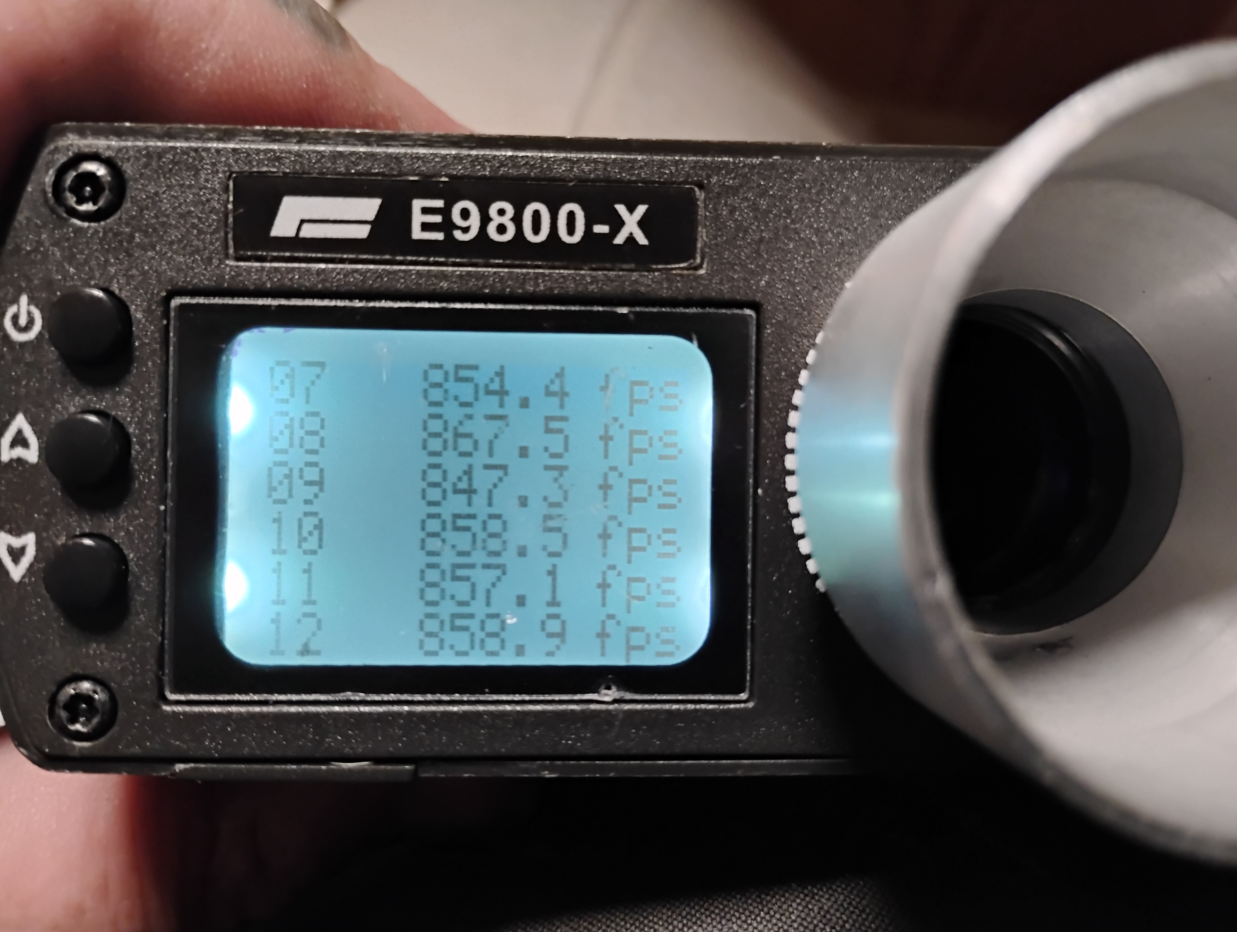

Brother, I get emotionally upset when I'm not shooting .33" groups at 35. These did. These didn't shotgun at all. They held tight and were more than 30fps faster than the half grain heavier NSA .2175 17.5s however, know I've got a superior liner and FX kit on mine. I don't know how they shoot through stock barrel yet. They're more money than the NSA 17.5. They're better. These expand... Bigly. 788-803fps out of my gun. They held tight at 70. The pellet hole is exactly inline elevation and Windage of where I held. I've just ordered 800 more.
Someone suggested the other week to run patches every 60 or so shots with slugs. Or whenever they stop grouping like pellets. This advice has served me very well.
Edit2: from fresh bore they hit exactly where I aimed with a third inch CEP After about 25 shots they tightened up and were going through one hole. I shot 53 slugs. I had zero fliers. I did miss a chipmunk. But it was due to parallax blurring out a twig between him and I.
