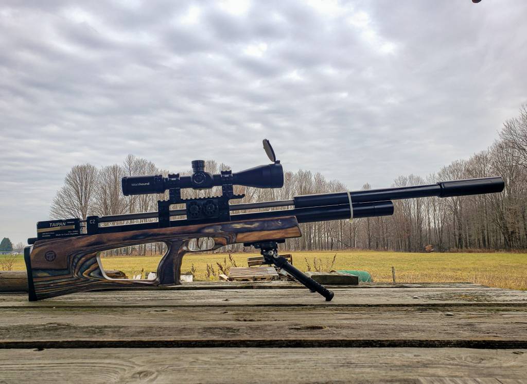

So . . . taking advantage of the day -- I took out my "project" gun and am pretty sure that I'm finally getting close to a tune that I'm relatively happy with. Crappy cell phone picture of it below. Taipan .22 Long, 700mm CZ barrel, Donny Sumo @the front of it. The last time I got to shoot with it was a few weeks ago - the last time we had half decent weather - and I was reasonably happy with the setup @that time --> .216 27.5g NSA's at 974'ish fps. I was hitting my 40 yard zero pretty well ( dime size 5 shot groups ) but knew that I still needed to do some refining on it.
