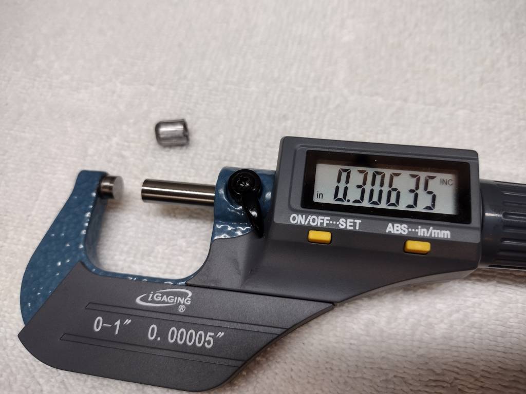

They are defective in being the wrong size. I ordered a .30 not a .30635. The standard .30 airgun ammunition size is .300. I found 1 manufacturer of .3063 slugs and they cost 3X as much as the industry standard .300. Airgun Technology advertised the gun as having a CZ barrel and it does not so the guns were falsely advertised. You do not have to defend wrong doing simply because you're an employee. The following is a quote about the V3 from Airgun Technology on this forum... https://www.airgunnation.com/topic/airgun-technology-vulcan-3/#post-1114082

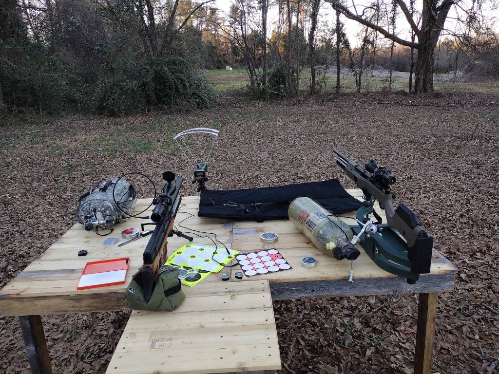

My problem with the .30 cal is that it was promoted as a dedicated slug gun with an unchoked CZ barrel but the barrel is not CZ and it's way over the standard .300 groove diameter, measured .30635
Shoots pellets fast but a lot of air passes the industry standard .300 slugs unless they have a hollow base to act as a pellet skirt to seal better. Mine will have to be rebarreled to be used as I intended when I purchased it. Many would use it as is but the oversize barrel pisses me off.
I like the gun so I'll keep it and fix the things I don't like. I intended to modify this gun from the beginning for more power.
My best slug groups at 100yds. Used all the vertical scope adjustment plus 1.5" hold over and the gun has a 20moa rail. NSA 54.5 at 950 max hammer spring.
View attachment 215204View attachment 215214View attachment 215224
