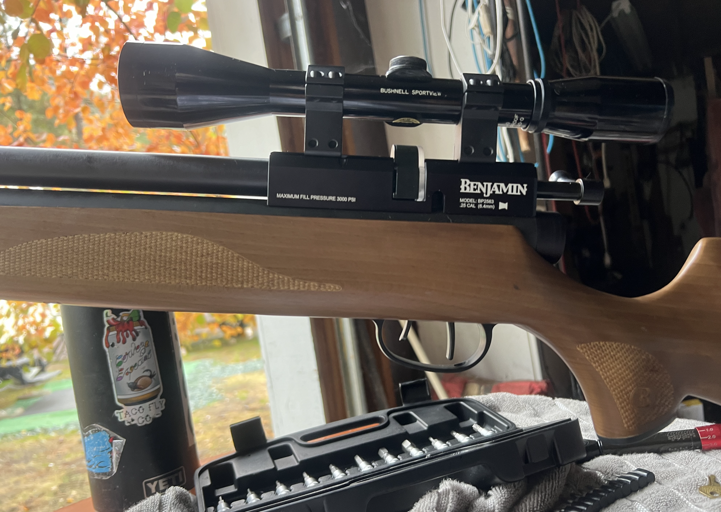

Benjamin My other first PCP - Donated Gen 1 Maruader .25
Went walking around the property looking for a rabbit, quail, or dove...and wow, this rifle is HEAVY. I really want to hike around with this thing but wow...it was heavy. I had it on it my shoulder and was just carrying it. I am going to get a strap for it but I really wouldn't mind finding a lighter stock option for it. Looking online, since this rifle is "older" (not old), no one really makes any for them anymore. Any suggestions out there for a lighter stock configuration? Anyone have old tac conversions they aren't using anymore?
