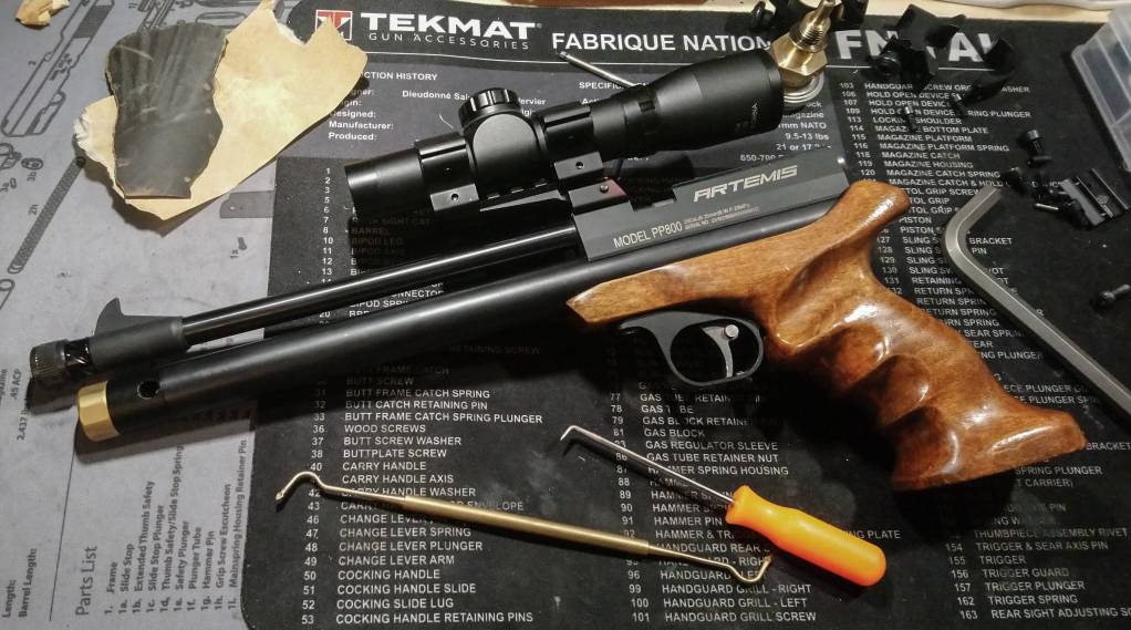

My PP800 Anniversary
I hadn't realized it is a year now.

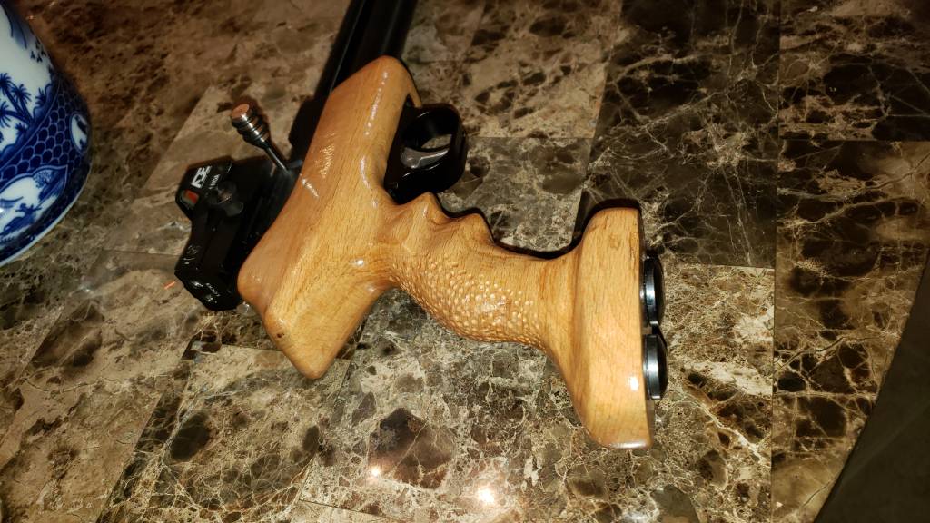

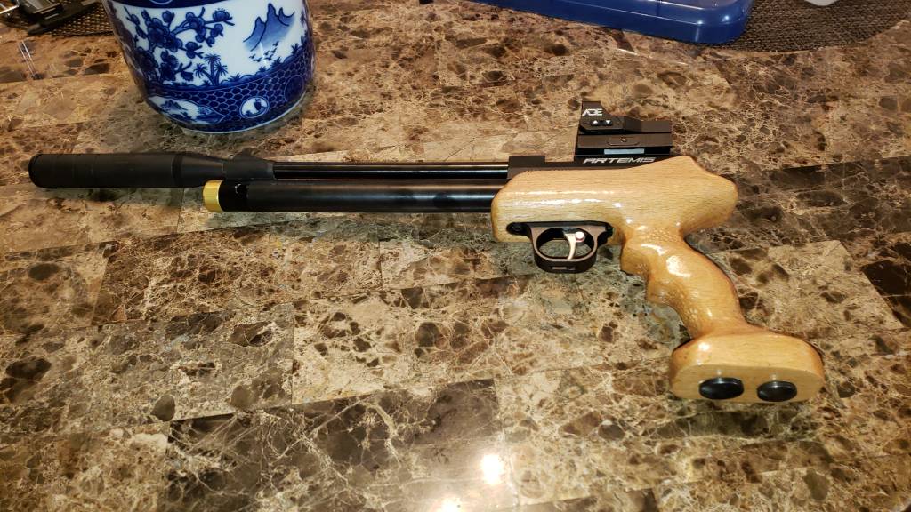

Today I finally finished making the grip fit my hand.. this is my first carving attempt and I know it could look more finished.
However constructive criticism I am willing to learn from. So, a rotary tool grinding and sanding. Hand sanding. Tru-oil.
A .25 with about 5-8 useable shots. (As others have mentioned) Tweaked to 26 fpe. (Guided by your generous sharing of knowledge)
Not the most reliable performance, but I got to compare dissecting a Crosman compared to another brand.

I got mine up to 30fpe, but it is detuned to 28 currently. Wearing the grip I cut down off of my .177 bandit. I have recently got a pp800 wood grip I will cut down as well 😄 Just time and patience.

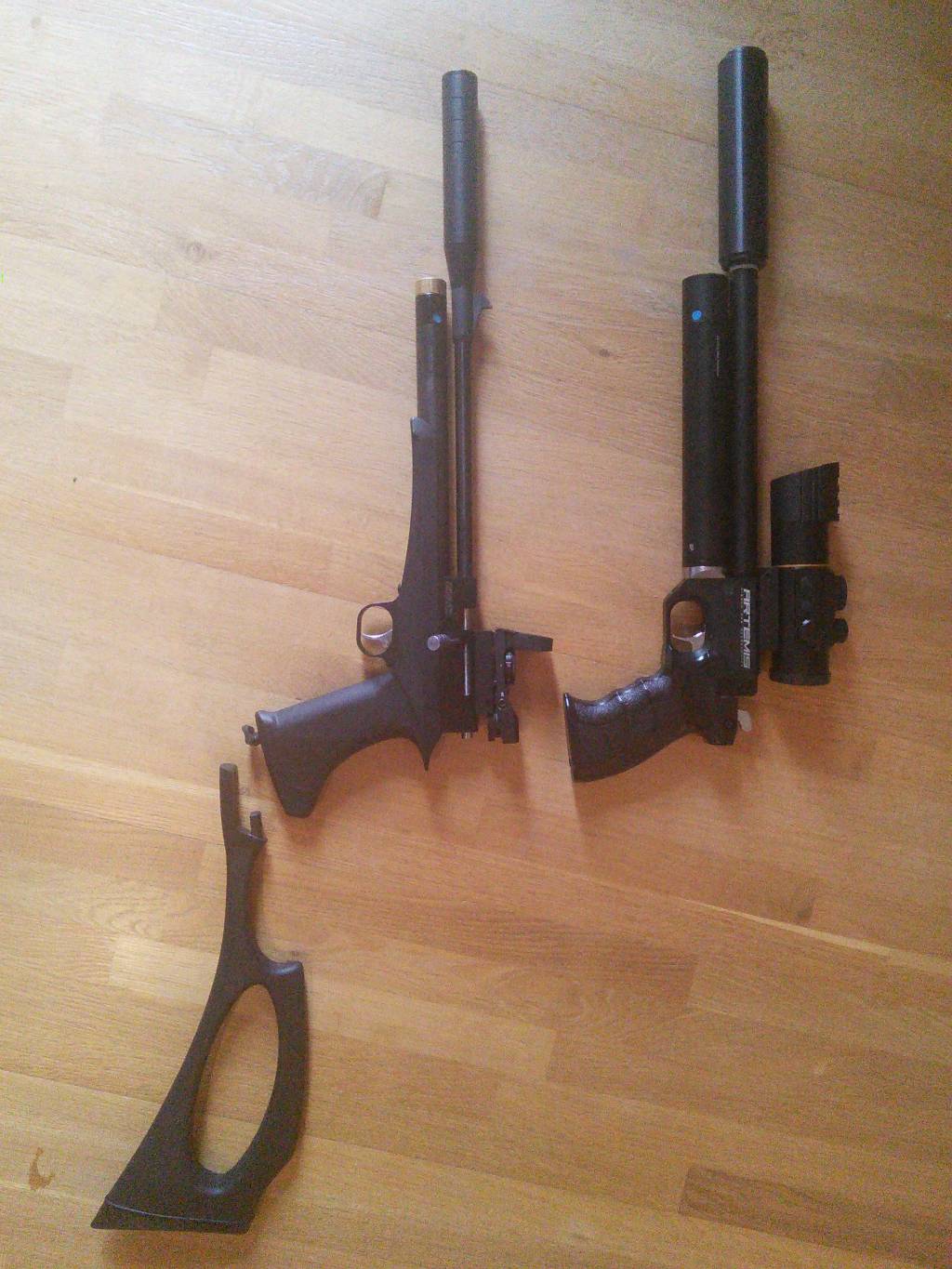

- i got the CO2 package (forgot how it's called) on top for around 100 bucks. Scavenged the synthetic grip with shoulder piece, the longer barrel, the extra magazines, and now have a spare silencer, cocking bolt, etc.

Long_gun the ldc I think was meant for .22. it seemed rather snug, so I widened all the holes. It still muffles a good amount of volume.
I am trying not to put extra $$$ like happened with my 2240/1322. So even tho it needs that reg, I just deal with drastic power drop each fill.
The Benjamin's and FX both do good. However the jsb king heavy mkii would not load without a lot of force. I assume the loading mangled the skirt. So I tried to carefully widen and angle the receiver opening.
Parrotculler it surprised me to know a conversion to co2 was designed. Hunting for it, I am guessing you meant CP2 STOCK since that is what your pic looks like? Or do you mean you bought a complete cp2 gun and used it for parts?
