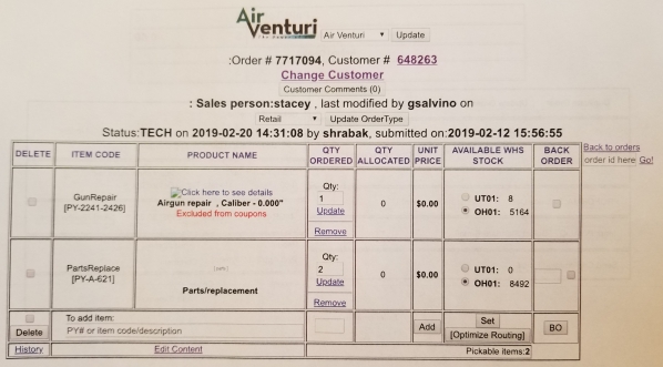

UPDATE 5:
Yesterday, I received an e-mail from Air Venturi.
It contained a few important things. I'm excited and happy about both of them.
1 - A USPS Tracking #. Apparently the PB repair is all set and it's shipping back to me now.
*According to the tracking info: Scheduled delivery is listed for tomorrow [Thrs 02/28/2K19]
2 - This one is regarding the spare parts that I inquired about initially..
*I'm going to hold off on this for now, but, I'll elaborate later! [As soon as the package arrives]
I've learned not to get my hopes up and speak prematurely, but,
IF all goes well, and I understand the e-mail correctly - I'll have a great surprise and great news.
Sam -

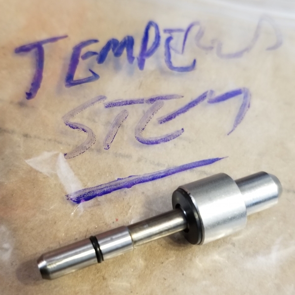

UPDATE 6: [The Final Update]
I am extremely excited and happy to say that Pyramid Air / Air Venturi did an Outstanding job!
[They even 2-day shipped everything back to me - Just like I had shipped things to them]
On top of getting my Puncher Breaker repaired [with upgraded parts] and back in action,
*And this elaborates on "2" mentioned in the previous post...
They threw in an extra upgraded replacement valve-stem For Free!
I had inquired about getting a spare - in case I would ever have to do the repair again - outside of warranty.
When I saw 'quantity 2' and '$0.00' in the e-mail, I assumed it was a mistype, but hoped for the best..
Well, the spare was most definitely included..
PA / AV definitely went above and beyond! Sometimes, it's just the little things that make a Big difference..
Kudos to everyone involved! Very Well Done!

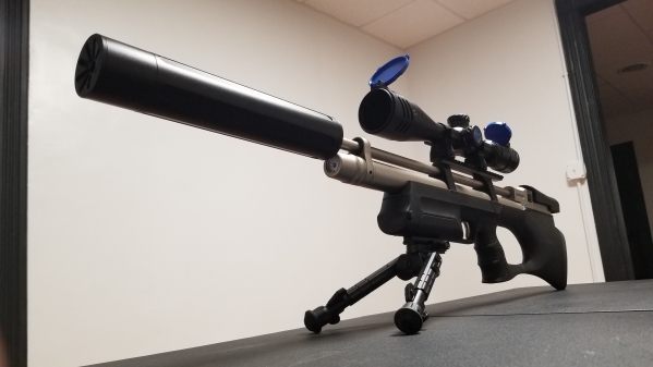

Finally - The Moment Of Truth:
I un-boxed the PB, removed the shroud and installed its suppressor,
then threw on the bipod, scope, and slid in a single-shot-tray..
Ohhh Yeeaah!
Ready For Action!
