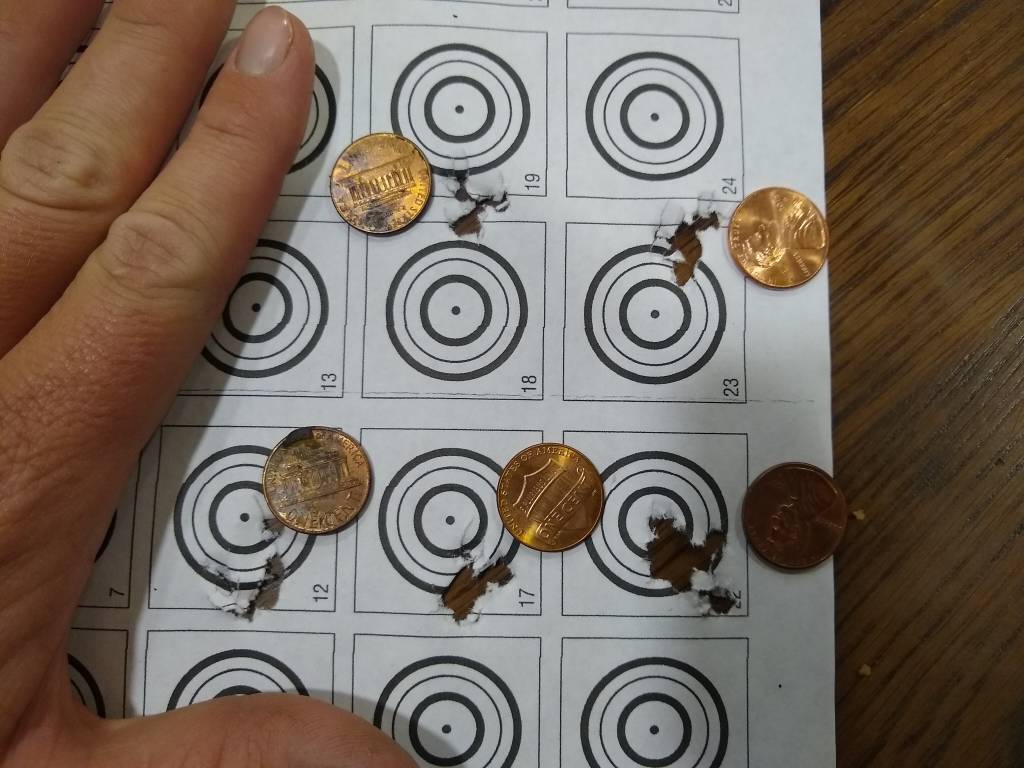

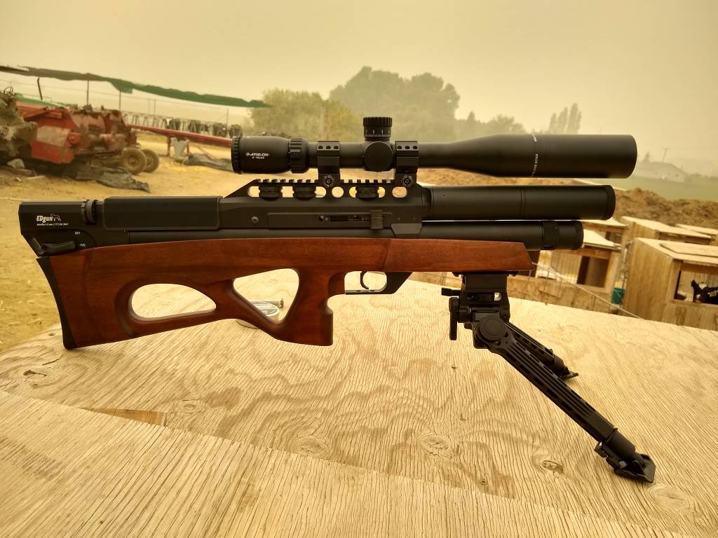

Got my R5M .177 4 days ago and have been shooting it alot! I originally bought it to try and shoot slugs through it. While the NSAs do shoot fairly well from it I decided no more slugs for me. Just wanted consistency in accuracy plain and simple. After a good 350 pellets through the gun I found what works best for this gun. From Brian the gun came with a 125bar reg pressure. Maxed out was pushing the 13.43gr monsters at 970fps. Alittle too hot for what I wanted but wanted to test best accuracy. So dropped fps about every 15fps until about 815fps. Groups shined here with a few fliers here and there. Did well with 10.34gr at this tune also. So dropped my reg to in between 80-85bar. Here's what it'll do now at 50yds with the RD monsters. This is what I was looking for consistent accuracy with no fliers. She's ready to pest now! Setup with an Athlon Midas Tac 4-16x44 and UTG Big Bore Full Stability bipod. This gun can shoot! All groups are 5 shot except bottom right which is 10 shots. All shot consecutively. What I love is at this setting it's so docile and my cross hairs don't move when pulling the trigger love it!
Don't mind the background it's just smoke from all the wildfires.
Thanks guys! Yeah it's quite a good shooter. I was shocked at what it was doing. I've had some good groups with it but most the time had one shot off out of a 5 shot group and I knew it wasn't a pulled shot or anything. But once it started pulling those groups I had to see if those weren't a fluke and I think with 30 consecutive shots like that I feel confident to say that if I miss at 50yds then it was me. And like Mike stated very quiet, very smooth shooting no muzzle flip yet still a nice pop on the birds. Used to think going bigger caliber and faster fps was better for pesting but have since totally reversed that and am enjoying this 20fpe .177 and then will be getting my well missed Leshiy back from @zx10wall the end of the week tuned to 810fps with the .22 Hades and have all my pesting needs covered! If I need more I'll grab my Tikka T1X .22lr lol.
And to others just to clear up these are the Redesigned Monsters 13.43gr and the groups were at 50yds.
Yes, I'm moving in that direction for hunting inside of 100 yards also. Just for s&^%s and giggles, I shot an EBR target at 100 yards. I did that Sunday with my .177 Crown and RD Monsters at 820 FPS in breezy conditions, and only shot one 10 shot target. All inside the 7 ring, 8 of ten inside the 8 ring. Very surprising how well they handled the swirling wind. I have the gun zero'd at 30 yards, so my holdover was between 19 and 20 MOA... ;) It was cool since at that speed with a good scope you can see them dropping in to the target...
