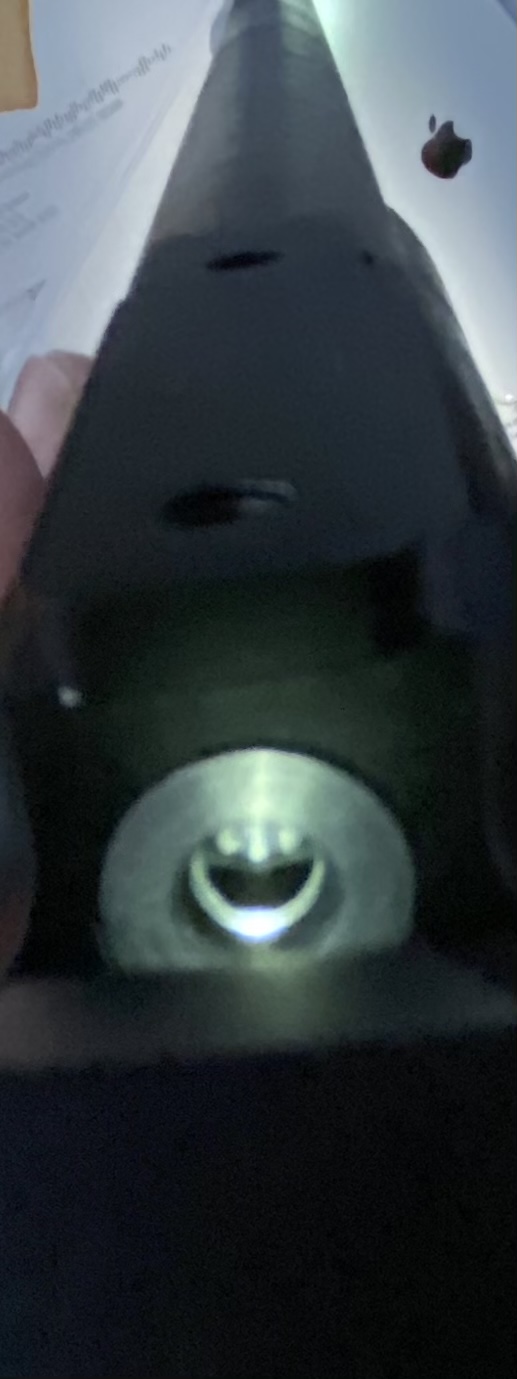

If you can feel the coil discharge when you fire, then check the barrel TP is in the downward position, very easy to rotate the wrong way it after removing the barrel for cleaning.
It’s a fuzzy picture but I can see the transfer port opening when I shine a light down my barrel.

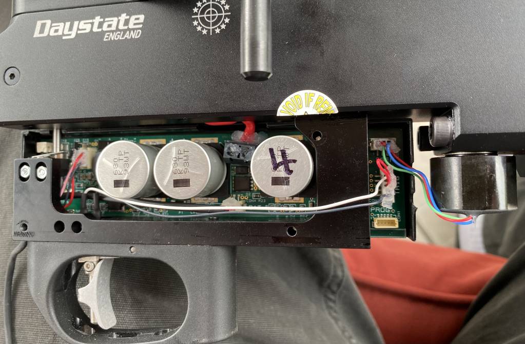

I did take it out of the stock to inspect the connectors inside. I repair computers so I’m fairly comfortable with electronics.

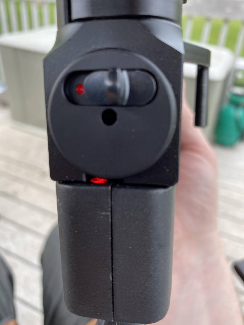

I can see that the pin pushes down on the connector every time the safety switch is flipped and also when the bolt is open. There’s also a blinking red light at the back of the action that goes solid red when the rifle is ready to fire.
I don’t see any loose connections but it’s hard to tell because there is a grease compound on all the connection points.

The screen is not dimming when I hear the internal click when I try and fire but the shot counter is going up so the gun seems to think it is shooting.
Can you safely measure the solenoid voltage when the trigger is pulled? The board sources quite a bit of current, so extreme care is required. Also, I have forgotten to tighten the solenoid wire screws on one occasion on mine. Sounded similar to what you're experiencing. You might check those while you're in there. Make sure the wires are actually in the connector , also.
The hammer might actually be jammed. Not sure what would be in there to do it, but I'm struggling to see anything else with all that you've checked.

I sent some videos of what was happening and pictures of the board to Shane @ AoA and he spoke with a tech and they’d like me to send it in. The rifle will be on it’s way back to Arizona this afternoon.
