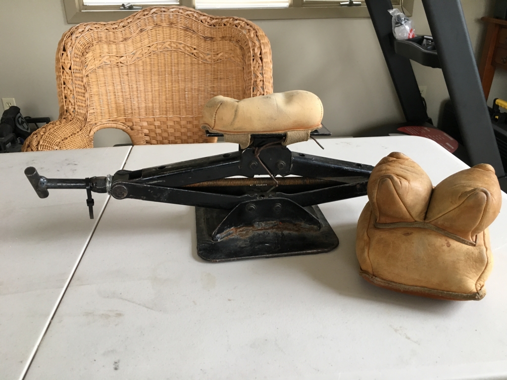

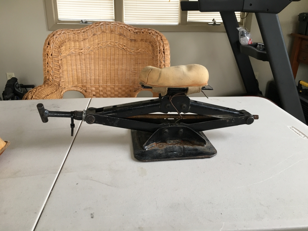

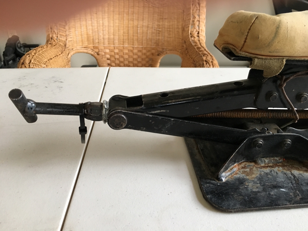

I’ve noticed a lot of fellows shoot off of bags. I have a bag and do use it on occasion but I’ve found a cheap and more adjustable arrangement that I have used for years. It’s almost infinitely adjustable and very quick. What it consists of is a scissors car jack with a plate welded to the bottom (rubber pad under that plate not visible) and a small plate on top with a sand bag. Also a handle which is used to adjust. I use it for almost all of my shooting . You can use it with or without the rear bag. Sitting on a table or the roof of a car using the rear bag you will find you have about as rock solid of a rest as you will find What do ya think?

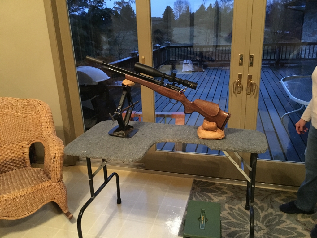

This has always worked better for me then either a bag or a bipod. It’s faster to adjust and can be adjusted in smaller increments. Not my original iidea. Friend used one first time I went prairie dog hunting with him . Perfect for that application. I can put it on a table and adjust it way up to shoot pigeons off a silo or level it off to shoot straight down range to sight in a rifle.

After I saw my buddies I just bought a used scissors jack at a junk yard. Took that to a weld shop and told them what I wanted. The bottom plate is about 7 or 8 inches square and the top plate about 2 by 5.

It really is one of the slickest shooting gadgets I’ve come across. And again it’s advantages over anything else I’ve used are it’s range of adjustment speed of set up and stability. It’s also relatively light and portable and certainly cheap. I’ve used bags of all types and bipods and FOR ME this works so much better.

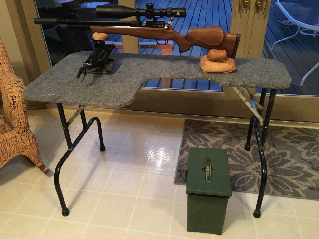

I hunt groundhogs at longer ranges. I set up a folding table which I might post a picture of ( I hate laying prone and trying to shoot off a bipod). If I spot a hog I’ve alresdy got the gun resting on the front rest shown and on a rabbit ear bag. I can grab the handle of that jack rest and pull the gun right and left on the table look thru the scope and correct for elevation In literally ten to fifteen seconds. I then jam the rear bag under the rifle and line up the shot . This also allows me to pretty often spot my shot thru the scope which I find absolutely invaluable. Bags are fine for target work because you have all the time needed. I plain can’t use bipods . If your completely happy with a bipod this probably does you no good. I just found a bipod was always either too high or too low and never as stable as I thought they should be.

Here is my set up. Table is made using banquet folding legs. (Amazon). 1/2 inch plywood covered with outdoor carpet. Seat ? I use a couple whatever I need to carry my stuff. Two pictures showing the Daystate hunter regal elevated for pigeons. I also have a three legged table with transet legs which works well . It’s a little harder to set up over the table shown
